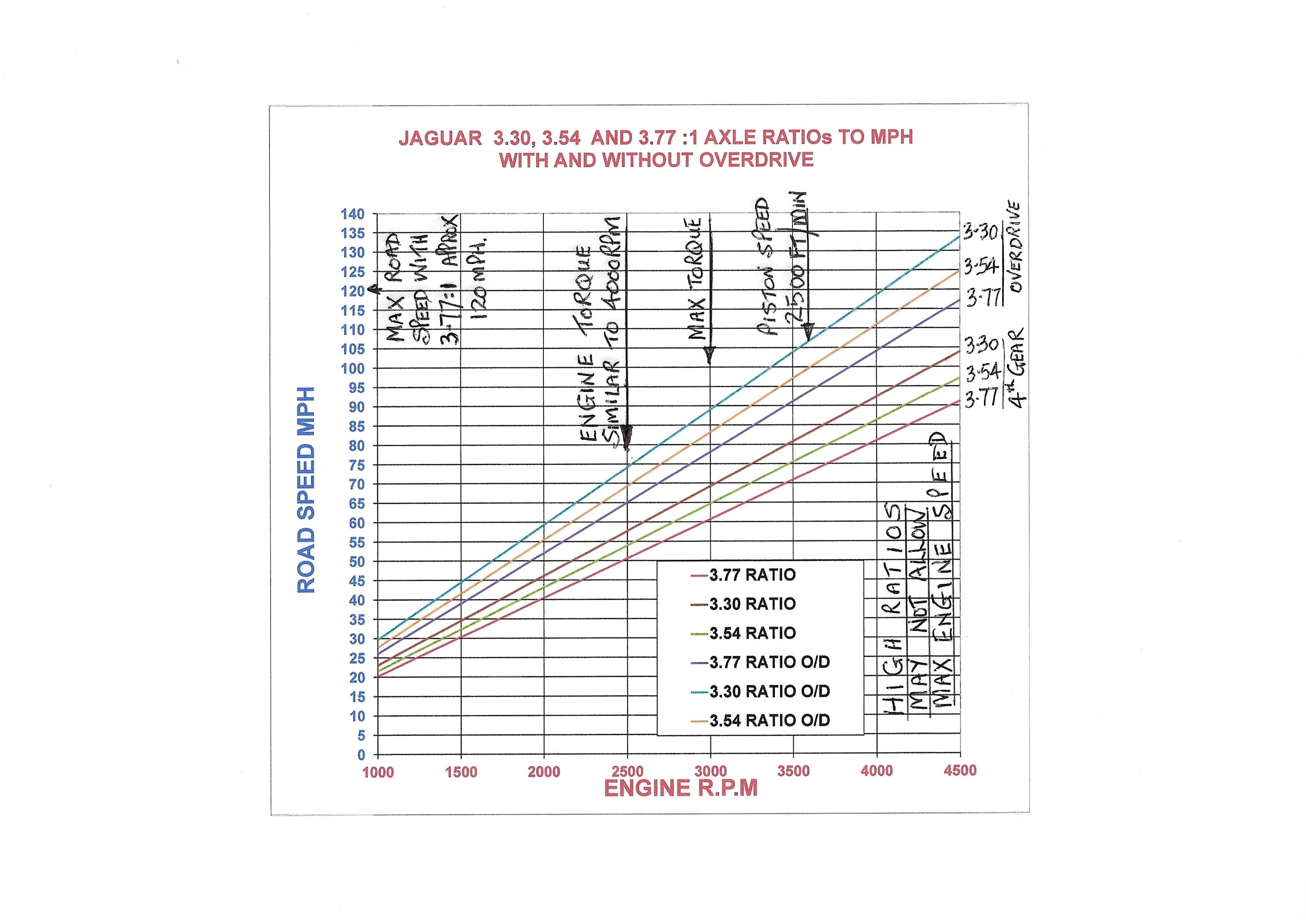

Hopefully I will be able to attach here a chart showing all the other details you requested, I trust it may be helpful. Based on 82% series Michelin tyres at 785 rev per mile.
You might notice that the UK national speed limit is 70 mph and that speed in 4th gear drops right on the engine maximum torque at 3000 rpm with the 3.31:1 axle. Running at 70 mph in overdrive leaves the engine turning nicely near the bottom end of the useful torque band (2500-4000rpm) whilst disengaging overdrive places it exactly on maximum torque at 3000rpm.It is also within my self-imposed engine piston speed limit of 2500 ft per minute at 3594 rpm.
Jaguar axle full details.jpg (774.21 KiB) Viewed 1980 times
