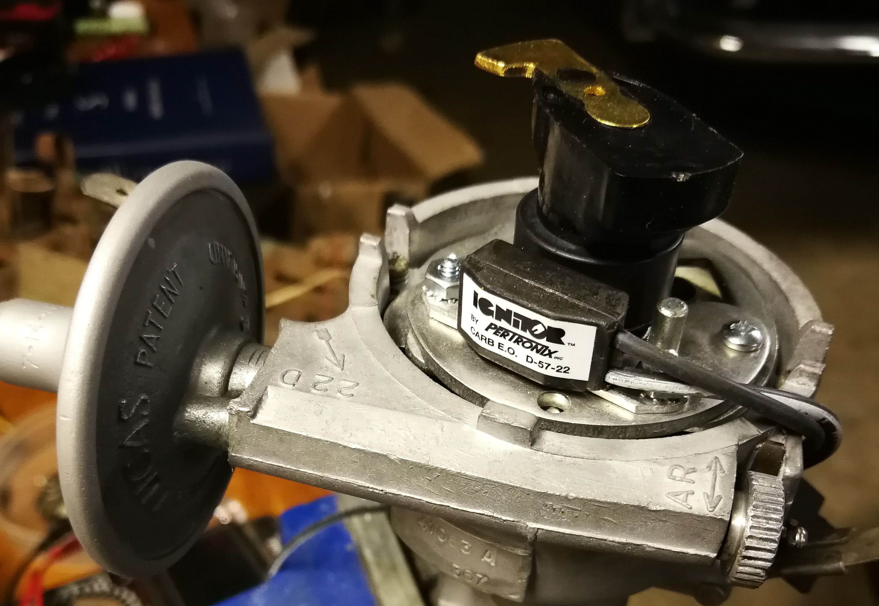

I am using a PerTronix Ignitor LU-166AP12 Lucas 6 cyl 12 Volt Positive Ground/Earth system with their 40,000 volt 3 ohm Flamethrower coil as suggested and all is running beautifully.
