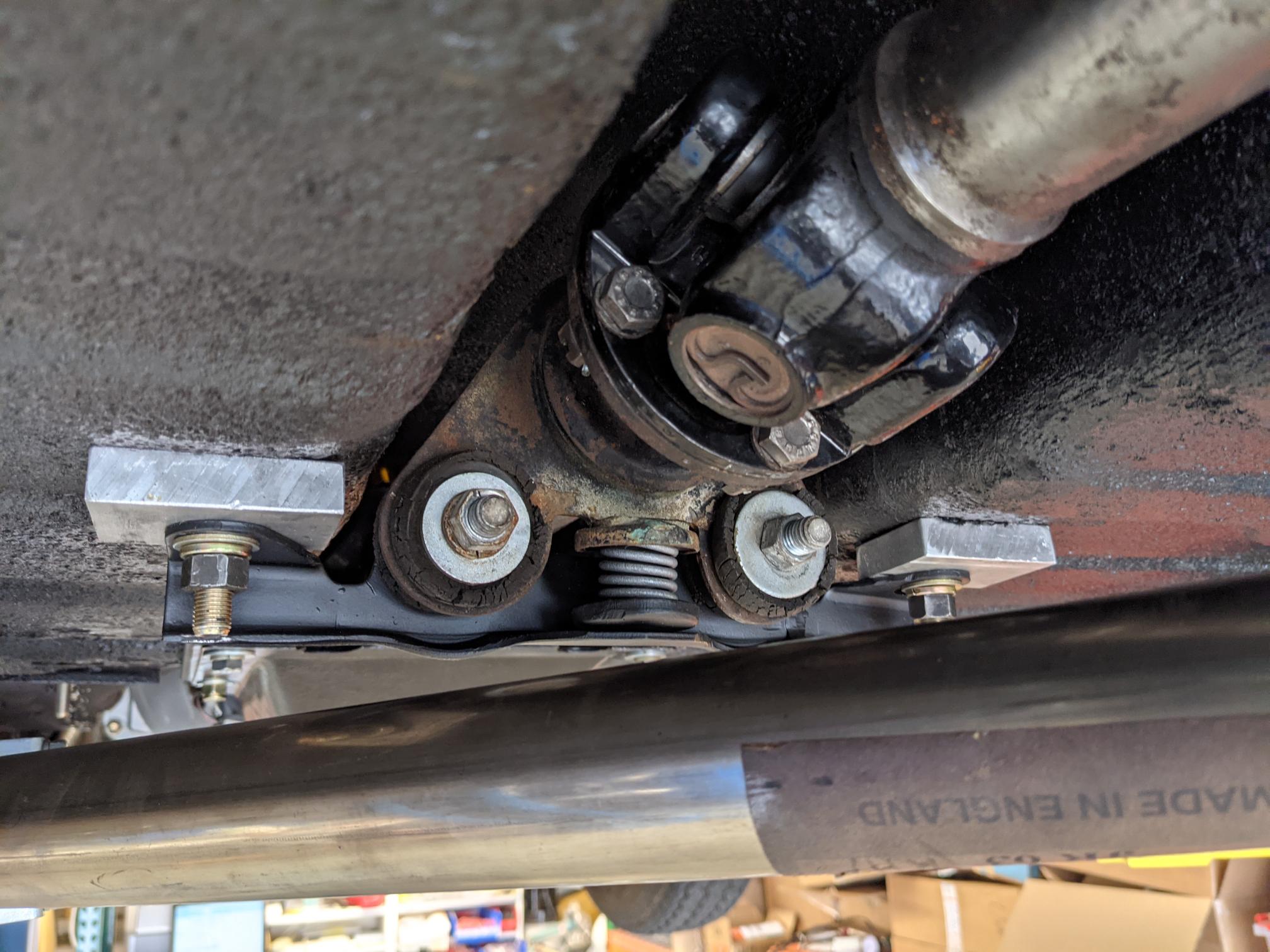

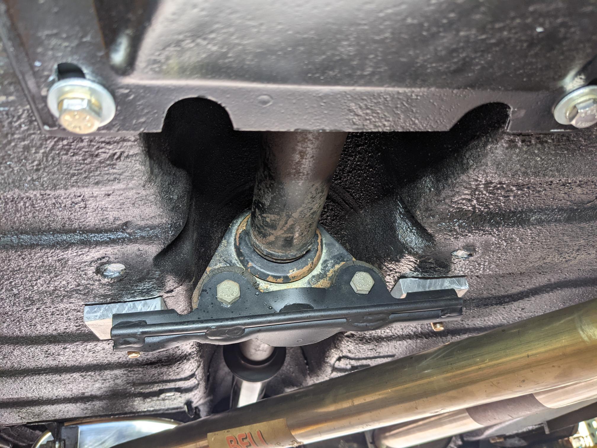

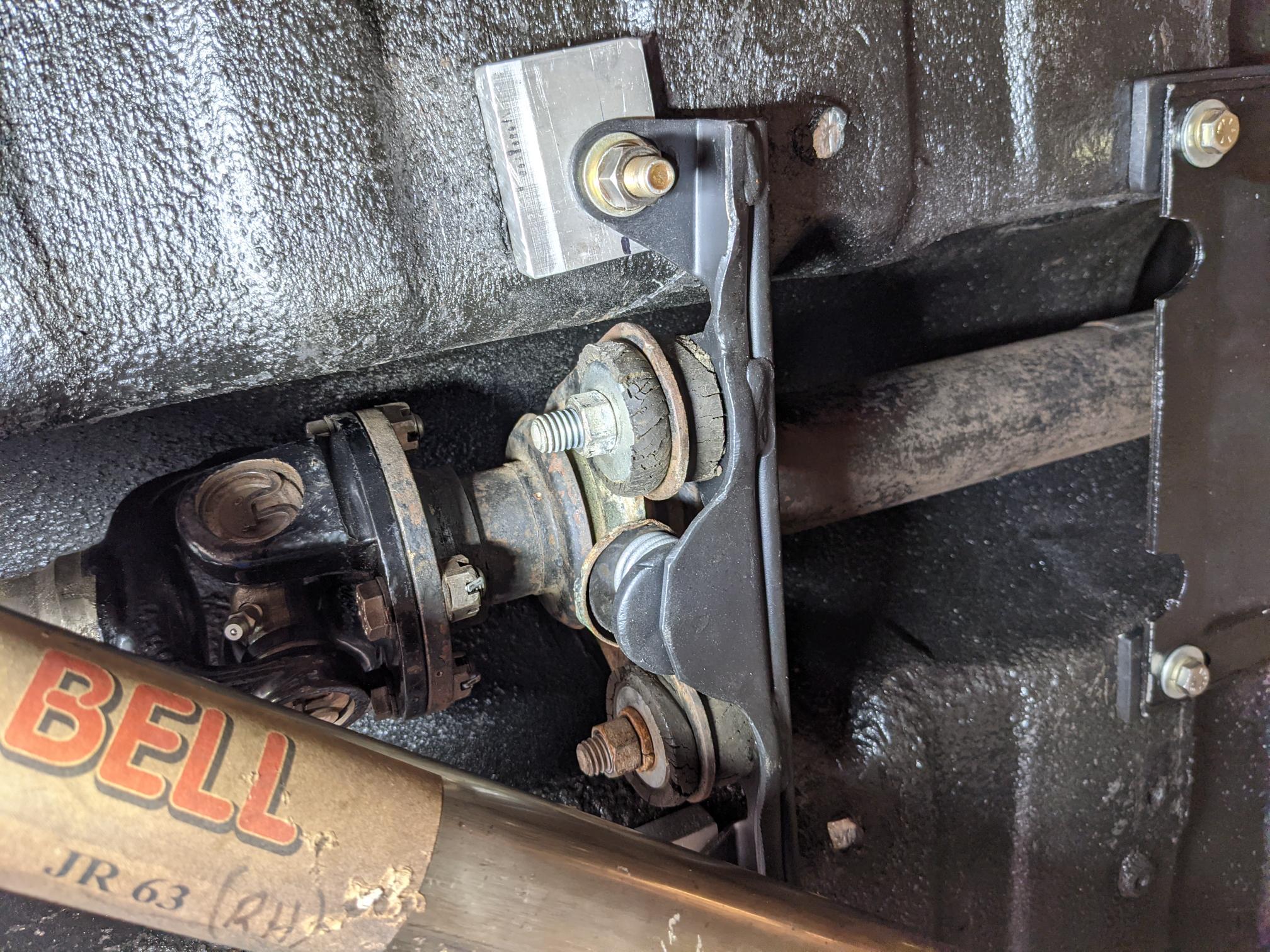

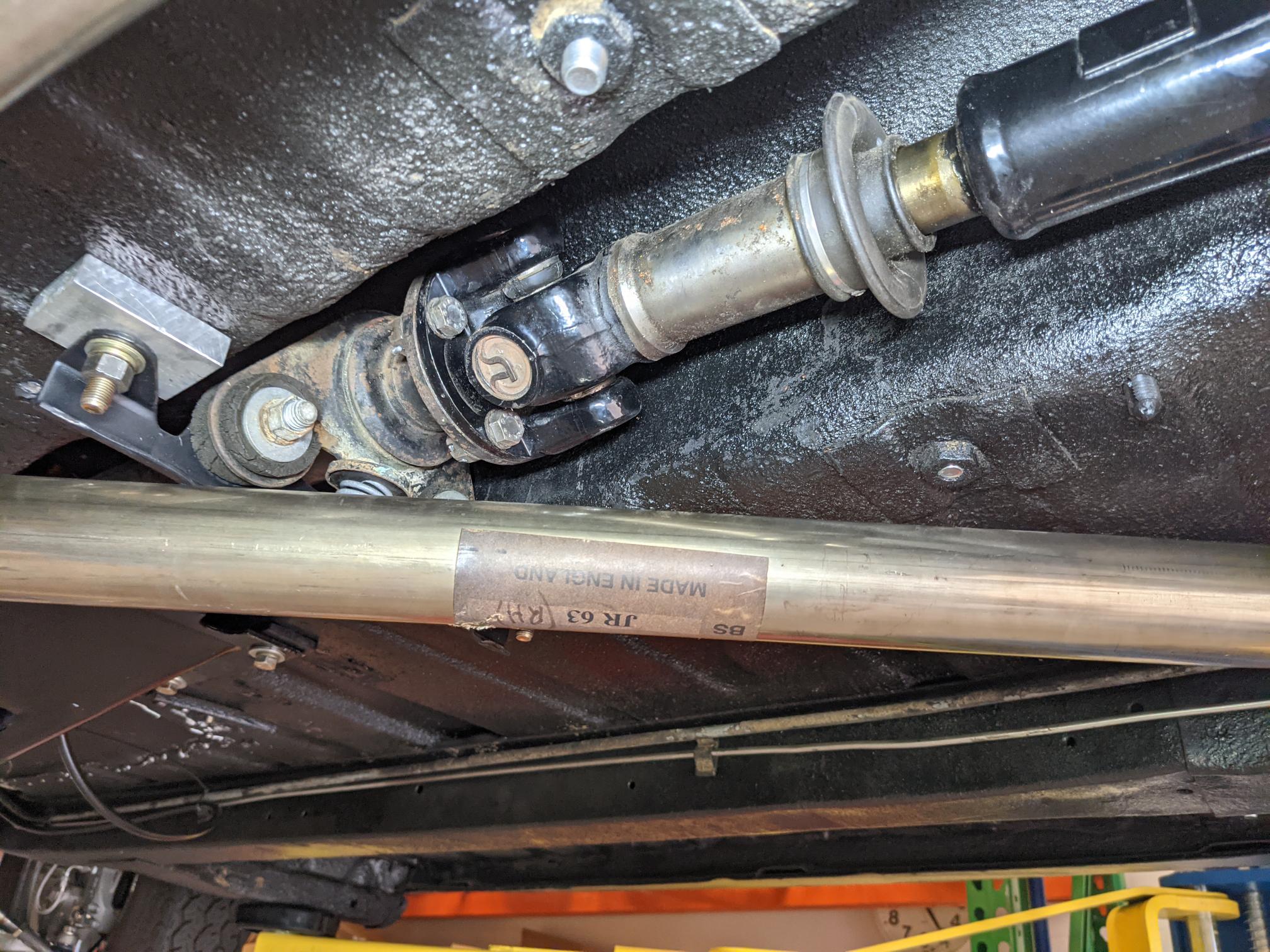

I believe my car left the factory as an MOD model but by the time of my purchase 10+ years ago a BW Autobox had been installed by the PPO. I then sourced a rebuilt 4 speed OD box which I believe to be of the correct type for this car and fitted it as part of a complete mechanical overhaul. The auto propshaft and gbox mount no longer fit this setup so I sourced a horseshoe type mount which again, I believe to be correct for this year model and seems to fit OK. Although I am not sure if I have the correct spring fitted? For the propshaft, I found 2 sections in the spares pile that combined to fit the car. There is a 34.75" long rear section with U-J's at both ends and a slip yoke with gaiter. The front section is 17.5" long with a UJ on the gbox end and incorporates a center mount with bearing and rubber isolators which looks like it may have been a factory piece but was then modified/strengthened with a piece of welded rod. I have mounted it temporarily using a couple of alu spacers to what seems a reasonable height/alignment. It drives OK but I am getting a slight vibration pulling away which may well be those perished bushings I am guessing.
Does anyone recognize this center mount or know which model it may be from? All the Jag manuals & parts books I have only show varying length single propshaft setups for the S Type, length dependent on having auto, manual or MOD boxes fitted. Its obviously in dire need of some new bushings and ideally a new center bearing but no idea what it is from to order those parts? Also do those 2 lengths (34.75+17.5 = 52.25) add up to what a standard S Type MOD propshaft should measure? Does anyone else have 2 piece prop setup like this or do I have the wrong gearbox maybe??
Any help in resolving what is the final hurdle to getting this one back on the road for the first time since 1984 I think is greatly appreciated.

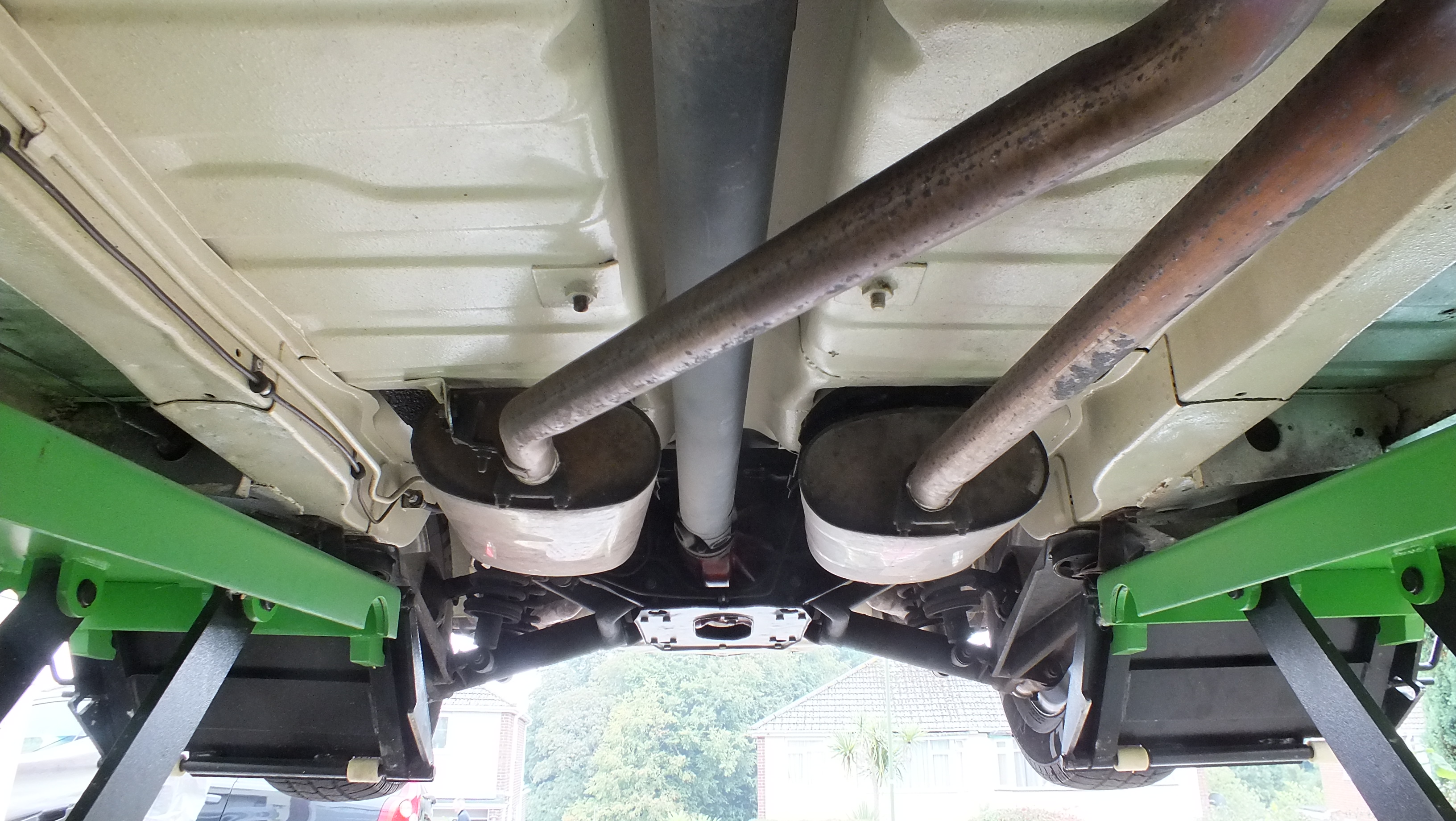

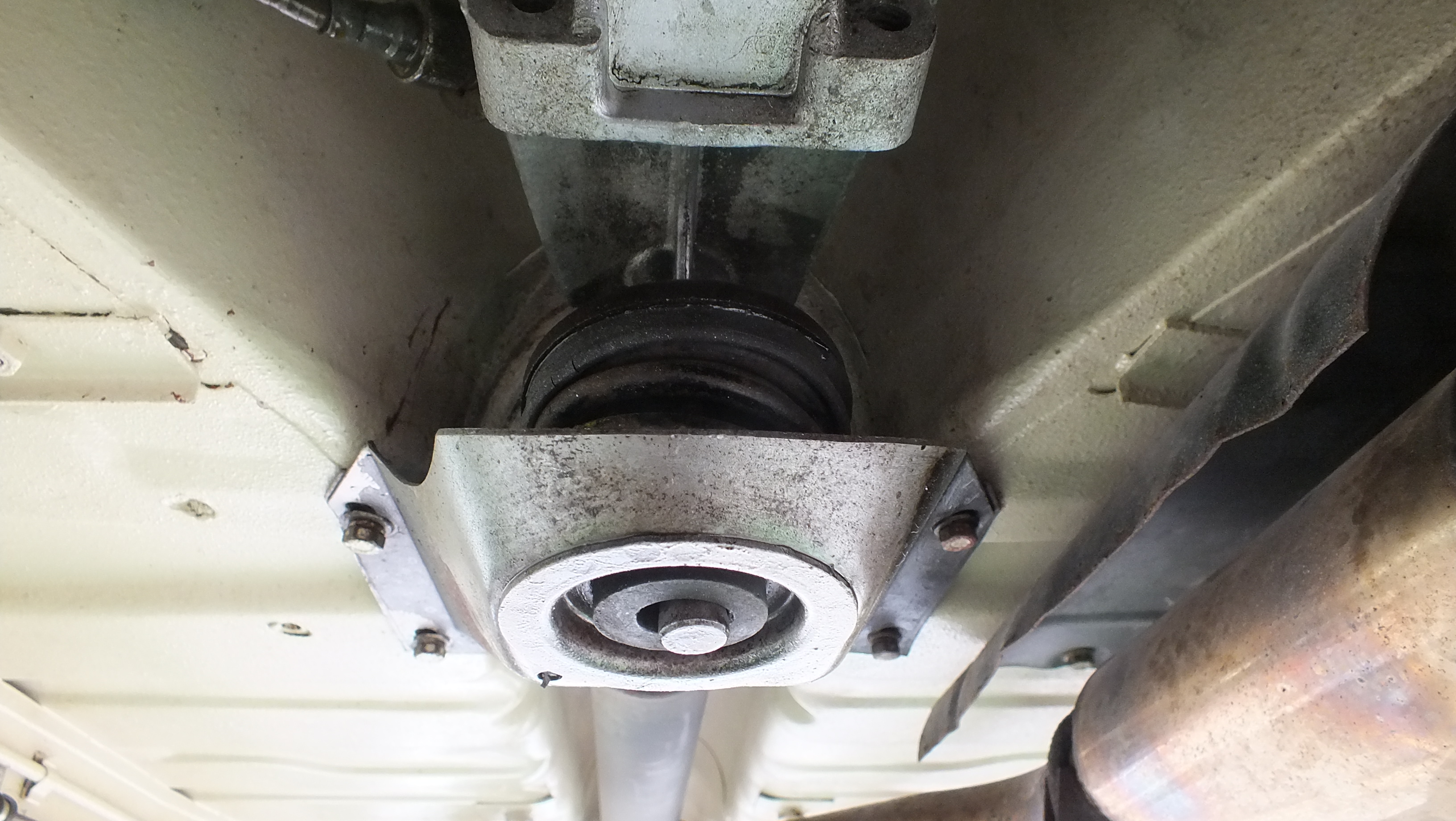

Nicely put together to get it working but as far as I know and I only have the BW35 to compare it with the S Type only had a one piece propshaft. Whilst doing some work a couple of weeks ago I changed my U/Js on the prop shaft and had some issues. In my garage I happen to have a spare prop shaft and pulled this out but determined that it was from a DG 250 or possibly a manual car as it was longer by a couple of inches and thicker in diameter. It is 54 inches long and 3 1/2 inches in diameter. Yours combined is 52 1/4 long so it would seem you need the same prop shaft length that I have on my car which is a one piece system.
Below is a composite photo of my propshaft in situ but I emphasis this is a BW35 gear box car and might be different to a DG250 or Manual set up.

thank you for the pics and explanation. So, it would seem my car has some kind of non factory 2 piece propshaft arrangement. I need to decide now whether to make up some replacement bushings for the center mount and stick with this setup, hoping it will cure the small vibration or source a one piece replacement. My preference would be a one piece I think, simply less parts to wrong in the long run.

Thank you John. I have used Jaguar Heaven in the past for a few E Type & S type bits but for this one I bit the bullet and took the car down to a local outfit called Drivetrain Specialties and had them build one. 24 hours and $650 later I had a new propshaft with Spicer joints which solved the vibration problem completely thank goodness. I am still looking for the metal / mesh cover that goes over the heater controls on the front parcel shelf if you know anyone who has one they would be willing to part with? I have tried JH on that one a while ago but no luck.
