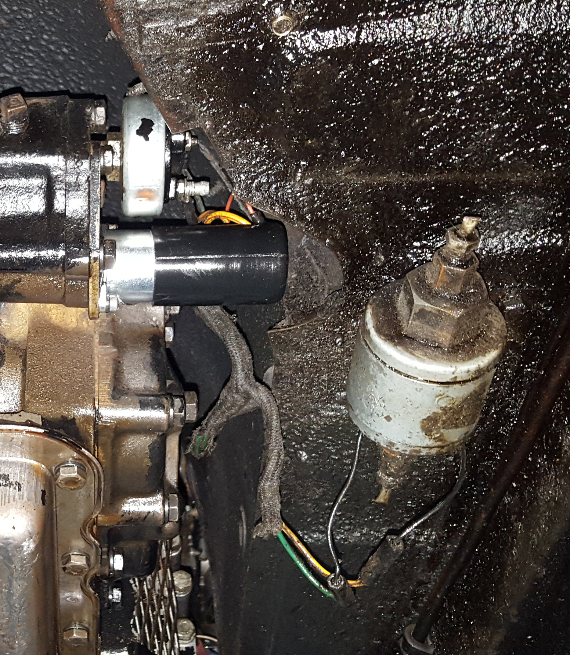

That OD looking solenoid is standard on the DG. As said above the intermediate speed hold.

Yes, it is the intermediate speed hold for the DG automatic gearbox. Biggest issue I have heard of with these is leakage. There is an bellows inside that protects the solenoid from transmission fluid and this can perish. The good news is, this one looks pretty leak free from the picture.

NigelW wrote: Sun Aug 01, 2021 2:03 pm Looking at the wiring diagram on this site the yellow/purple and green go to the anti creap switch and the yellow /red goes to the solenoid. Unfortunately I can't verify this on my car as I put the DG box in the skip decade's ago.
has anyone got a photo of this area ,or can get me one so i know where they all go ????
Re: gear changing early
Here's a pic of the underside of mine. Not sure how useful it will be. My anti-creep solenoid is hydraulically disconnected - somewhat crudely I admit. Apparently they were fitted because drivers were not used to cars moving without them touching any pedals! How quaint!

Orlando St.R wrote: Thu Aug 05, 2021 3:39 pm Here's a pic of the underside of mine. Not sure how useful it will be. My anti-creep solenoid is hydraulically disconnected - somewhat crudely I admit. Apparently they were fitted because drivers were not used to cars moving without them touching any pedals! How quaint!
many thanks for the photo and from what i can tell its (from top downwards) green then fat yellow red on the one unit and then thin yellow red on the longer unit on its own..
i don't surpose you could check and confirm for me (pretty please)
