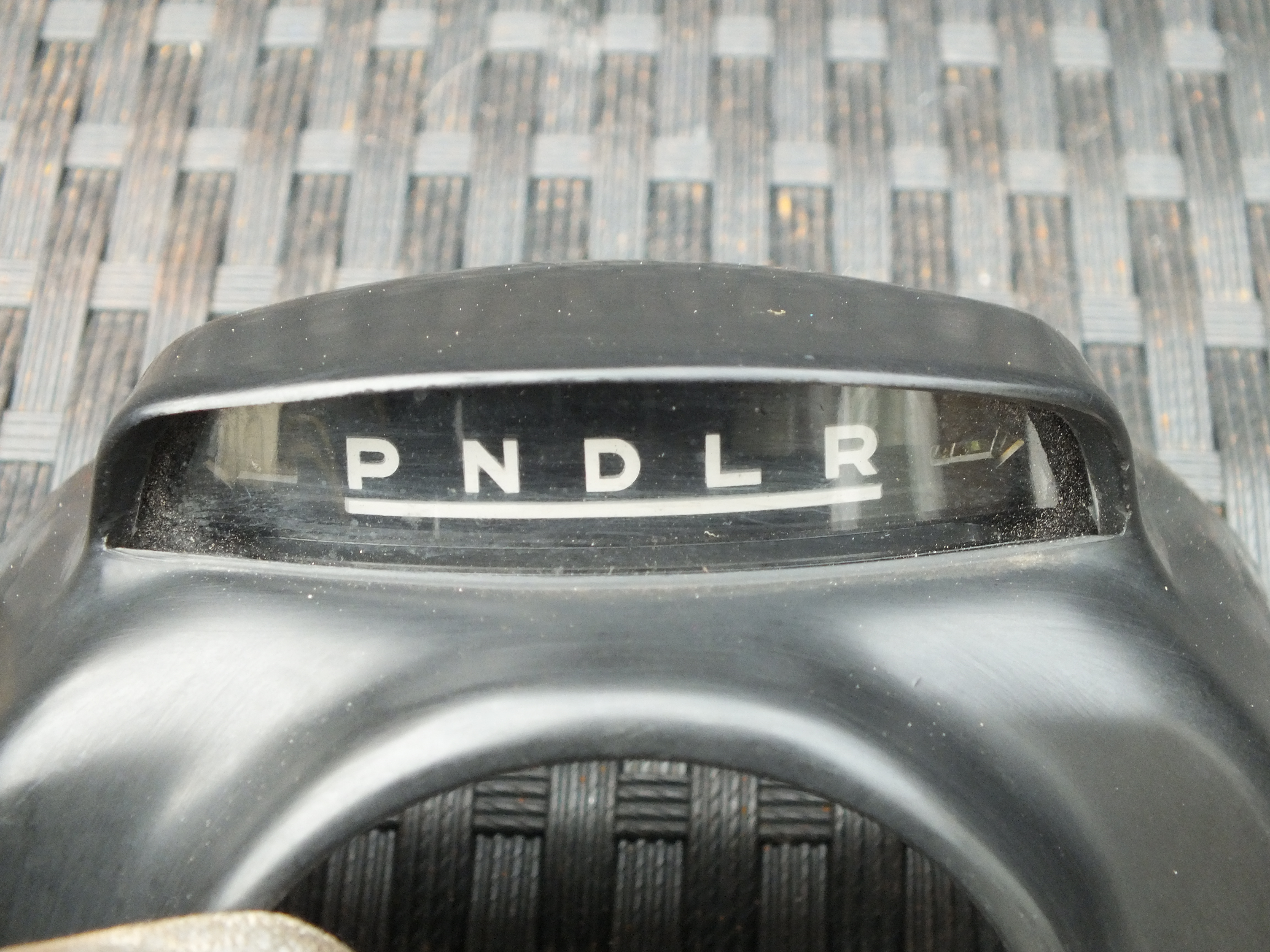

One of the main differences between the DG250 and the BW35 is that the DG250 had a cast iron body where as the BW35 was aluminium. Even without a ramp you should be able to check that out.

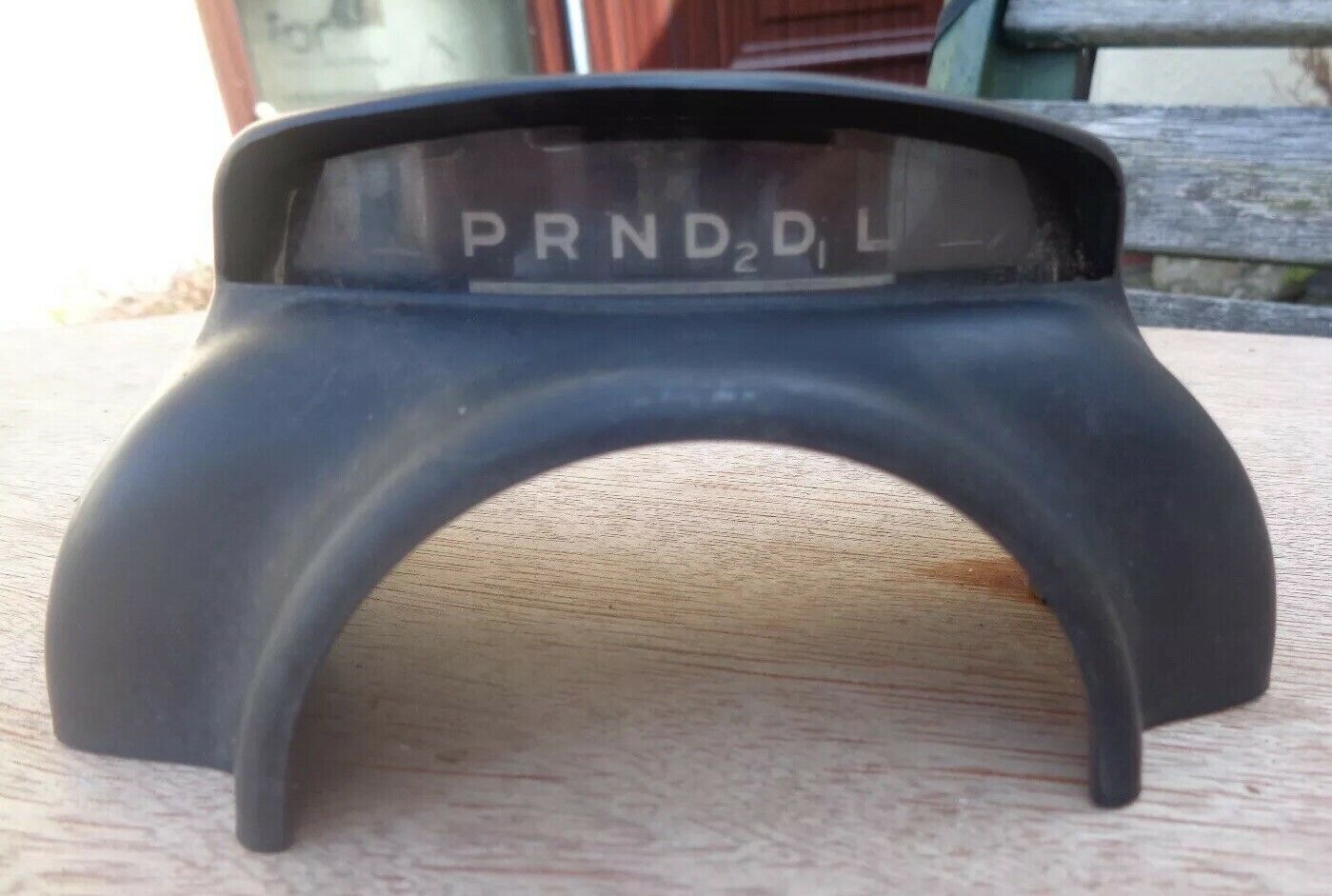

As for the read out on the gear selector Nacelle I am sure I have seen some DG250 cars with P.R.N.D1.D2.L as per the attached photo which is the same order as the BW35 P.R.N.D.2.1. I am sure someone with a DG250 and this setup can confirm or deny this.
Perhaps there were two configurations of the DG250 box and yours has been exchanged from an early box to a later box which is why the display does not correspond to the gears you are selecting. Just speculating here and I am sure Glyn has more details even though his car is a manual.
This a Nacelle I have got as a spare and must be what you have on your display but it not a BW35 display.

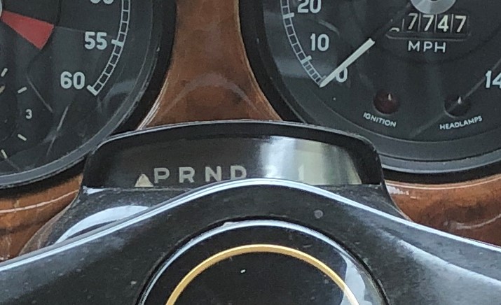

This is the display in my BW35 car.
IMG_7420 (2).JPG (111.09 KiB) Viewed 4013 times
