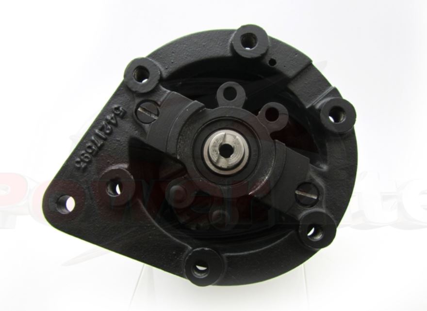

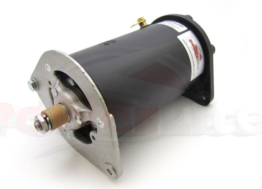

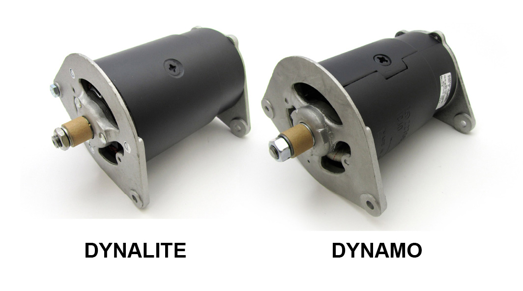

Sometimes because the pickup for the PAS System which comes off the back of the old generator when it is converted to an alternator the PAS is removed and a standard steering box fitted. Trying to get a drive for the PAS pump off an alternator up until fairly recently was a challenge but now several firms are selling a C42 generator housing with the insides converted to an alternator which has the original pick up for the PAS on the back.

Dynalite example:
Original with PS pump attached:

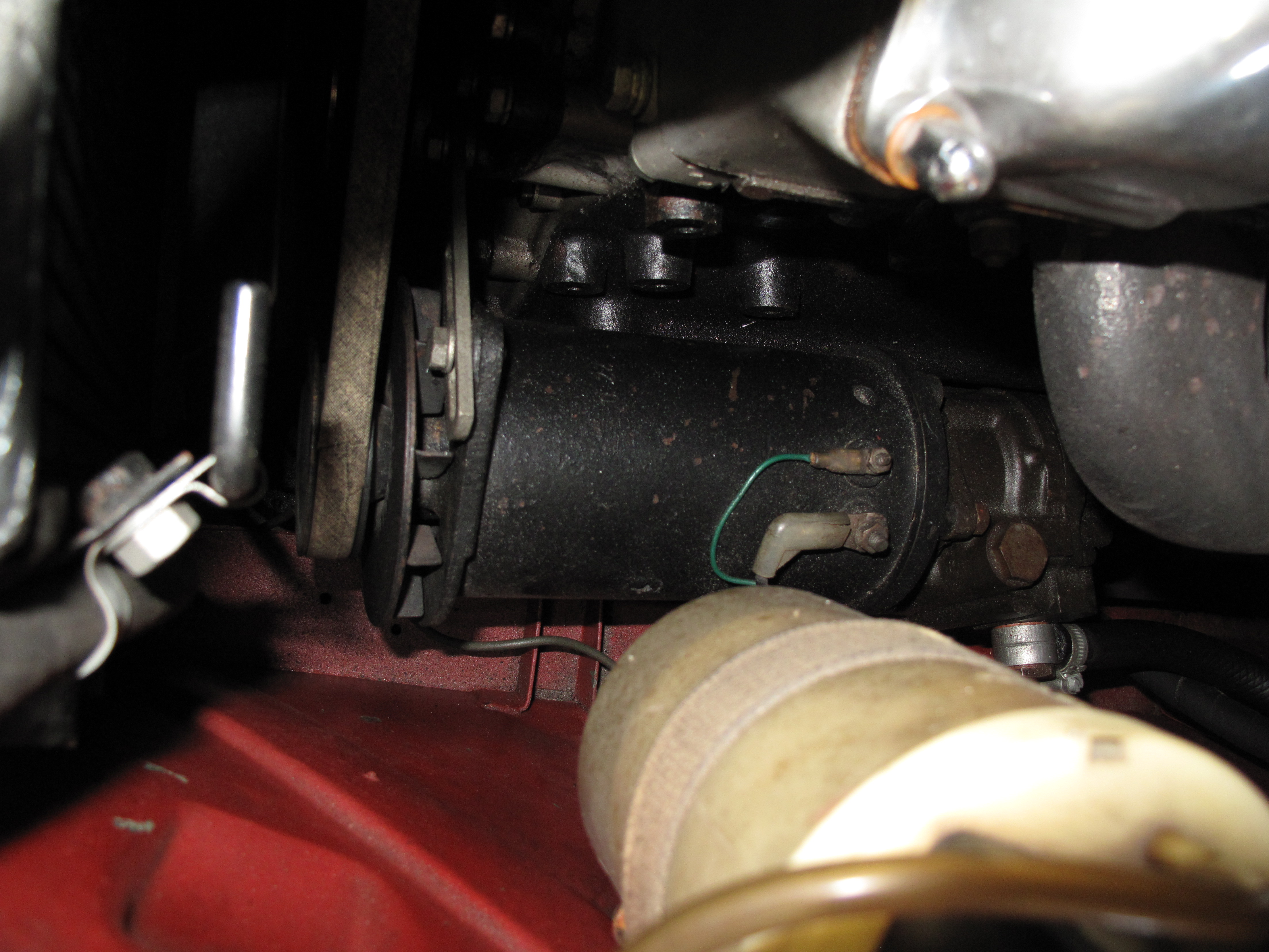

Thanks for the PS/Generator information. I checked my PS box and it is not set up for PS. I compared it to my RH parts car and your pictures its not close. I would post pictures of the generator and other stuff, but system boots me out when I try to post with attachments or picture, and the icons for this are not functioning. Received my Heritage Cert. I have a numbers matching car. Original color was Opalescent Golden Sand with Tan interior. I'll figure out how to post pictures later. Good news is I have a matching numbers car including the motor cyl head.
