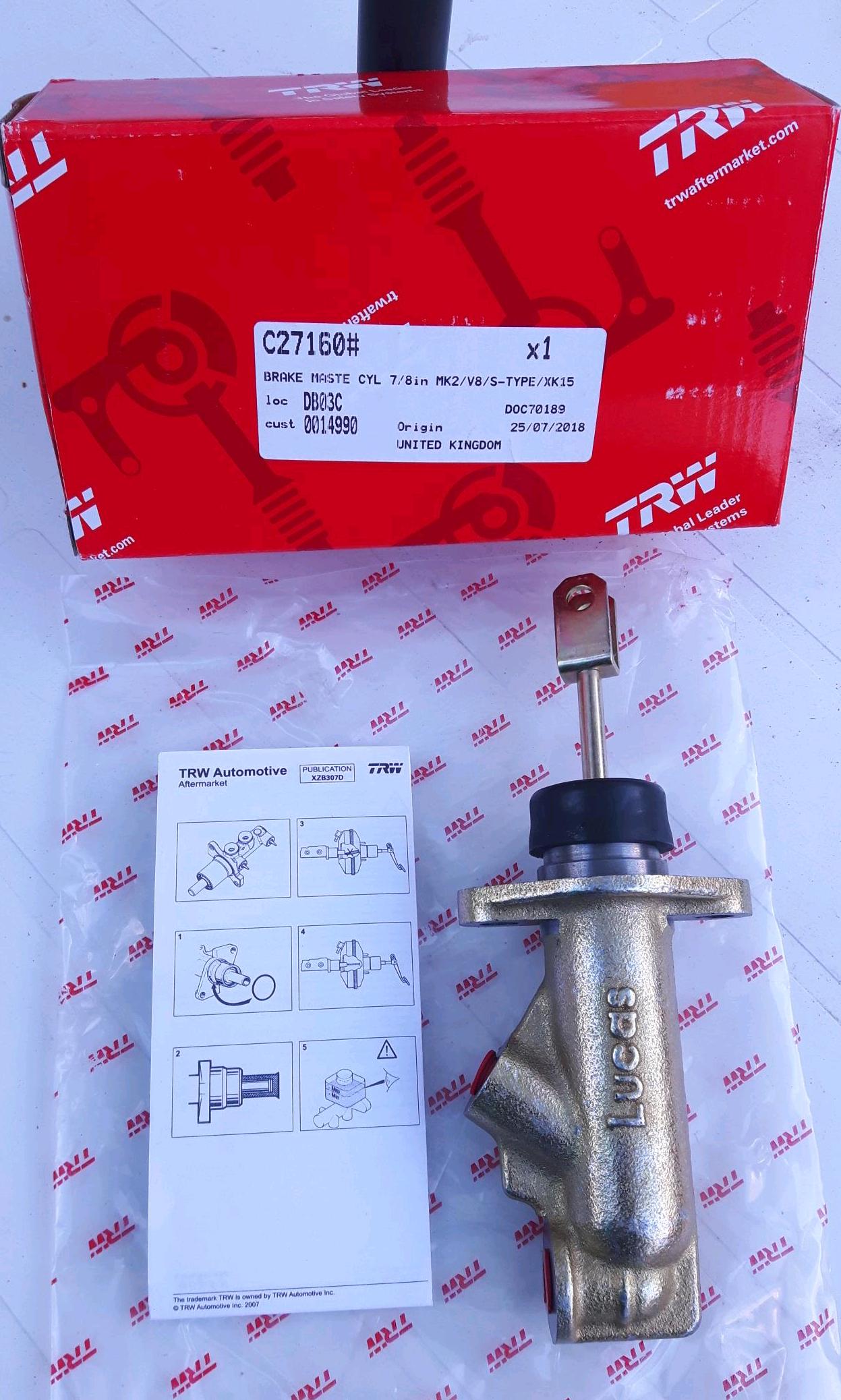

I think I've finally tracked down the fluid loss problem. I pulled the carpets up under the pedal box and found the felts were soaked in fluid leaking from the master cylinder, good job I use silicone fluid or a repaint would be in order.
Looking today for a new one has thrown up two types, one costs about £45 and another it seems only available from D Manners without a few more parts that I don't need, (costing another £50) a TRW item costing £99 listed as original equipment. I went for the latter as the cheap one looks like a far East part that I have less than full confidence in based on past experience.
Re: Disappearing brake fluid
please post a photo of it and let us know how it works.
Posts: 523
Will do, should be here tomorrow.
Posts: 523
New master cylinder from David Manners.
Note it has the Lucas script on the side, will fit asap.
Posts: 523
Finally got the new M/C fitted. I kinked the the brake pipe going to the servo removing it form the old M/C union but as luck would have it I had a new pipe of the right length with the correct ends on that had been stashed away in my shed for the last twenty five years. It was a bit of a struggle to fit with the bends along the engine bay and into the servo. I had to make up and fit new under carpet felts that were ruined with brake fluid from the leaking M/C. Took it out today for a test drive and the brakes are so much better, the new uprated servo really coming into it's own with increased stopping power.
