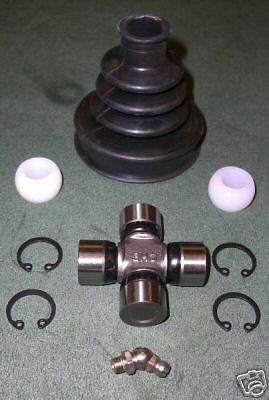

I replaced the steering shaft universal joint rubber boot as part of my engine compartment renovation about three years ago and have not driven the car more than a couple of miles since due to my problems with idle which I think I resolved by a very careful carb rebuild. Anyway, I was cleaning up in the engine bay this afternoon and noticed that the rubber boot has completely split open at the lower small end! Very disappointing. Not easy to get to now. Any suggestions on the best way to replace the boot? I have bought a new one from XK Unlimited but will probably also need the two aluminum clamp rings which I have been unable to source as yet. All help appreciated. It’s always something.

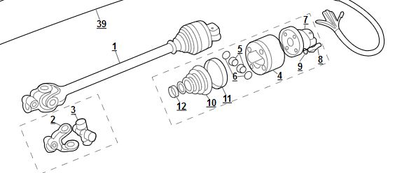

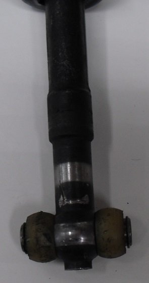

Alan ~ The lower steering shaft has a simple plunging CV joint at the upper end & a standard UJ at the lower steering box end. The only way to replace the boot is to remove the lower shaft. Much easier on LHD cars. RHD with carbs in the way is a sod. Try a save the aluminium clamps. They clean up nicely but are no longer available. Ideally upper column needs to be loosened & pulled out of top clamp on the upper joint.
Regrease the upper joint with a 3% Moly grease. Nylon rollers held on by circlips.

Then, make the repairs to the "sliding joint. ( why is it there?) If you haven't already done so, I would suggest replacing the two nylon rollers, as these were the major cause of play in my steering system. I didn't have the original metal clips, I used black nylon cable ties.

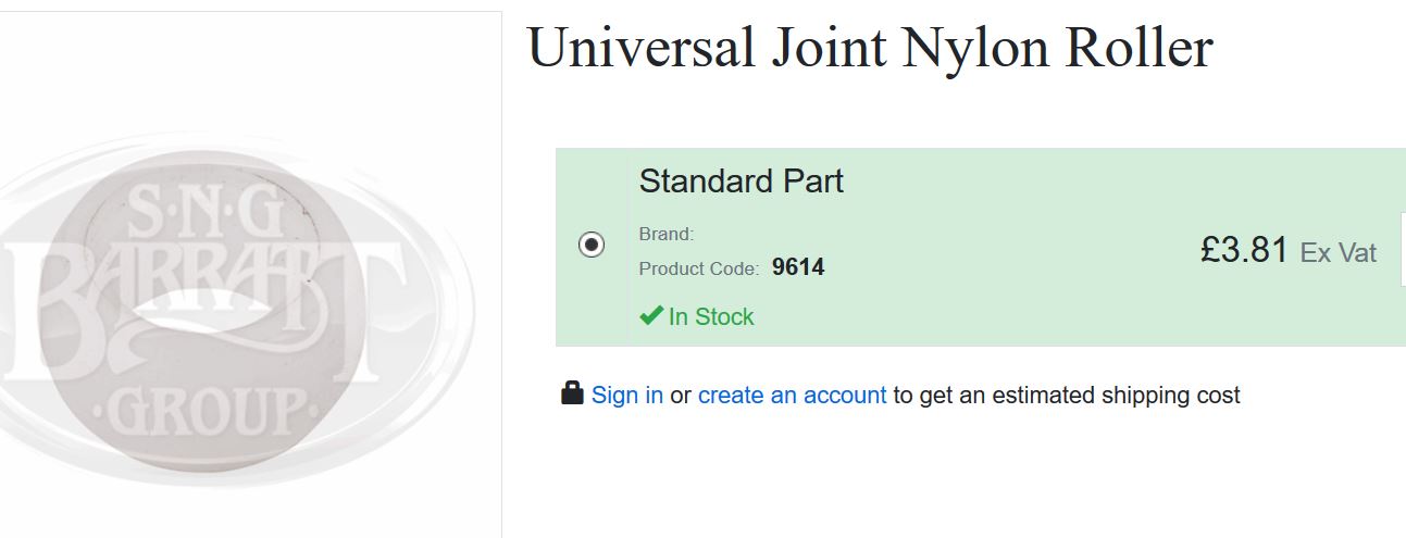

Warm up the boot in hot water & lots of grease or Vaseline. I too wanted originality so did not use a split boot. Used an original boot & original aluminium clamps.
The nylon rollers were worn on mine & cost peanuts.
