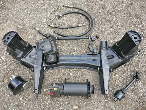

My bad Rob ~ you are correct. That is a Saginaw. The last S Types used a Hobourn Eaton with Varamatic. 420, Daimler Sovereign, 420G used an American made Saginaw pump with rest of the Varamatic built under license by Adwest from Bendix Corp. I have corrected.cass3958 wrote: ↑Fri Feb 28, 2020 12:19 pm Glyn I have seen this type of pump you are calling a Saginaw on the 420. It is bolted to the side of the engine over the top of the distributor and is powered by a belt coming off the water pump. Makes getting to the top of the distributor cap a bitch of a job. The pump sits below the reservoir. Are you sure that this was fitted to the later S Types. As you know mine is quite a late Sept 1967 manufactured car and I have the old Eaton pump off the back of the Generator.

Last S Type Varamatic.
