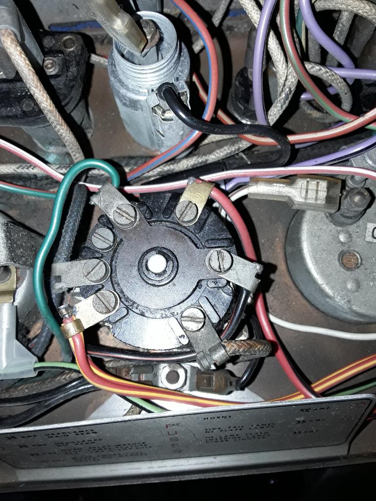

I've converted to a 4 pos switch when I refurbished the dashboard. I'm having problems connecting the right wires to the correct positions. can someone please make a photo or sketch how to connect the various wires? the electrical diagram seems to be correct, but the position of the connections is not clear to me.

Is this any use?
- light switch.jpg (158.51 KiB) Viewed 3903 times
Re: 4 position light switch
the Red with Yellow stripe are the Fog/Driving light wires. All Jags are like that until at least the last 1992 Series 3 body XJ-12 rebadged "V12" after 1987.

Oh yes, thank you very much José !!!!
