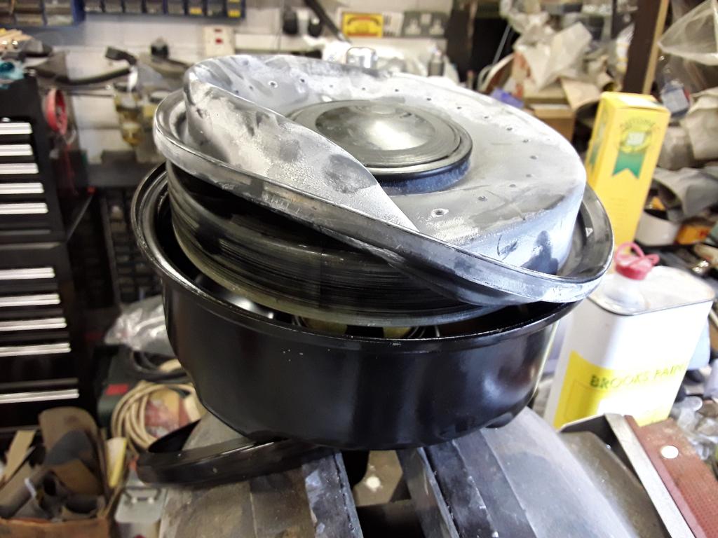

Pulled out the servo today and fitted the new uprated one from SNG. Managed to do it without removing the rad (flushing that can wait for another day) used Robs suggestion of not doing up the bolts till the pipes were in place. Pulled the lid off the old servo to see where the fluid was going but to my surprise it was bone dry and the diaphragm was in perfect condition so still a mystery where three bottles of brake fluid have have gone over the last year.

Well done Nigel you must have smaller hands than me to do it with the radiator in place. As for the fluid leak it is a process of elimination and you have now eliminated the servo. With mine I saw the fluid dripping off the nose of the servo but I never checked the diaphragm once removed as the new one works perfectly and I have not lost any fluid since. Can't be too many places the fluid leaks from.
