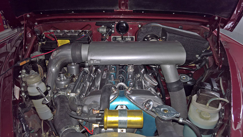

I have just had the top of my engine off (see other topics) and tried to solve this.
I measured the angles of the engine compared with the top of the wings and there was about a 2 degree difference so negligible. This could just be the way they have welded the wings on certainly not a fault in the engine mounts. The air box was at about 5 degrees.

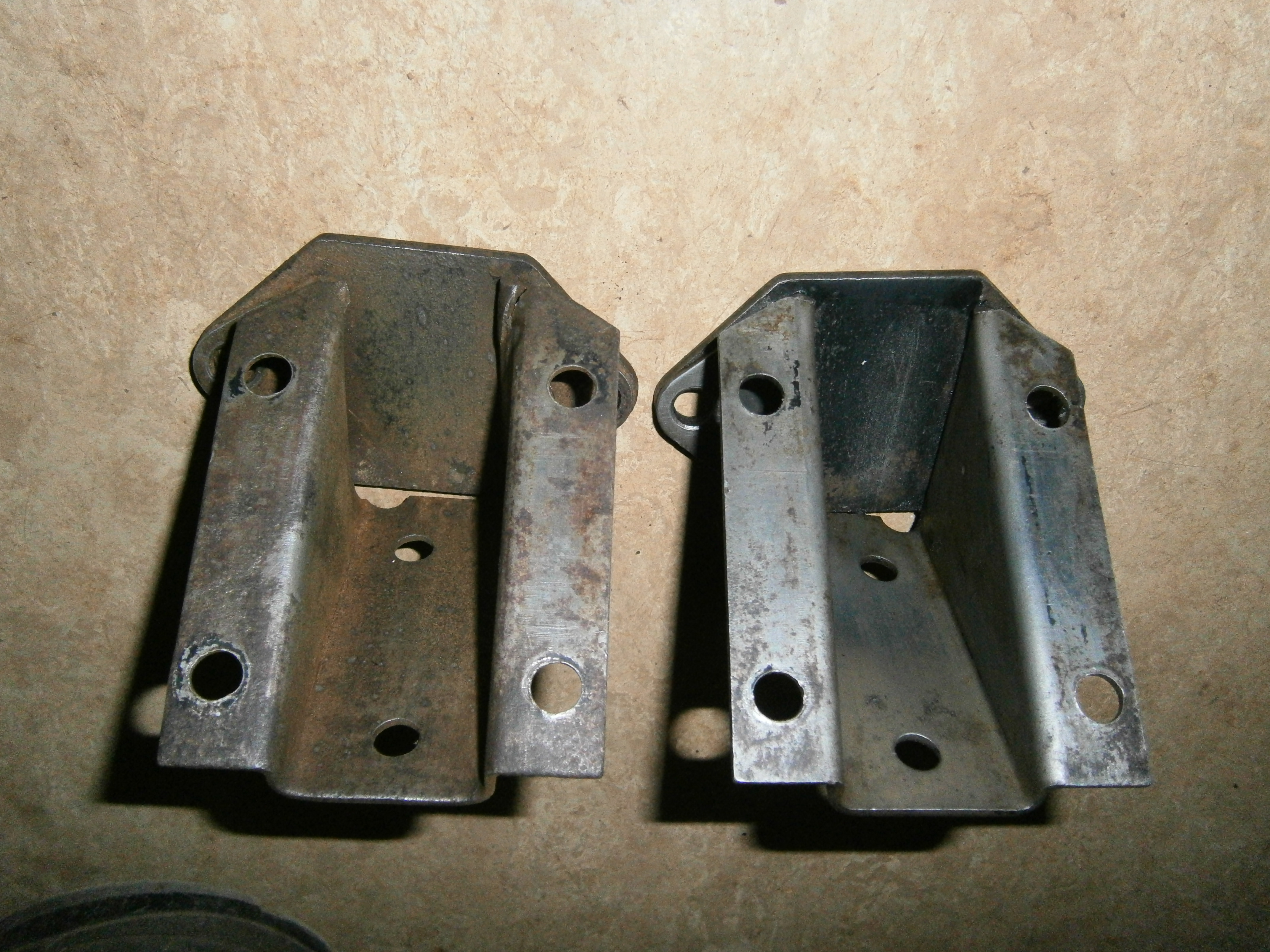

I checked and found a 2mm washer under my bracket on both head bolts. I removed the washers so the bracket was on the head with the washer on top. Did not make a blind bit of difference. I tried to reduce the height of the bracket with what is commonly known in the UK as a Birmingham screwdriver or persuader. (A hammer to our Western cousens) but to no avail because of the design of the thing there is no give. I looked at the airbox fixings and again there is nothing that can be done to lower where the air box fixings are.
Without cutting the bracket it two and taking a section out before welding it back together I am at a loss to see how I can get the thing level. We are talking about dropping the high side by about 10mm or 3/8 of an inch.
Re: Air cleaner not horizontal
I have had my engine made vertical now, by lifting it off the mounting brackets and setting down again in a vertical position. There are slots on the mounts, so there is a small amount of adjustment available. It has slightly improved the angle of the air filter, but not entirely corrected it. Which was to be expected, because my air cleaner was always more tilted than the engine.
I measured my mounting bracket and Alan kindly measured his. See post above. They are of similar dimensions.
So, I, too, am at a loss on this.
Two other thoughts occur, which may be avenues to investigate:
1. The height of the aluminium air intake.
2. Just possibly, the thickness of the carb to inlet manifold spacers C7461. I used the phenolic ones from SNGB which are 6mm thick, I think about 2 or 3mm thicker than the original spec.
Obviously, any dimensional inaccuracy at the air intake (right hand) end of the air cleaner is magnified at the cantilevered left hand end of it.
Perhaps in the end the quickest resolution is to take a slice out of the mounting bracket, as you suggest, Rob!
