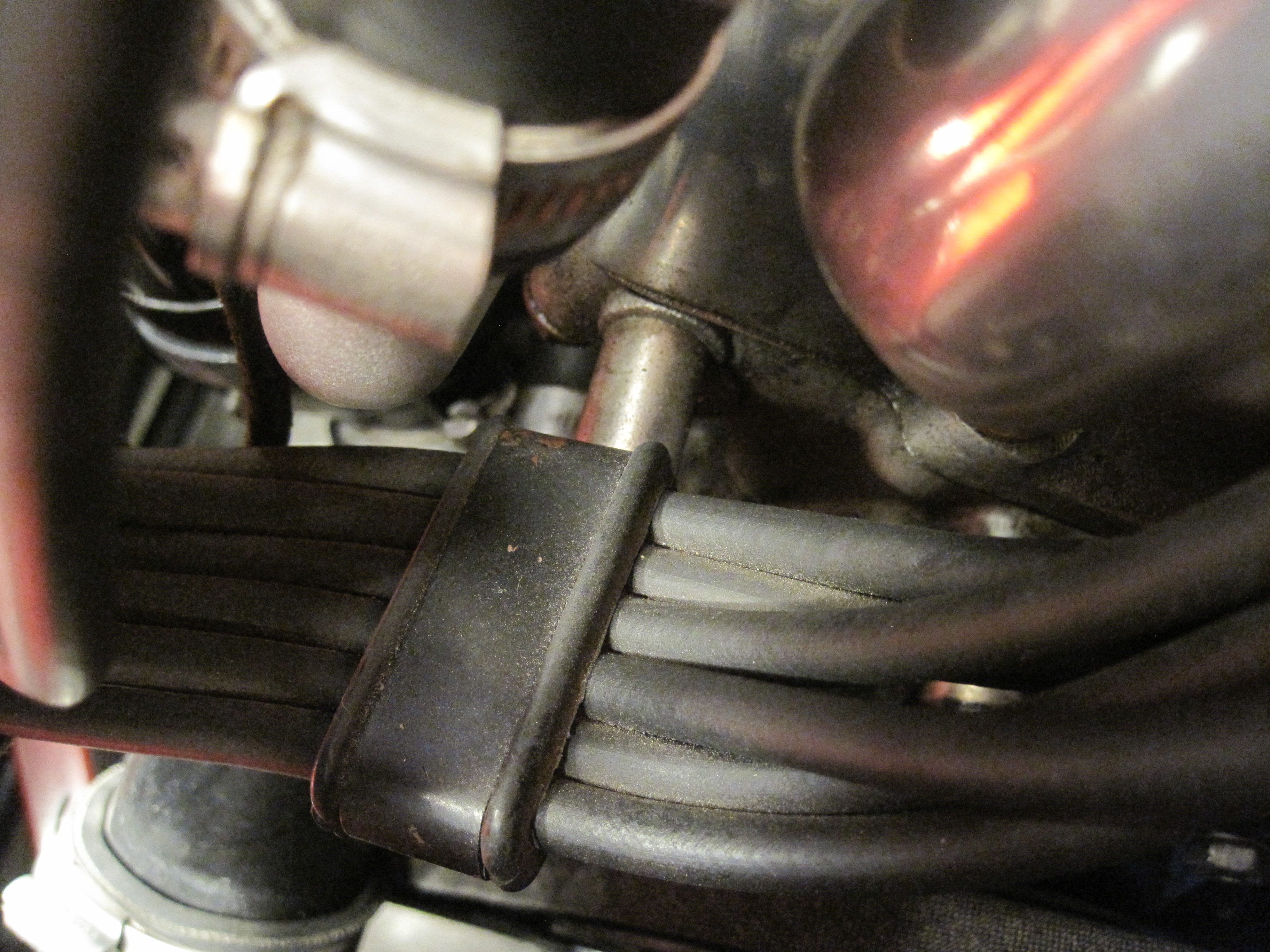

Orlando,
To answer your question about plug wire bracket orientation, I can't remember why I positioned it how I did except to say that it seems to be a natural routing for the wires. Not a great answer but if I go back through my notes I may come up with a better one.
As to the E Type setup shown in your photo, that appears to be an early car as the parts bulletin A.75, 3/1962, shows the same components as the S Types. I haven't been able to find when the next change in these components took place, maybe at the introduction of the 4.2 cars, but my car which is a 1966 (Parts Manual J.37) has a slightly different clip C25127 with a bent leg and a much thicker distance piece C24795 so the clip sits in a horizontal position at the same bolt hole location. The rubber grommet is the same as the S Type.

The E Types seem better documented. I've had an eye on that & the Factory Fit thread for a few years now. Originally looking at coil decals etc. Trying to tie up E Type dates with S Type proved impossible. The round HT wire clip C4982 was even used on some 240's & 340's. Go figure?
