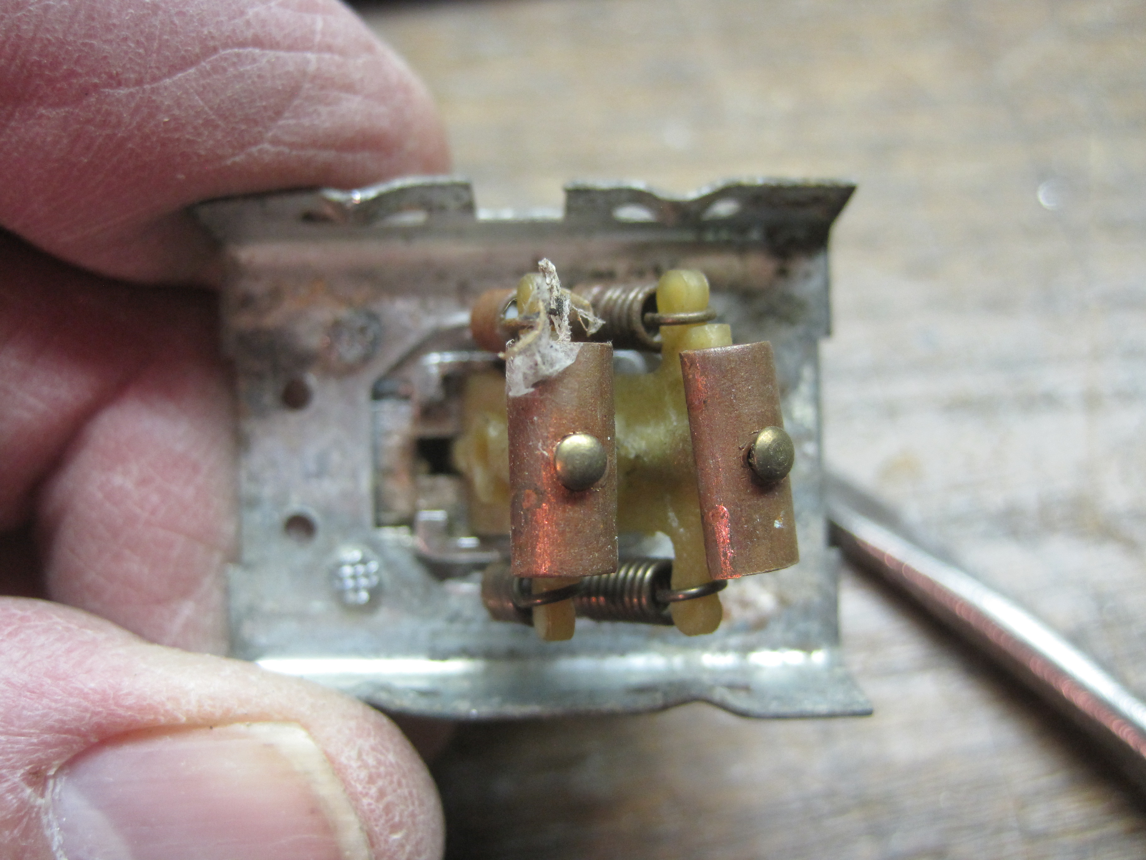

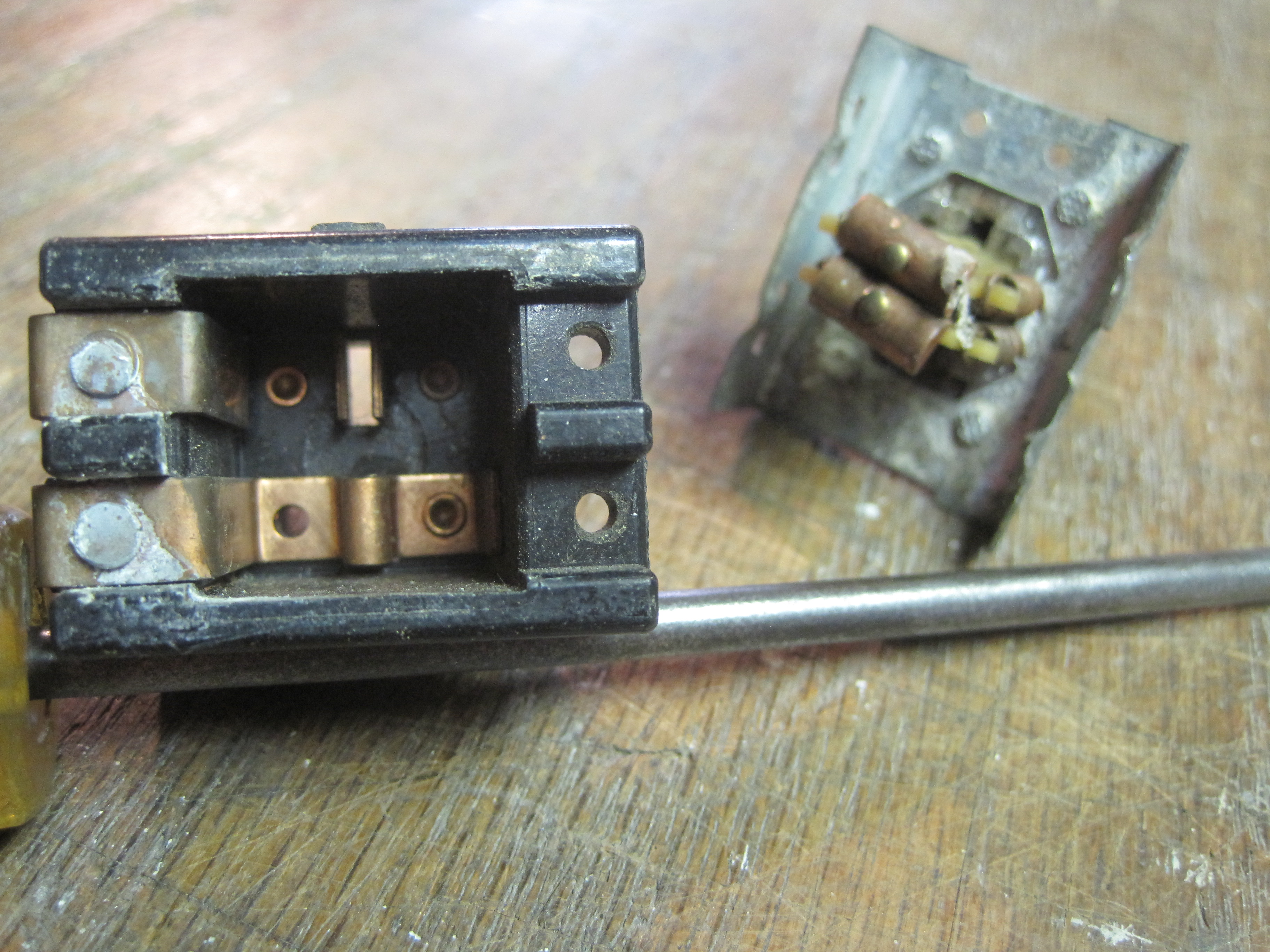

Here's a little update on my failed switch problem and I am happy to report that I am batting 4 for 4 in the switch repair category.
First switch was 31963F, a little on/off interior light switch from the E Type. We don't have one of those on the S. I removed the four little indents from the front cover and opened the switch to find that the brass contacts were corroded and the brass 'sled' contact was slightly bent so it was making intermittent contact. I cleaned the contact surfaces with fine sandpaper, lubricated the rocker mechanism with dielectric grease and reassembled, gluing the cover to the case with gel super glue. Works like a charm. I had been following a NOS 31963 switch on Ebay which eventually sold for $97, so I figure I made $97 this week and had fun doing it!
Next came 31969 and 31960 which are essentially the same switch except 31969 has the resistors for the panel lights. To disassemble, I gently pried up the side flanges of the front cover just enough to remove it. It is a somewhat soft material and is easily staked back in place during reassembly. Inside is a weird plastic paddle, spring and contact mechanism. Try not to let that come apart. Ask me how I know. I again cleaned all brass contact surfaces on the paddles and in the case. Assembly was pretty straight forward. Success with two 31969 (one for the E Type) and one 31960, and I still have the original switches from the cars. Thanks for looking for the switches, Jose, but I won't be needing any. Save them for future use.

- panel switch 002.JPG (1.9 MiB) Viewed 8085 times
- panel switch 001.JPG (2.29 MiB) Viewed 8085 times
