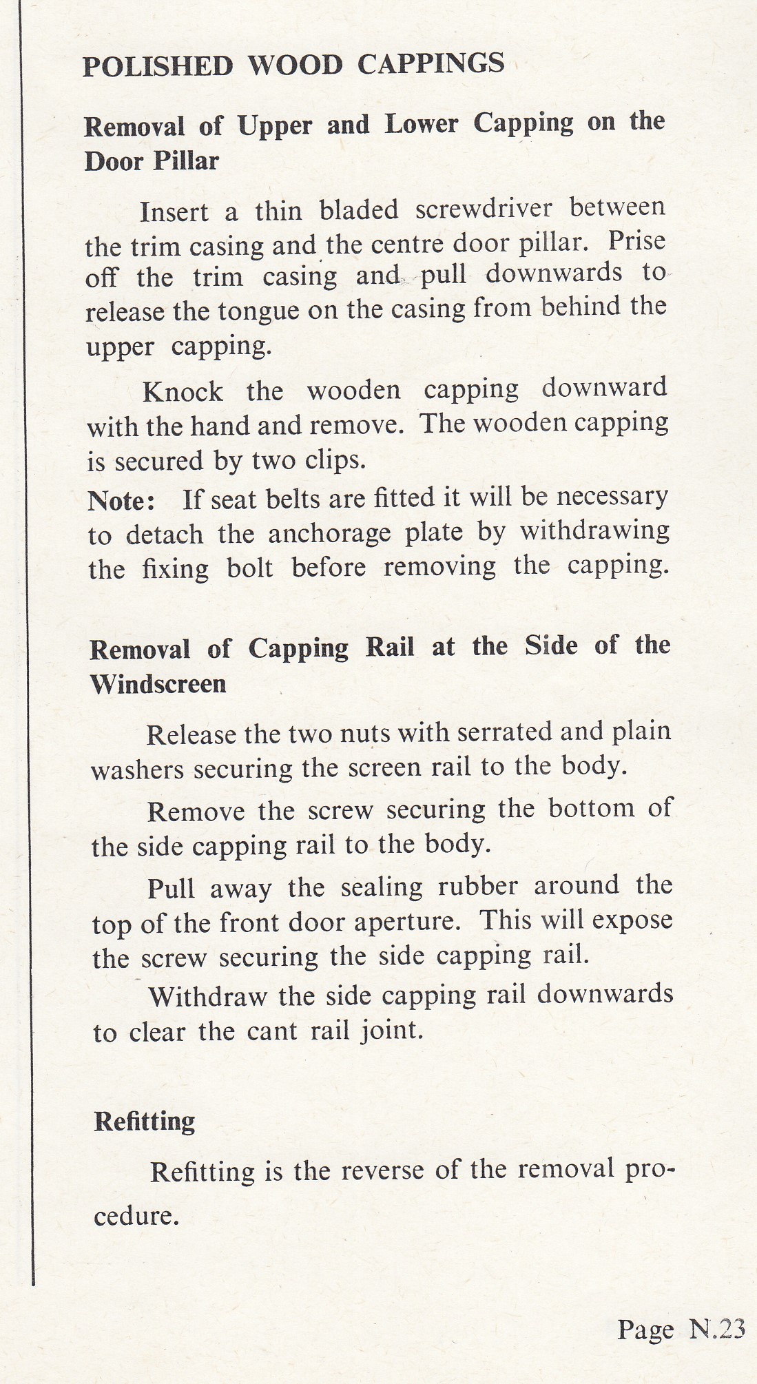

Mark,
The instructions are om page N.23 of the Service Manual (attached)
Service Manual p N.23.jpg (535.66 KiB) Viewed 5407 times

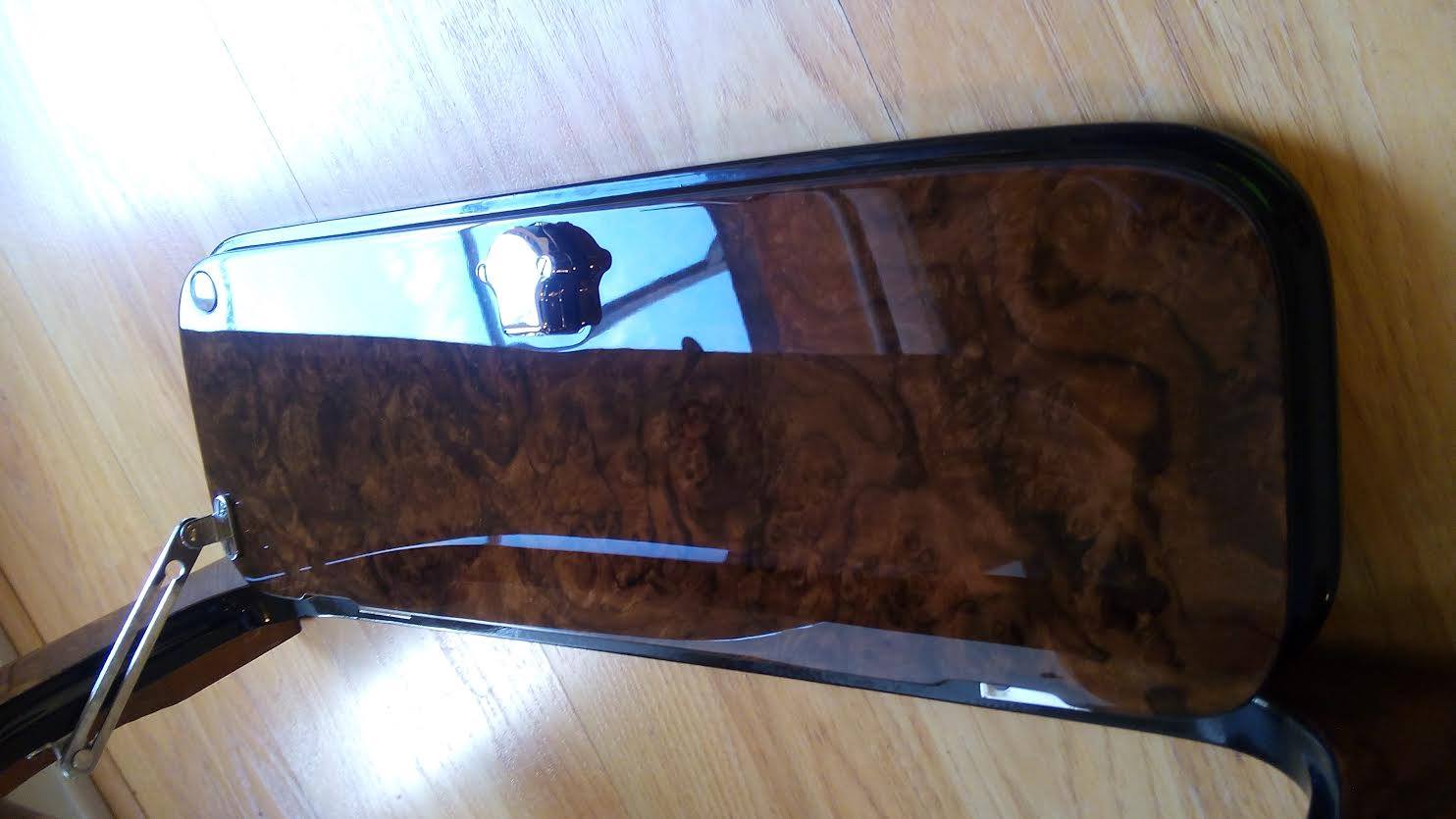

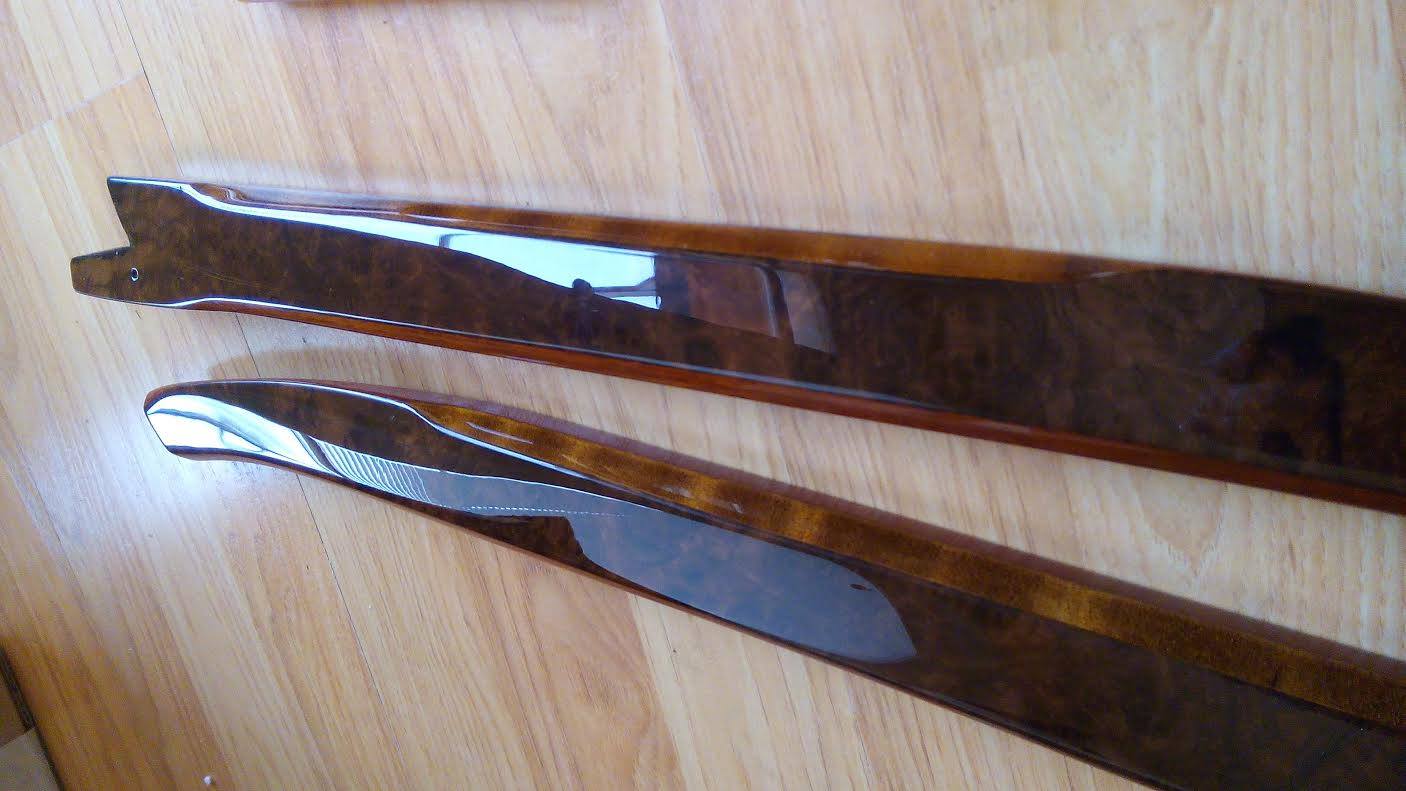

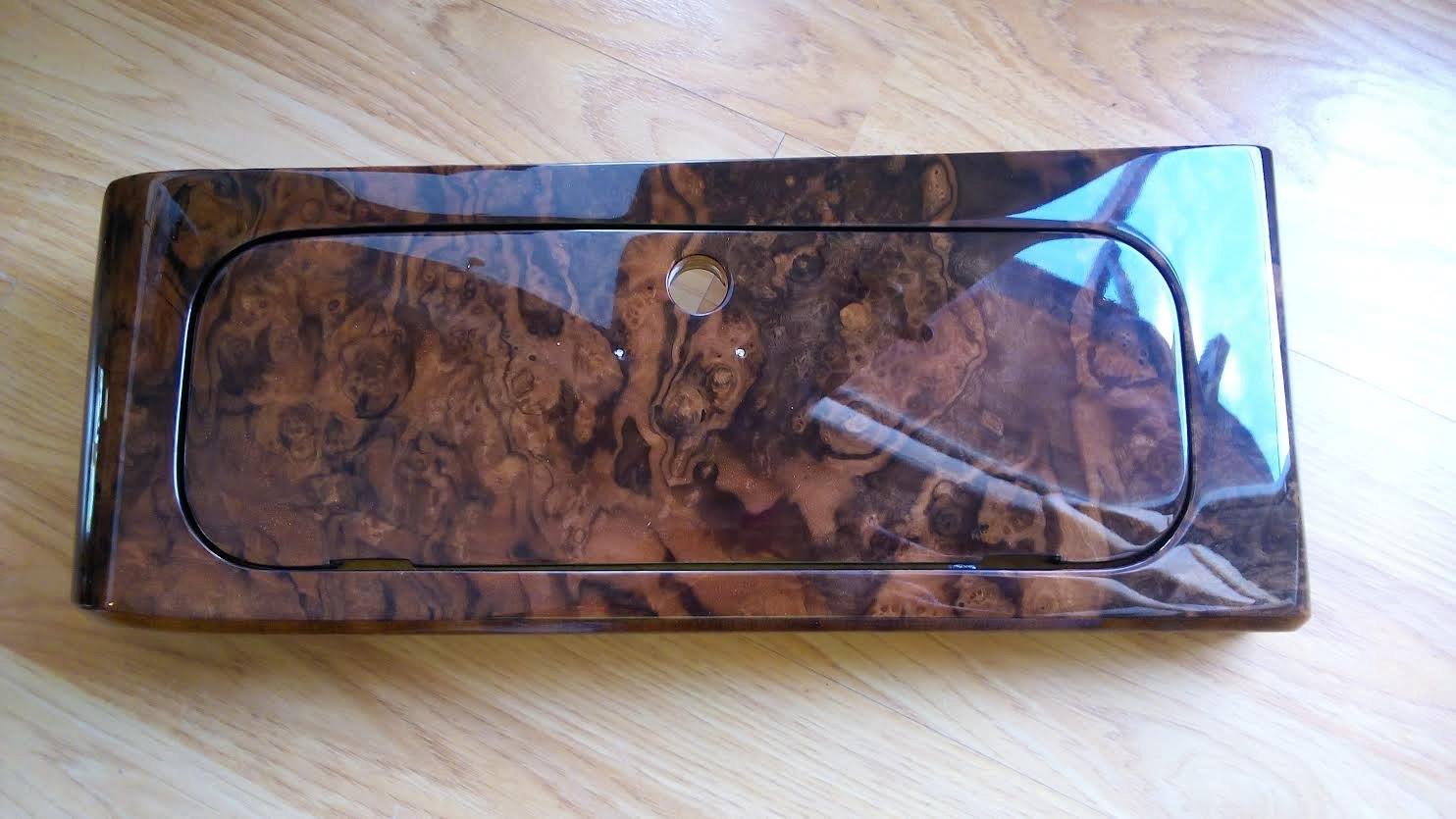

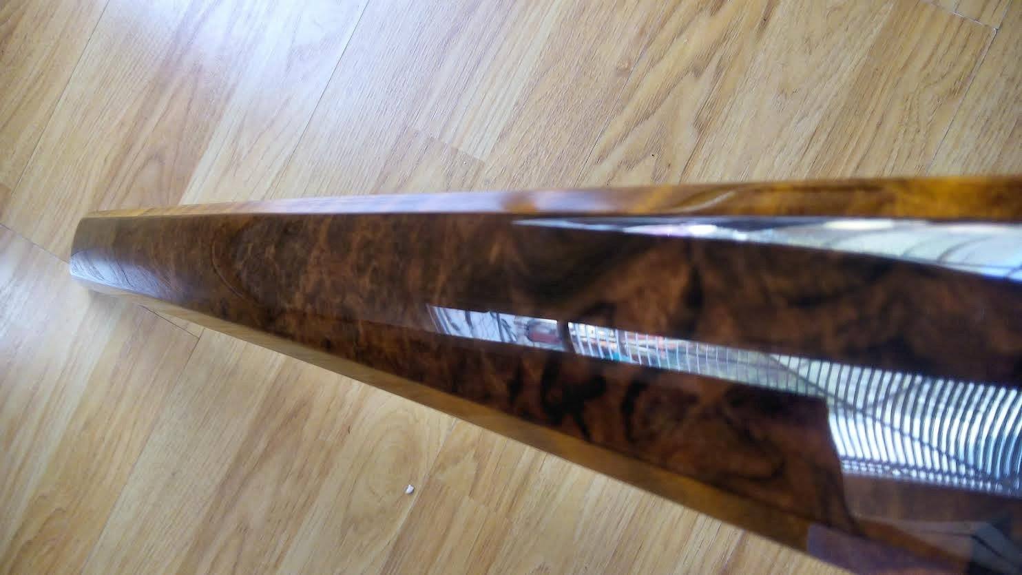

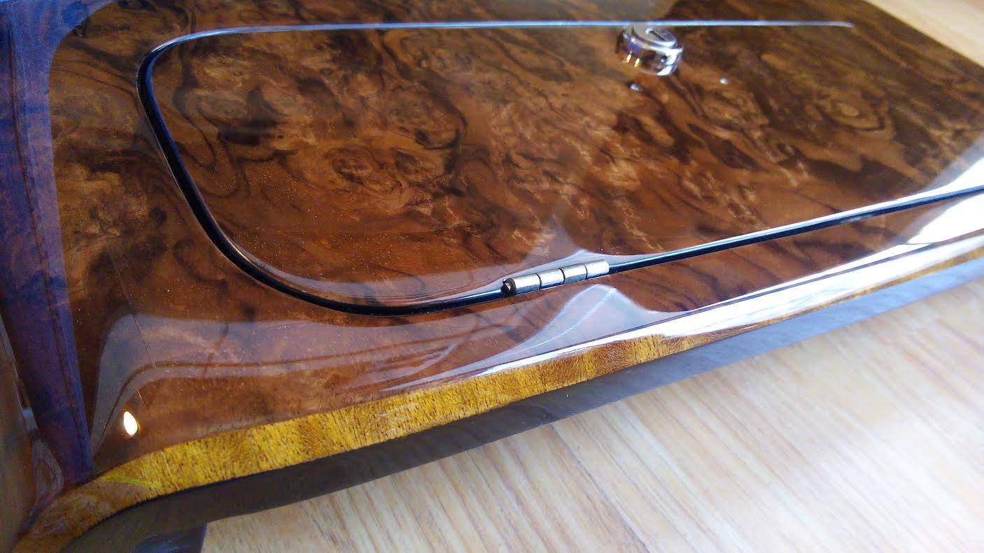

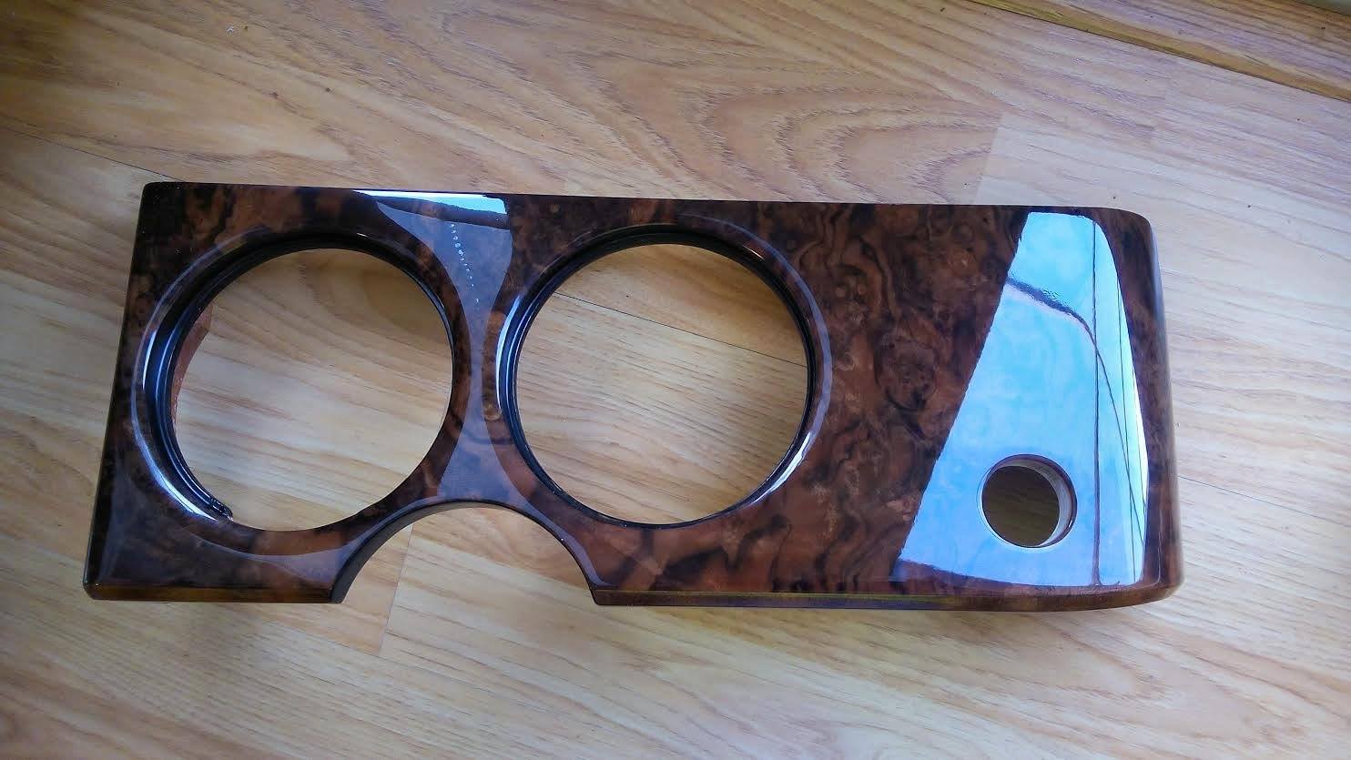

Re: Interior Wood Trim Removal
Just saw this post....sorry for being so late with a response. I had all my wood completely redone last year by Saul at BritishAutowood. I paid $4,500. He does a great job and I chose him over everybody else.
Good luck
Saul is not cheap but his work is world-class. I know him and have been to his modest shop. He is from Wales. Owns a 340 and a 420.
