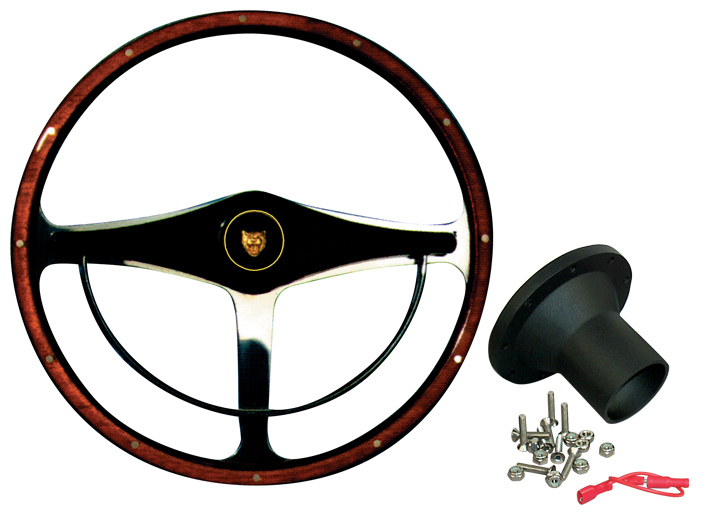

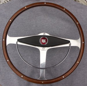

Your Editor is beginning to research an article on steering wheels and has the following preliminary information on.
The list of ‘Options’ for the ‘S’-type includes Part No. C.25198 “17” WOOD-RIM STEERING WHEEL”.
That steering wheel was first manufactured at the explicit request of Jaguar for use to special order on Mk 2 cars by V. W. Derrington and continued to be offered for the ‘S’-type.
C.25198 is a rarely seen option. Your Editor has seen only two in over 30 years of attending Jaguar concours and car shows.
Photos attached.
Photos attached.
- 2 “17” WOOD-RIM STEERING WHEEL” kit.jpg (140.62 KiB) Viewed 2474 times
- 1 Part No. C.25198 “17” WOOD-RIM STEERING WHEEL”..jpg (27.12 KiB) Viewed 2474 times

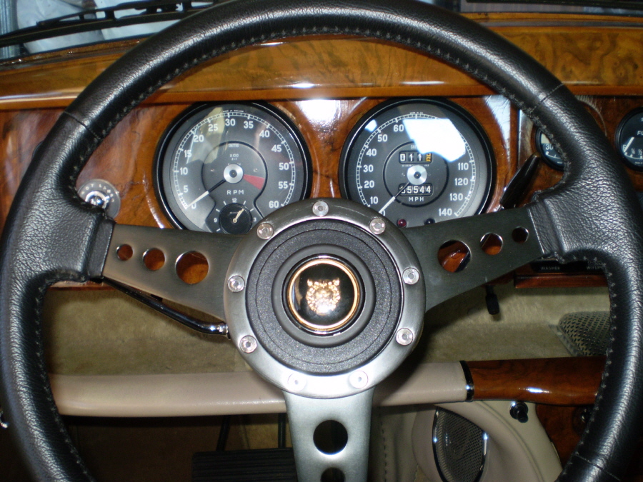

Re: Derrington steering wheel
the splined shaft is the same in the MK-2, S type, and 420. It changes to a smaller diameter spline from the 1968 XJ-6 on.
any steering wheel from any of those cars will fit on the other. But an XJ hub will not fit a MK-2, S type, or 420, the spline hole is smaller.
it is ridiculouis that these steering wheel sellers don't know this in this day and age.
Moss Motors in California sells MK-2 hubs for their line of "Tourist Trophy" steering wheels, but the hub bases are matched to their steering wheels which have 9 bolts securing the wheel to the hub, per the picture of the one in my car below.
I've never removed a Derrington so I have no idea how it attaches to the hub. They are wonderful steering wheels. You might talk with Saul at British Autowood since he restores them.
www.britishautowood.com
- S-type-steering-wheel.JPG (336.59 KiB) Viewed 2470 times
