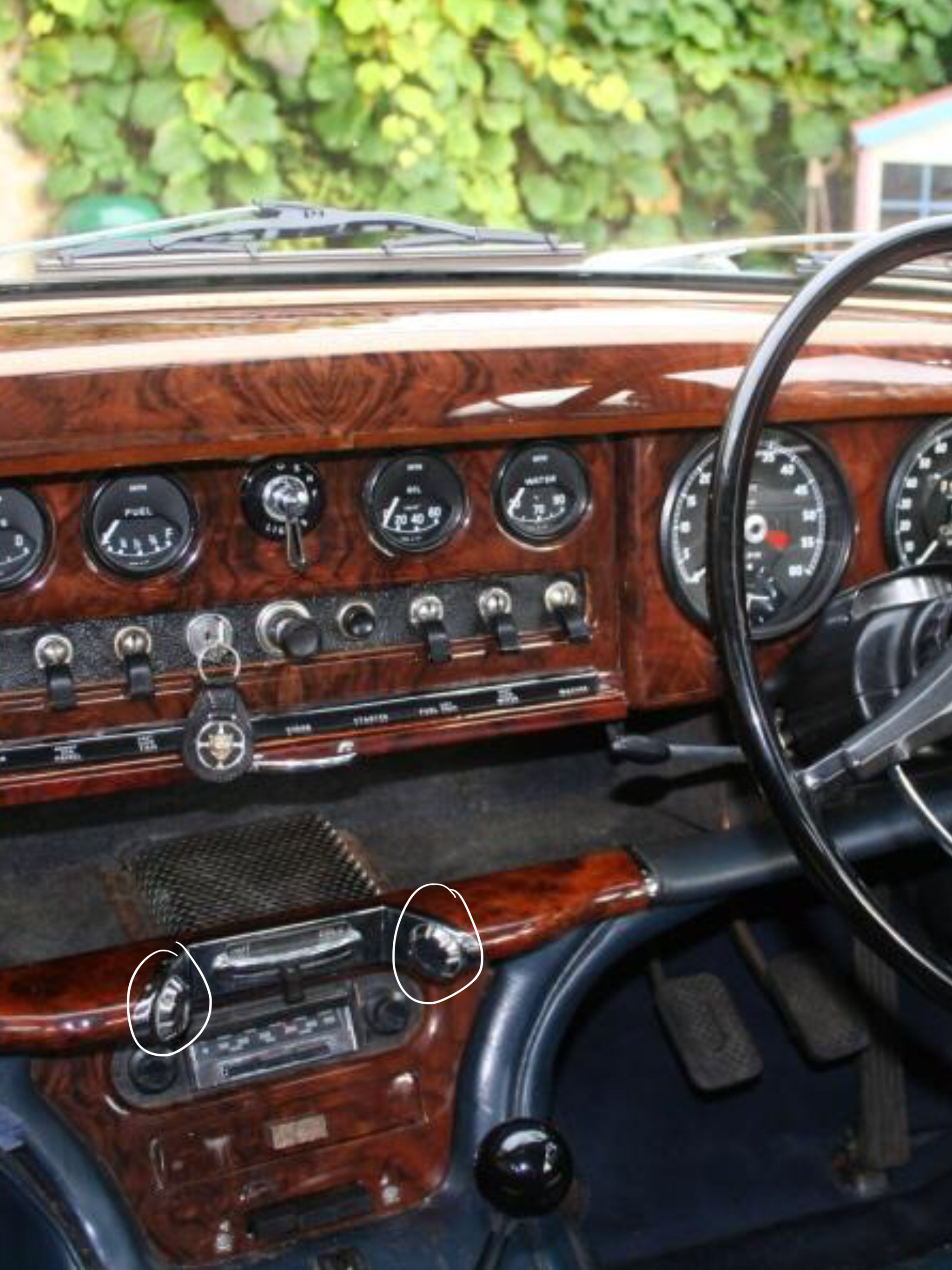

Does anyone know where or how I might get hold of a a heater knob? The left side one is missing on my car.

those circled? they are Vent Controls, they open and close the air vents under each side of the dash. The Heater is controlled by the HEAT button in the vacuum switcher below the radio, and the temperature (cold-hot) slider above the radio.
also you cannot really replace the chromed knob, it is factory-crimped in such a way that once the knob is removed, the knob can't go back onto the cable, so you need the entire cable assembly from the knob back to the vent. In other words, the cable end is crimped to the knob permanently.

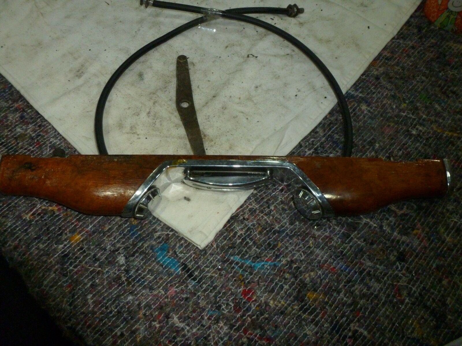

here's a complete S type Vent controls assembly I have from a 1966. To remove the cable and knob, you need a very thin spanner that fits between the back of the knob and the chromed plate over the wood, the cable and knob comes out through the front. I don't know who invented this, but my my, what a difficult design.

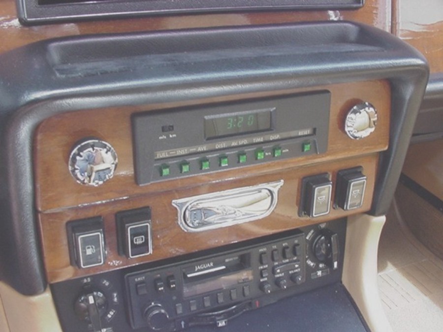

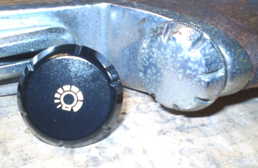

I used two of the S type knobs in my XJ-6, pulling the cable from the knob's shaft was not easy. I had them rechromed and adapted them to the cig lighter and dimmer.
Jaguar reissued very similar knobs in the Series 3 XJ, (1980-1992), but in black Plastic.

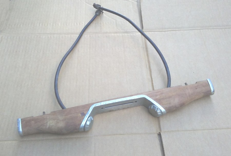

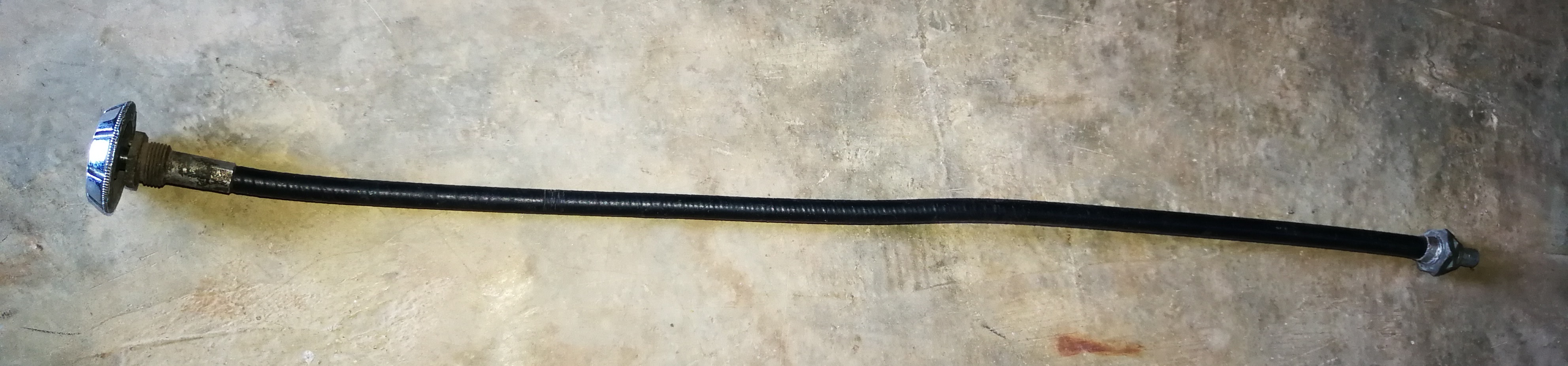

Those Knobs are swaged onto the cable. They wont just fall off. Cable was supplied as a unit as below. There is a clamping nipple swaged onto the other end of the cable. You cannot extract the inner from outer cable without cutting it. This makes re-chroming the knobs a challenge. You have to seal the entire outer cable in a plastic pipe with silicon with only the knob protruding to be able to re-chrome the knob.

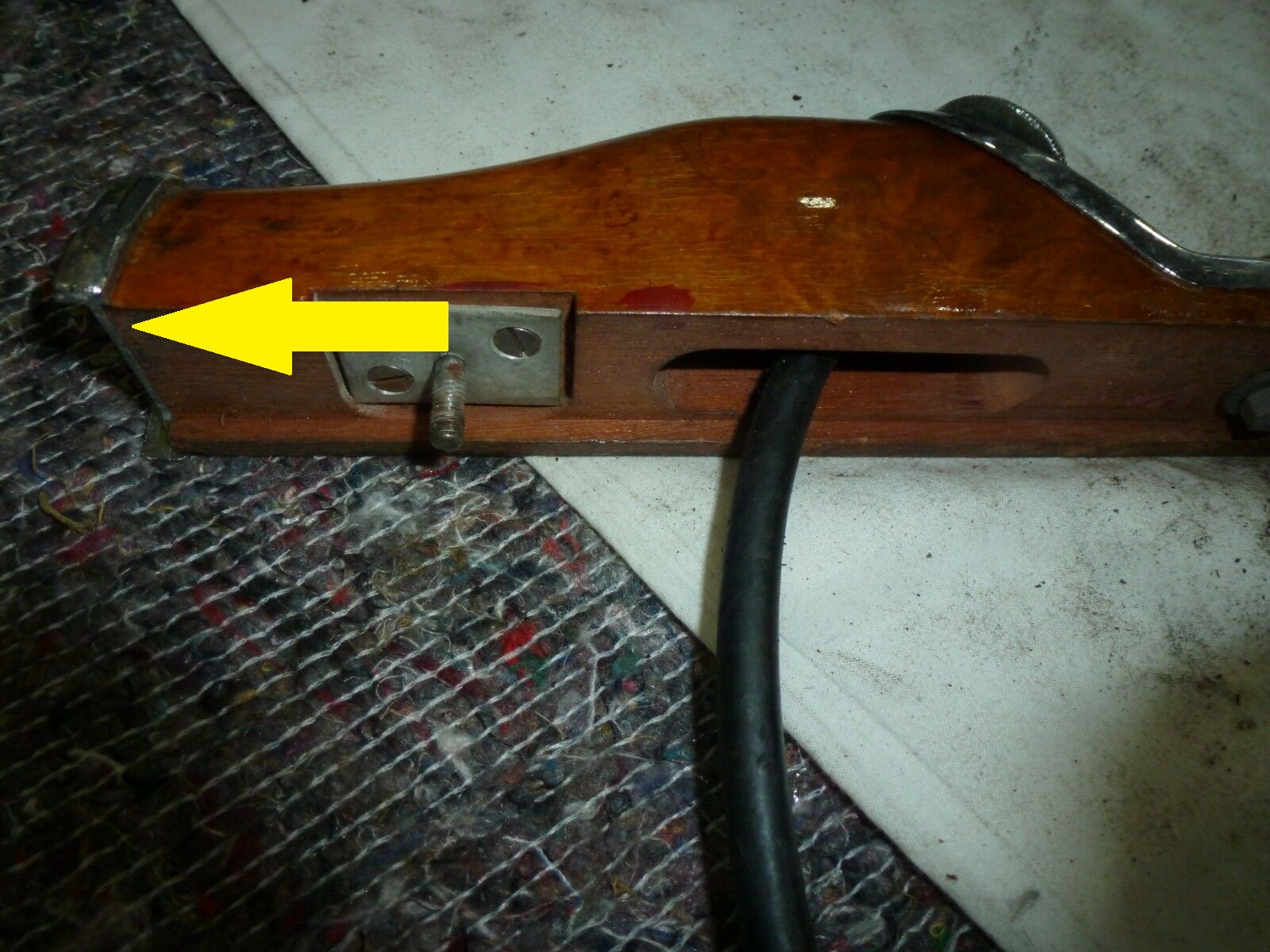

Interestingly ~ There are 2 different crash roll sizes that were used on the parcel shelf that I've been unable to date. There is a shallow offset centre wood piece & a deeper offset.
The chrome end capping I indicate in this picture comes in two sizes. My car has the larger deeper capping of the two.
