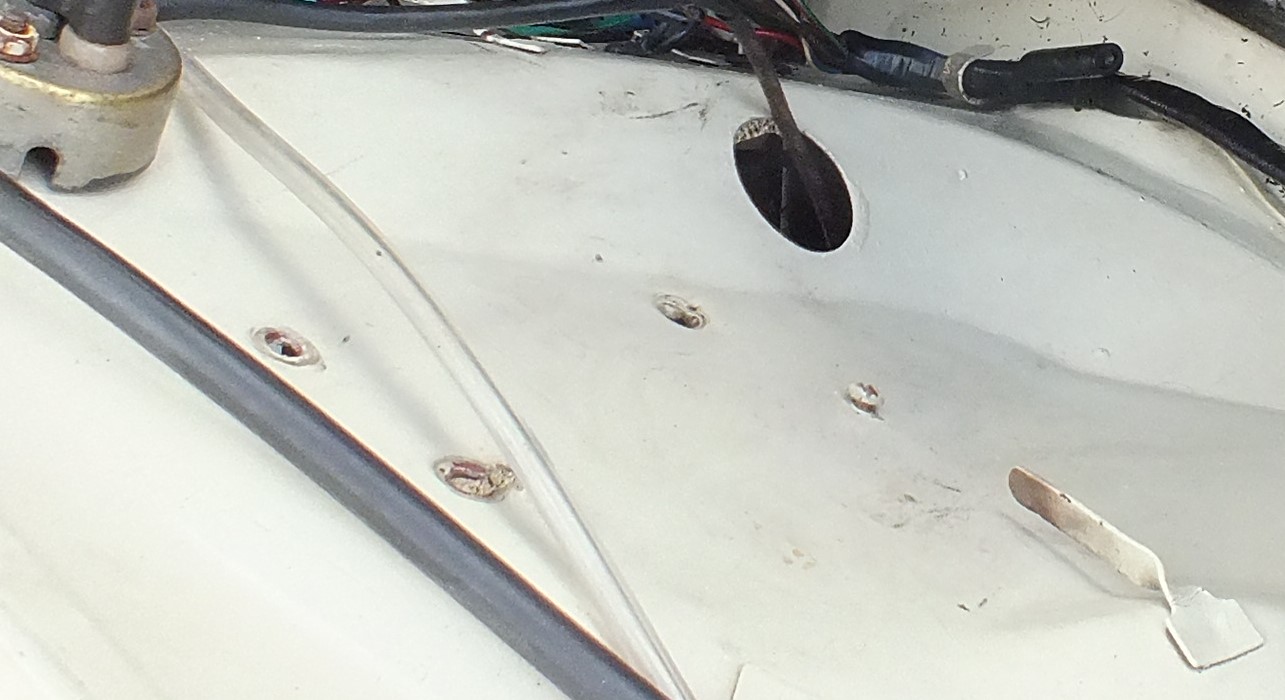

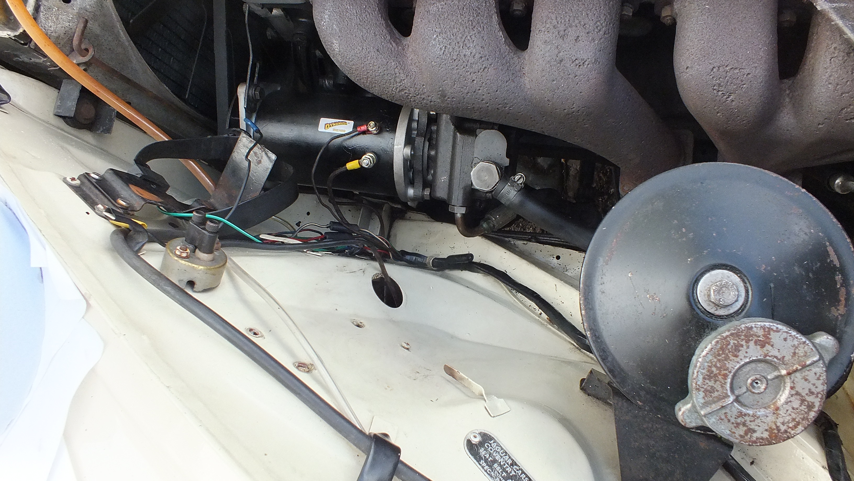

Orlando I have been looking at my old photos which I have reproduced below. I have now removed my Voltage regulator having converted to the Dynalite alternator but from the photos and memory the earth came from the VR and went down to a self tapping screw which was just below the VR screwed in to the inner wing. You might still have the hole in the inner wing.
The self tapper can be seen in the second photo which has been taken with the VR removed. It is below and between the two lower fixing screws for the VR. The third photo is a close up cropped photo of the screw and its position.
Hope this helps.
Hope this helps.

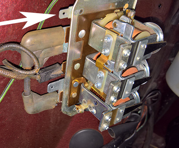

I have a n.o.s. RB340 Regulator and it has a black ground wire connected to the upper spade terminal.
I'll pull it to take pictures and measure the wire.

Thanks so much, Rob. That's really helpful. Now I look, I do indeed have a hole for a self-tapper in the same place.
And, thanks in anticipation, Jose.

the wire is 6-1/2" inches long, with one copper Spade connector at the regulator end, and one steel Ring connector at the other end.
The measurement is from the end of the spade connector to the end of the Ring connector. It seems this is a redundant Earth because the chassis of the Regulator contacts the body through a mounting screw at the front where there is only 1 mounting screw.
Re: Voltage Regulator Earth
Thanks, Jose. That's very helpful. No, the earth is definitely not redundant. You might, if you had bare metal on the inner wing, get an earth via one of the rubberised mounting posts by chance. But, I know from expensive experience that that little earth tag is definitely needed.
That's a very nice example you have there and thanks for sharing it with us.
