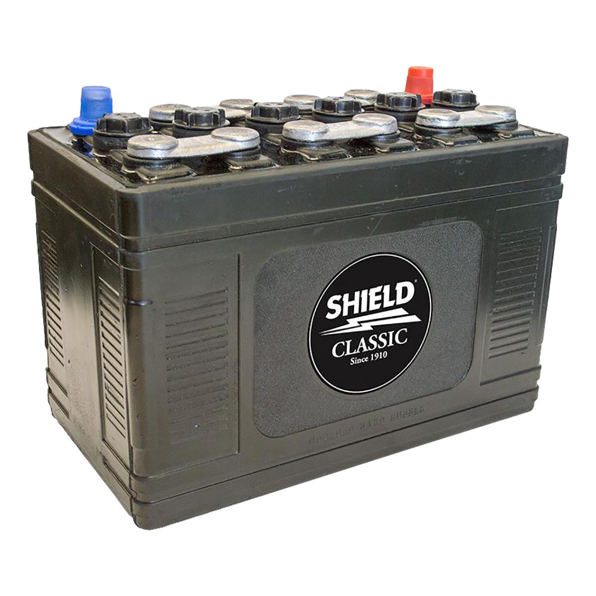

I bought a Shield period-look battery with hard rubber case. The model is 242. 73Ah. This is my second; the previous one lasted me 7 years. I paid £125 direct from Shield. I have mounted so the terminals are towards the front of the car. Mine is positive earth.
