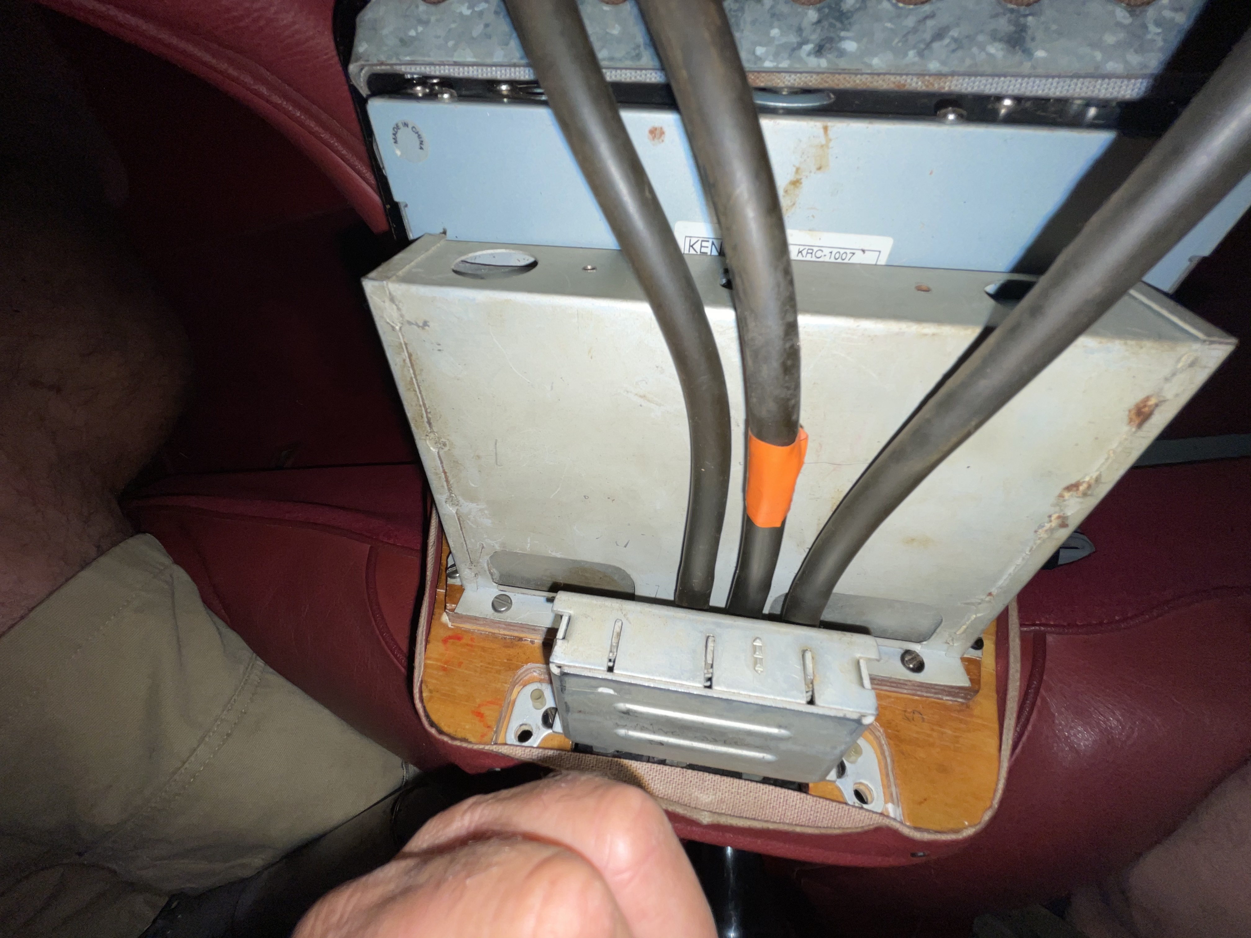

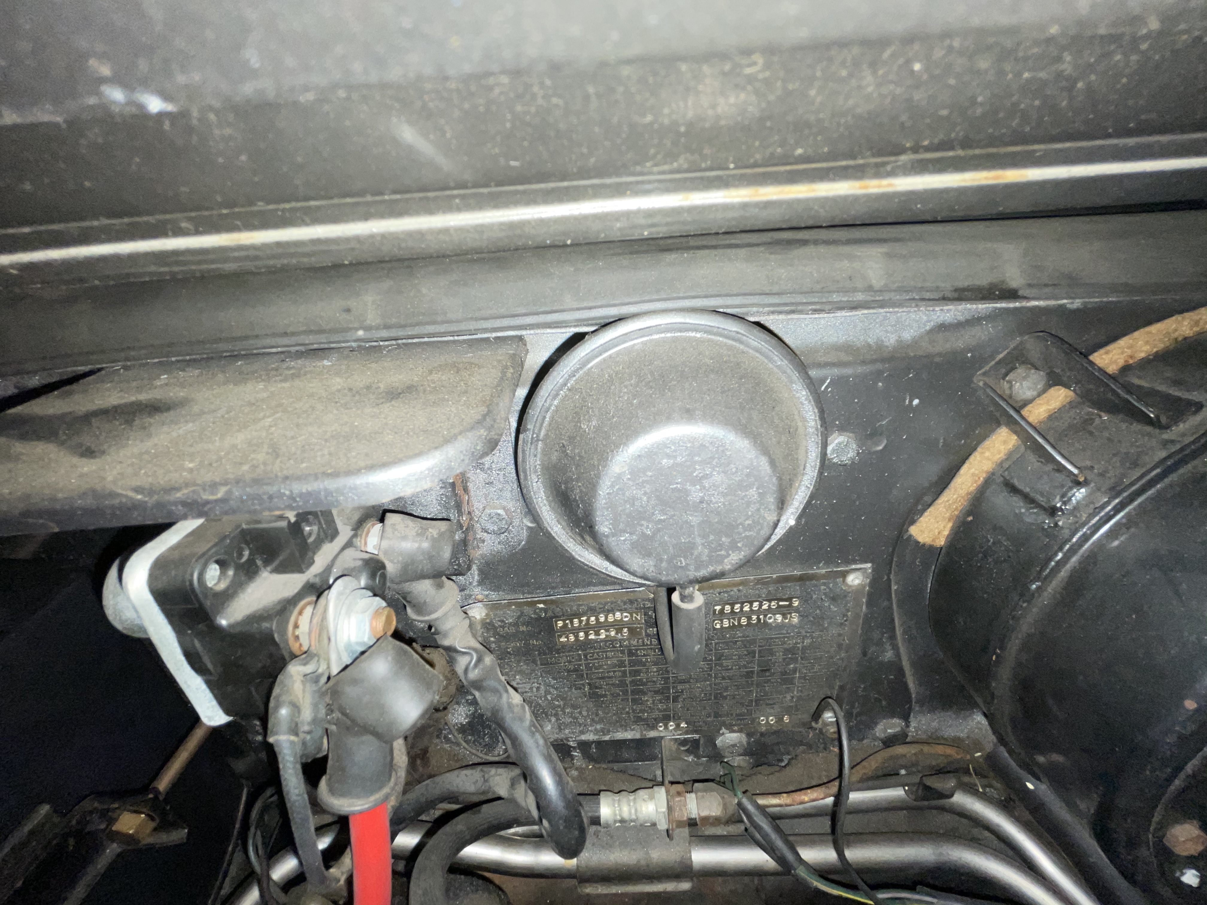

1st issue I found was the vacuum lines to the vacuum control box were incorrect.
I connected the line that runs to the valve that actuated the cold air door to the air button.
I disconnected the vacuum line at the vacuum valve and sent pressurized air through the line to identify it and attached it to the heat button.
I attached the last line to the off selection.
Test drive tomorrow.

That's good and I did not even get to describing what each of those buttons do but they are fairly self explanatory as long as you have found, they have been plugged into the correct tubes.
Basically HEAT opens or should open the heater vacuum valve to allow hot water to the heater matrix. AIR opens the scuttle flap and I can't remember what OFF does. lol.
If you open the AIR scuttle flap you will know if you have a good vacuum or not because once you switch the engine off the scuttle flap will close almost immediately so you have a poor vacuum store and possible a leak or it stays open for five mins or possibly longer showing a good vacuum store.
If you come across any problems please come back and ask. There are loads of us on here who have stripped and rebuilt their cars all willing to give answers.
Re: Heat always on ?
I think OFF on the three button control closes the scuttle vent and presumably closes off the water valve. My scuttle vent sinks down to closed after a minute of two. I can live with it. Not sure if it is the vacuum capsule, the rubbber lines or the three button device that has some minor leaks after 56 years of use.
