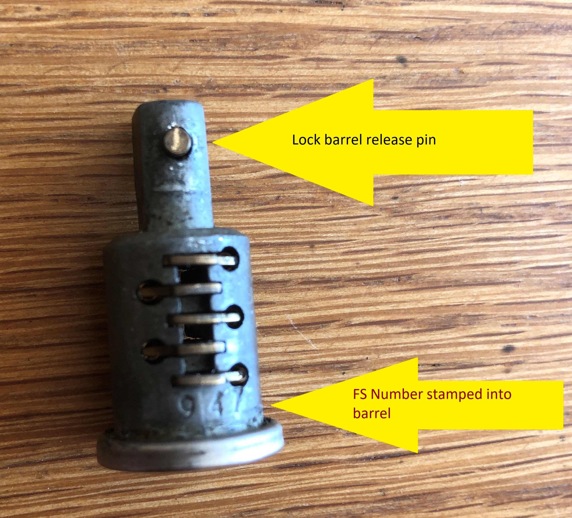

The switch can become worn over time as can the key making a floppy connection. A bit of copper grease in the key hole might firm it up a bit. They are very easy to strip out and take to pieces. They do not cost a lot to replace if worn but you will then have a different key to the doors and ignition. The Keys are what are known as FS keys and on the barrel of the ignition switch there will be a number. This number is the key code for both the ignition and door key. If when you buy a new ignition barrel you quote this number the supplier might be able to match up the new barrel to your key code retaining the same key for ignition and locks. If it is the key that is worn then new keys can be bought from https://www.replacementkeys.co.uk/union ... K4EALw_wcB You need to quote the FS code for the key which is on the original key or as described on the lock barrel.
There were very few FS key combinations, I think less than 1000 so every 1000th Jaguar coming off the production line had the same key combinations. FS keys were used on so many cars in the 1960s that thieves used to walk around with a bunch of FS keys on a ring and were guaranteed to have the right one to break into and steal your car in minutes.

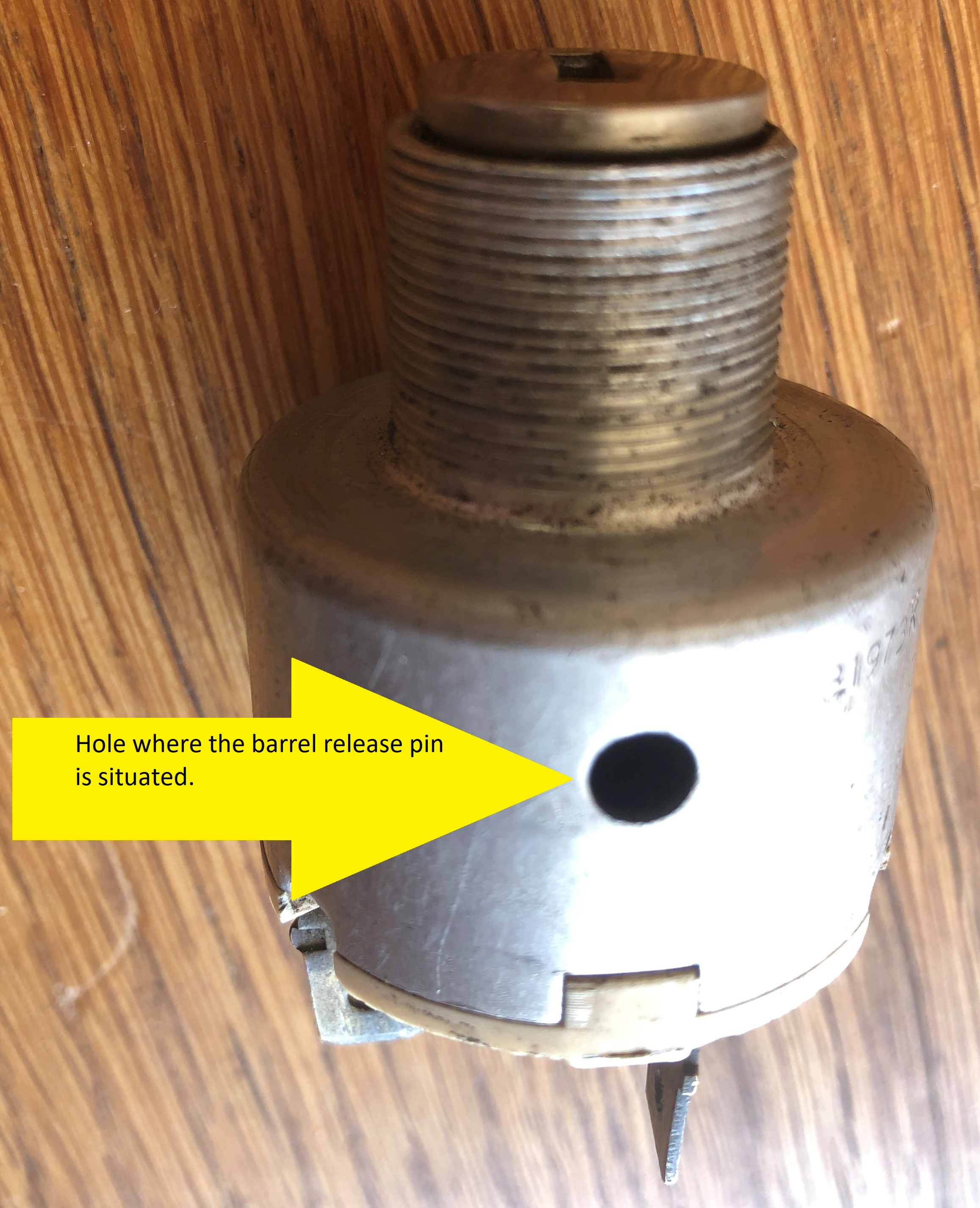

Below are two photos of the ignition lock showing the barrel release hole and then a second of the barrel showing where the FS number can be seen.
