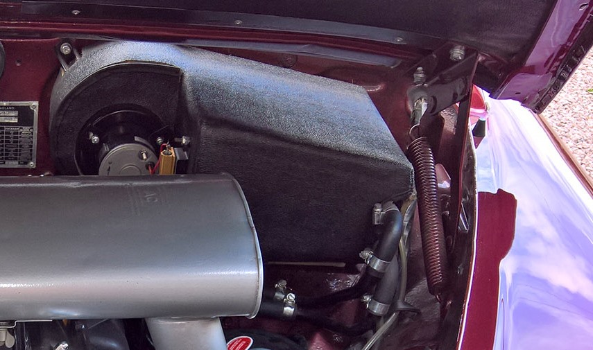

Did you get this upgrade from Claytons?
Orlando's car is fitted with an upgraded heater from back in the days. Might be able to find one of those & restore it. Shoot him a PM.
Orlando's upgraded heater:
Re: Heater improvements
Yes, mine (pic in Glyn's post above) came from Claytons and has the upgraded fan and radiator. I had to send them my existing box and they upgraded it. It does work better than the original. Then again, I almost only drive it in the summer.
