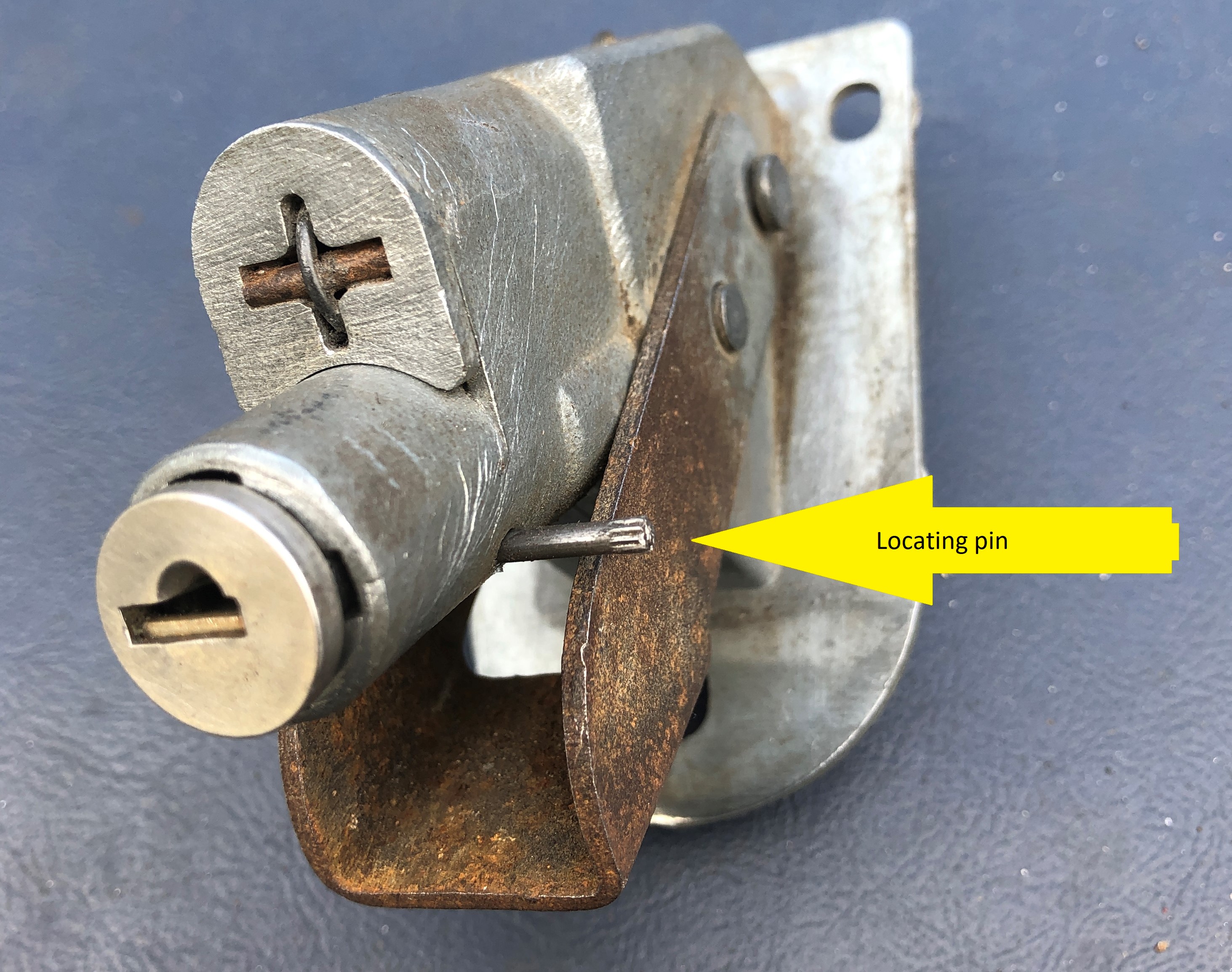

The boot lock is the hardest and if it is locked there is no way to remove the mechanism to get to the FS Number so you have to hope the Glove box number is the same. If the boot is open then you have to remove the mechanism from inside the boot. Remove the chrome plinth. The lock mechanism is held in with three bolts and is connected to the levers with a circlip. The mechanism has the lock barrel with the handle to open the lock underneath it. If you look down the side of the barrel at the bottom there is a hole either side with a retaining pin running through. I found if you go from left to right it is easiest due to the splines on the pin being on the right. Take a small punch and tap it in to the left hand side to push the pin out of the right. Once the pin is out the FS number can be found stamped into the side of the barrel again.
If the boot is locked and the FS Key from the glove box does not fit the only options would be to break the lock by hammering a screw driver into the key slot and turning the lock to open the boot. You do not have access to the pins location when the Plinth is in place. The second option is to drill the lock out but either method will destroy the lock and it will have to be replaced using the method above. I would assume that as there are a limited number of FS Numbers if you were to contact somewhere like SNG or David Manners they might be able to supply you with a lock number to match either your glove box or your ignition/door lock FS number.
