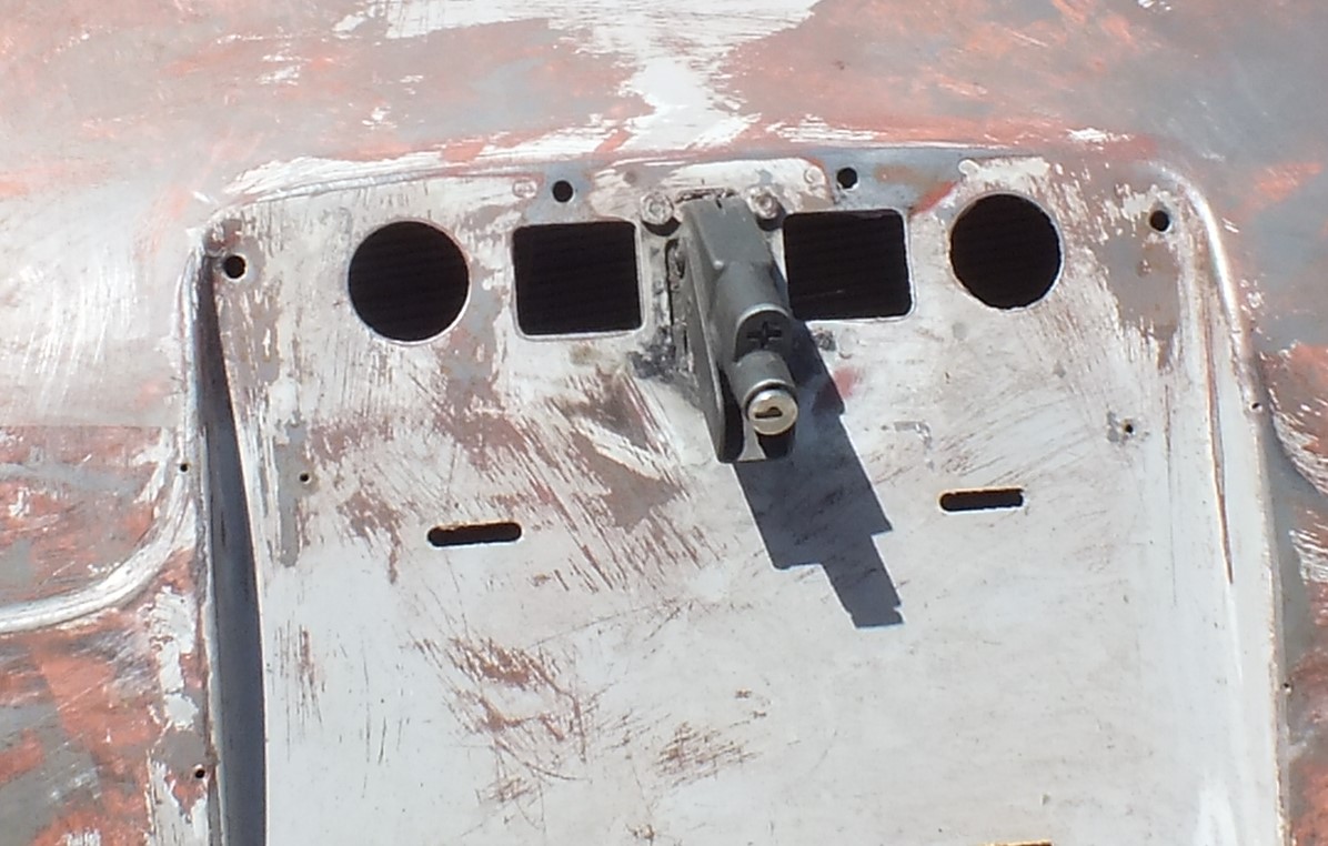

I don't have a photo of the inside set up of the boot lock but here are two of the outside showing the lock mech in place and one without during my strip down which might help.
- DSCF6106.jpg (3.2 MiB) Viewed 3247 times
- DSCF6100 (2).jpg (226.02 KiB) Viewed 3247 times

Rob's picture of the lock was the big clue. I realized that what I was seeing on my car was not the lock cylinder but the mechanism behind that it engages with. A bit of brute force applied with a screwdriver turned that part and it popped open. Much relief.
