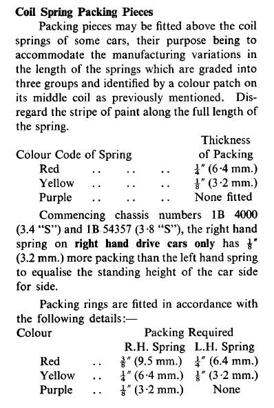

Firstly the factory matched up spring sets for what model they were to be fitted to with paint like this. Blue, Yellow, Red etc.
Then the factory matched up spring sets for equivalent spring rate etc. They should be colour matched on both sides of the car. See the rest on this colour coding on the centre coil in the below snip. (Sometimes require to remove covering tape if still present.)
Coil spring packing pieces ~ front:
No such data is provided for the rear spring packing pieces. It is suggested that only red & yellow were used to identify rear springs. The above pic proves this wrong. Maybe corrected in a later manual. JCS has however covered partially above.
Rear springs:
Packing pieces from what I've read regarding LHD vs. RHD are to accommodate typical loading, manufacturing variances & camber of the road. This does not quite gel with what Jaguar says above as regards camber of the road.
