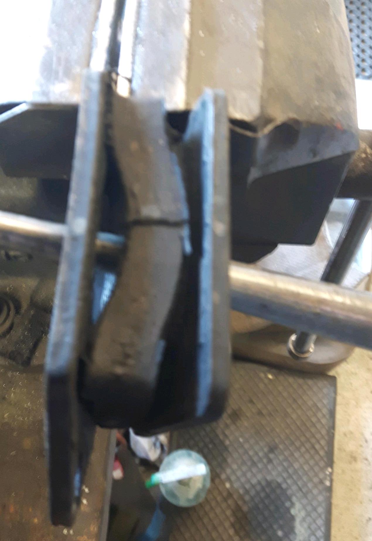

With reference to the sandwich front mountings on page 1, I checked mine whilst I was under the doing an oil change and found mine are coming apart. They are only 2 years old, I think I fitted the cheaper pattern parts offered by the usual suspects. Going to order the more expensive genuine parts tomorrow and see how long they last.
Re: front wishbone rebuild
I have mentioned it before Nigel but I was told recently that there is not as much actual rubber in the mounting blocks as there used to be due some EU law that says they have to have a certain amount of biodegradability. Hence they do not last as long these days. Poly bushes are the way to go if they make them for the sandwich plates.
Posts: 523
They maybe not as good as they used to be but this is not acceptable, I've just replaced mine this time with genuine parts from D. Manners that came in Jaguar bags. The photo is a mount only two years old, sorry for the bad quality pic.

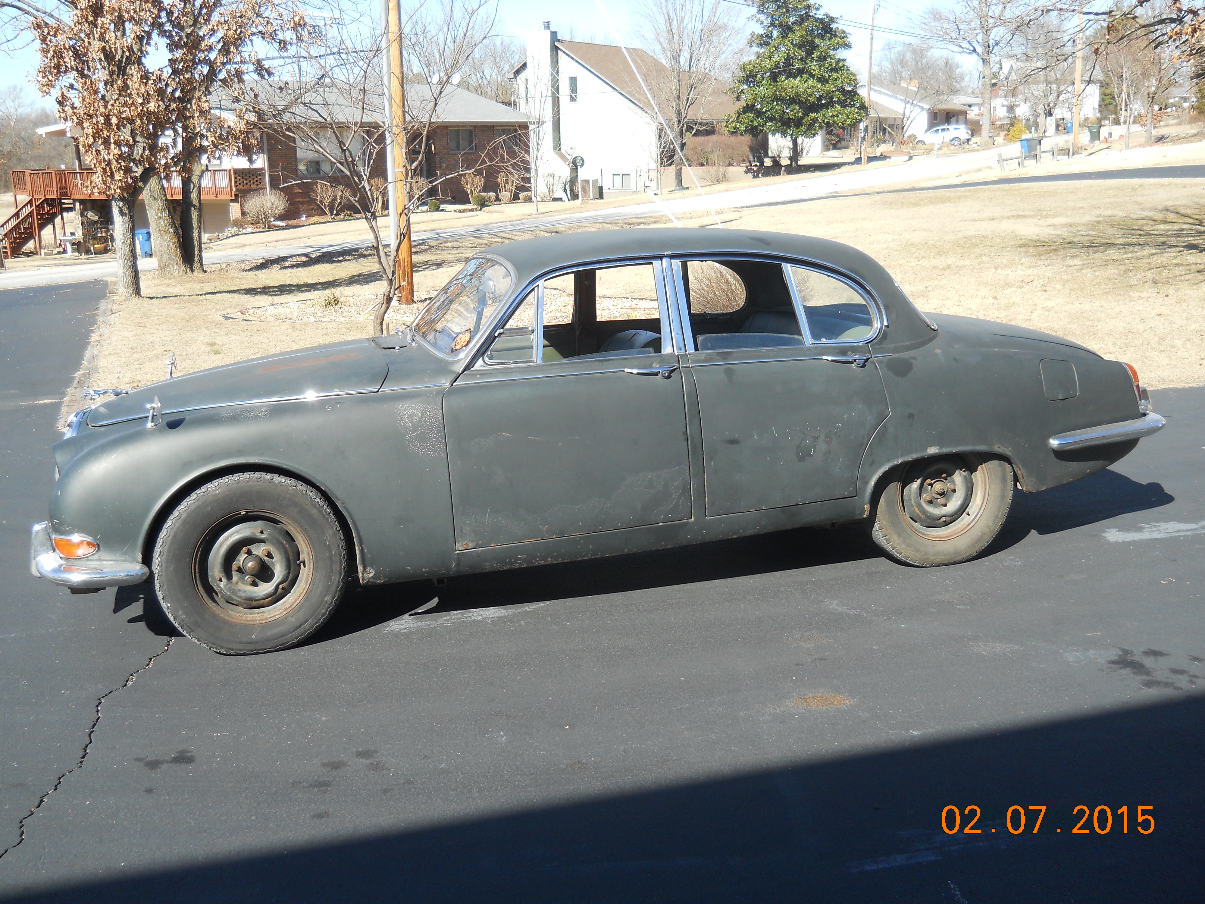

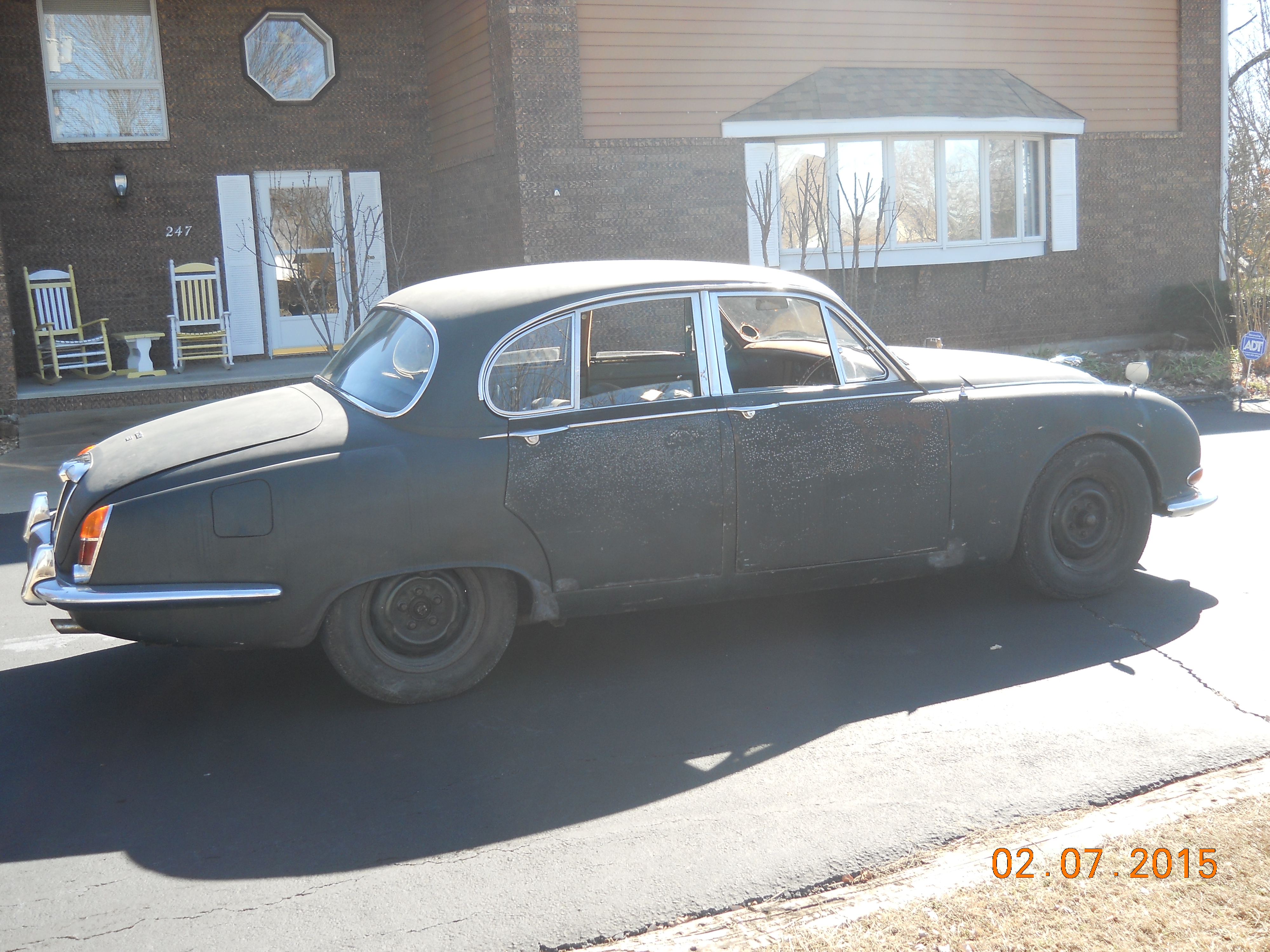

I am late to this party...but here is Miss Kitty in original condition, untouched. I cannot measure, because she is in a thousand parts. I think she is ppppperrrrrffffeeecccttttt
