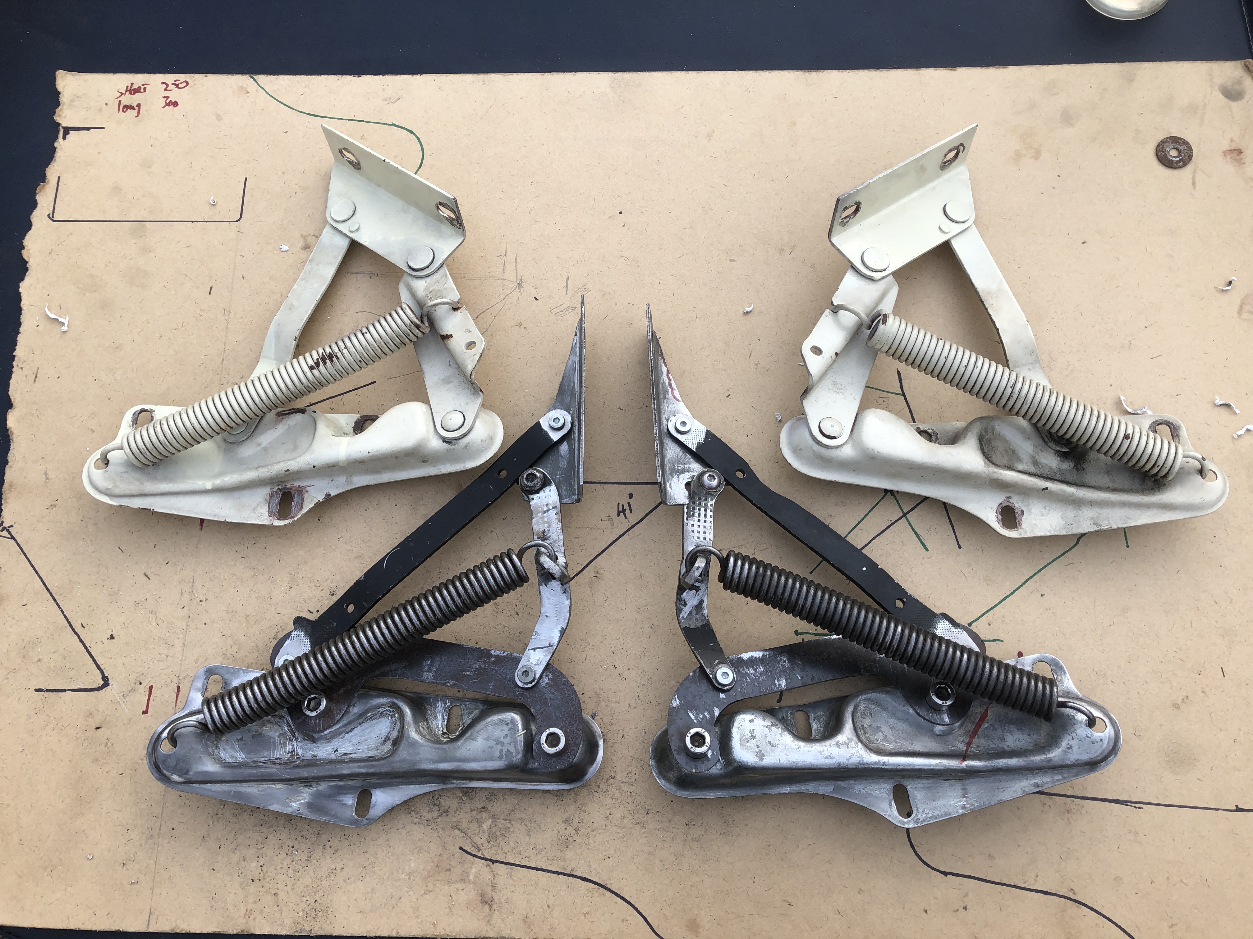

Thanks for the suggestions Norman. As the weather is warm I have been working on this for a couple of days now.
I think lengthening the front arm only makes the back of the bonnet drop and come into contact with the top of the heaterso you are right about lengthening the the rear arm at the same time to raise the bonnet. It is getting the angles correct and is not easy.
At the moment I am working on a different set of hinge lever arms with an additional bracket. Looking at the bonnet what you require is for the initial lift of the bonnet to not only lift the front but to also lift the back lip of the bonnet up in the air or slide it forwards otherwise the back lip of the bonnet will connect with the weather strip and scuttle. I have a set of BMW hinges with gas struts which operate in the correct angles but trying to them get these attached to the Jaguar inner wings creates a problem.
I have a friend who can plasma cut 5mm steel so I made up some drawings for a plate based on the angles of the BMW hinge and the Jaguar body but before I had them cut I made some up out of Plyboard and did a trial fit. These did not work (Too big) so I have just spent all day trimming and cutting to try and get these to fit. The thing is you need to use the Jaguar bracket that sits against the inner wing and the "L" shaped bracket that bolts to the underside of the bonnet and what goes in between has to line them up correctly. The other thing is there is not a lot of room on the left side (Passengers side for UK vehicles) because of the heater box. I would also like the hinge to use the original springs rather than struts so it looks fairly original other than it lifts up to 90 degrees.
Believe me it is not easy and the number of times I thought I had it but then something would get in the way and I have yet to even try fitting the bonnet to my new hinge design.
So at the moment what I am looking at is a plate that sits between the Jaguar inner wing bracket and a new set of lever arms that attach to the "L" shaped bracket that in turn attaches to the bonnet. The plate lifts the starting point of the lever arms up meaning the bonnet lifts as it should off the back of the weather strip initially but then is able to go beyond 90 degrees without the back fouling the heater. The tricky bit here is not getting the bonnet up but to get it to sit back down flat without the new lever arms getting in the way.

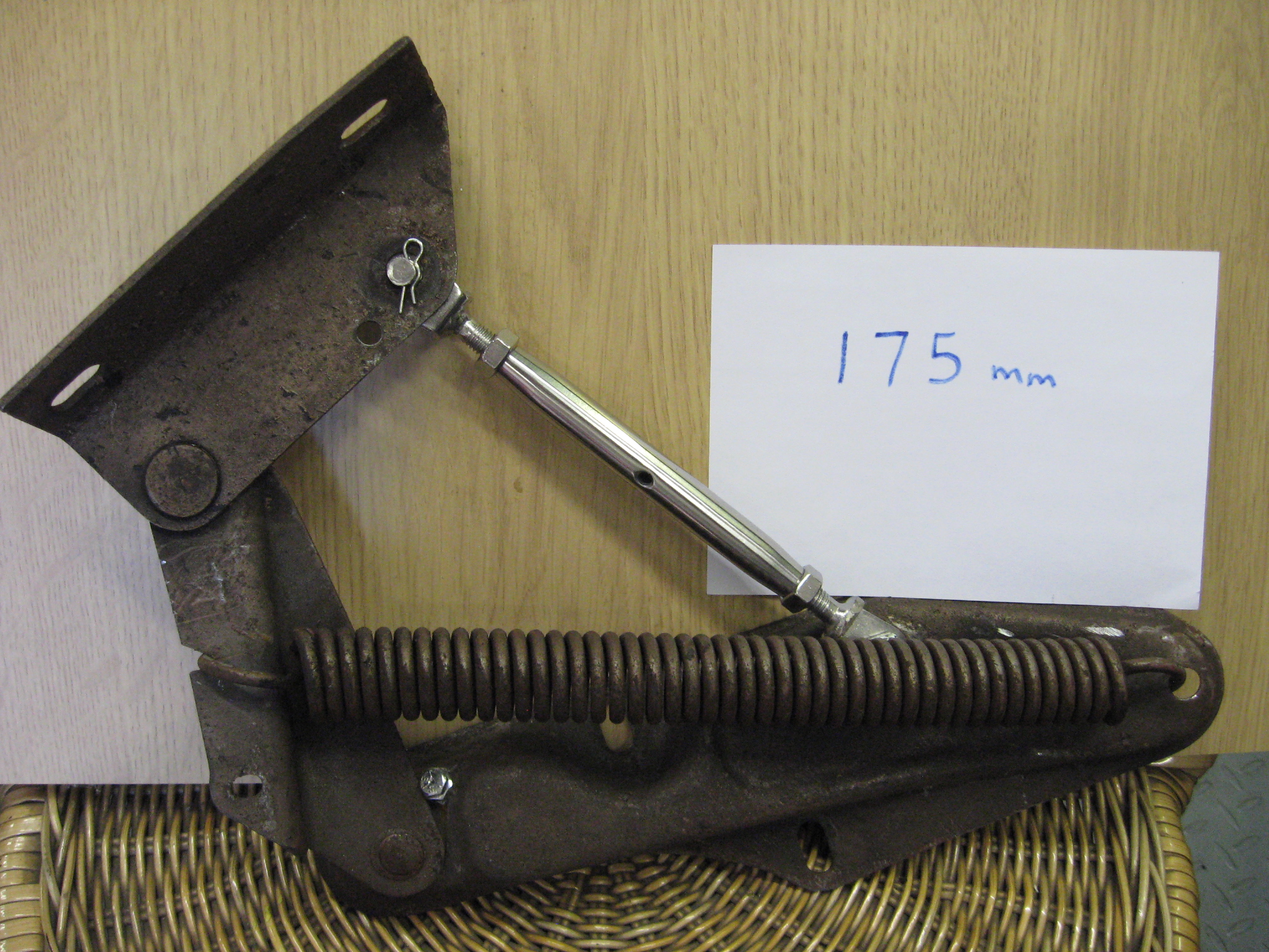

I hope I am successful in posting these images. One shows the turnbuckle centres at 175mm, identical to the original front link centres. In this situation I have used a bolt for a temporary stop for the rear link to stay vertical. Note the assembly is tilted in the image but the rear link is actually vertical.
The second image shows the turnbuckle at 245 mm centres still with the temporary stop fitted.
I understand your finding in regard to the problem of fouling the heater. I think you will find that if you retain the rear link at the vertical position not only is the bonnet raised but importantly it is held to the rear and appears to me to have a chance of missing the scuttle drain channel. I will look forward to your experiments, I would like to see the bonnet opening improved for sure.
One advantage of using the turnbuckles is that they can be adjusted at any time and that makes it more convenient than fixed links especially for experimental purposes

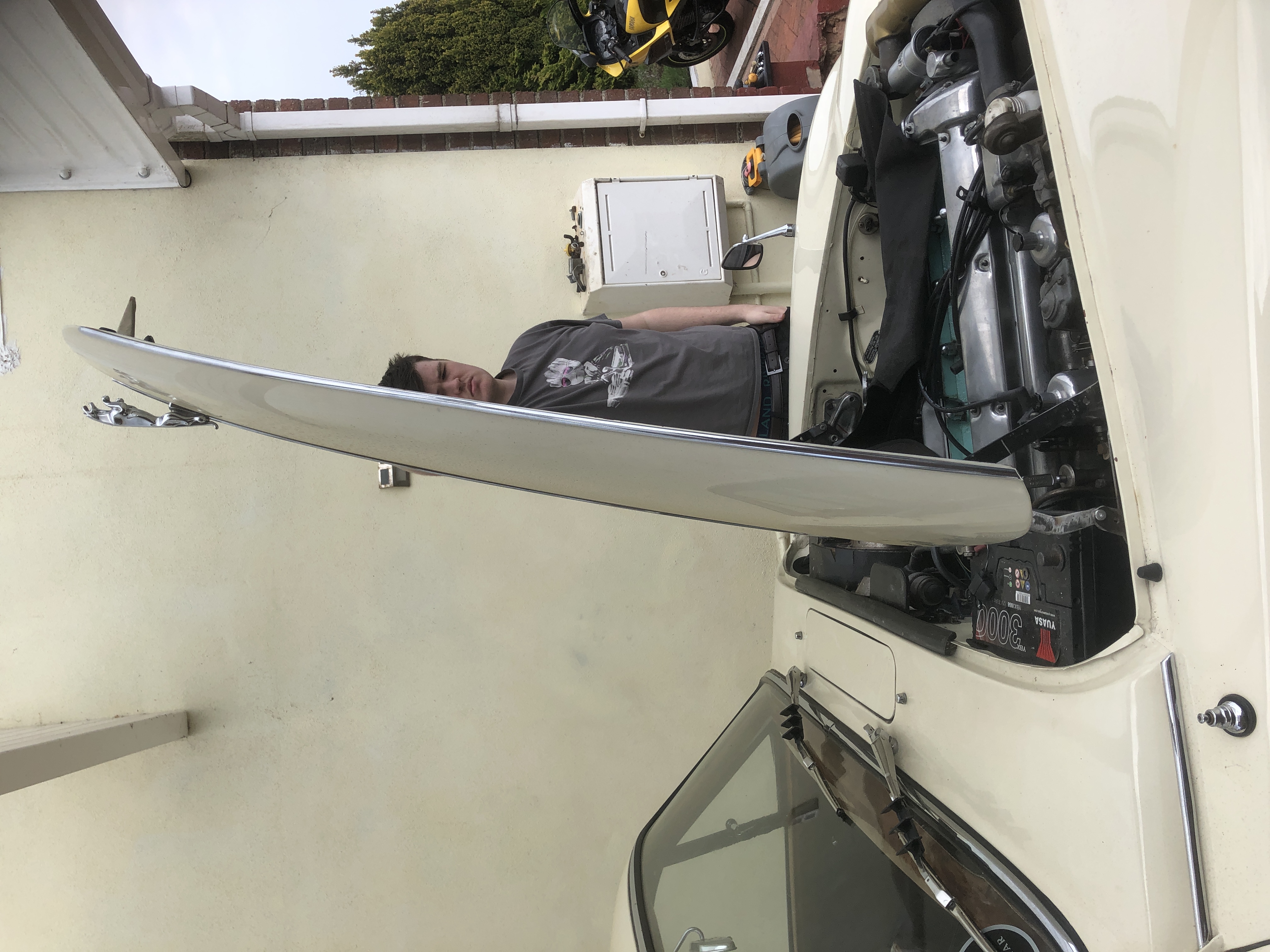

I have now achieved getting the angles correct and it is a case of adjusting the pivot point of the rear lever arm whilst lengthening the front arm. As I said I think I have got it now after 10 hours of experimenting but I will make up a new bracket tomorrow add the holes and offer it up. I will then post some photos.

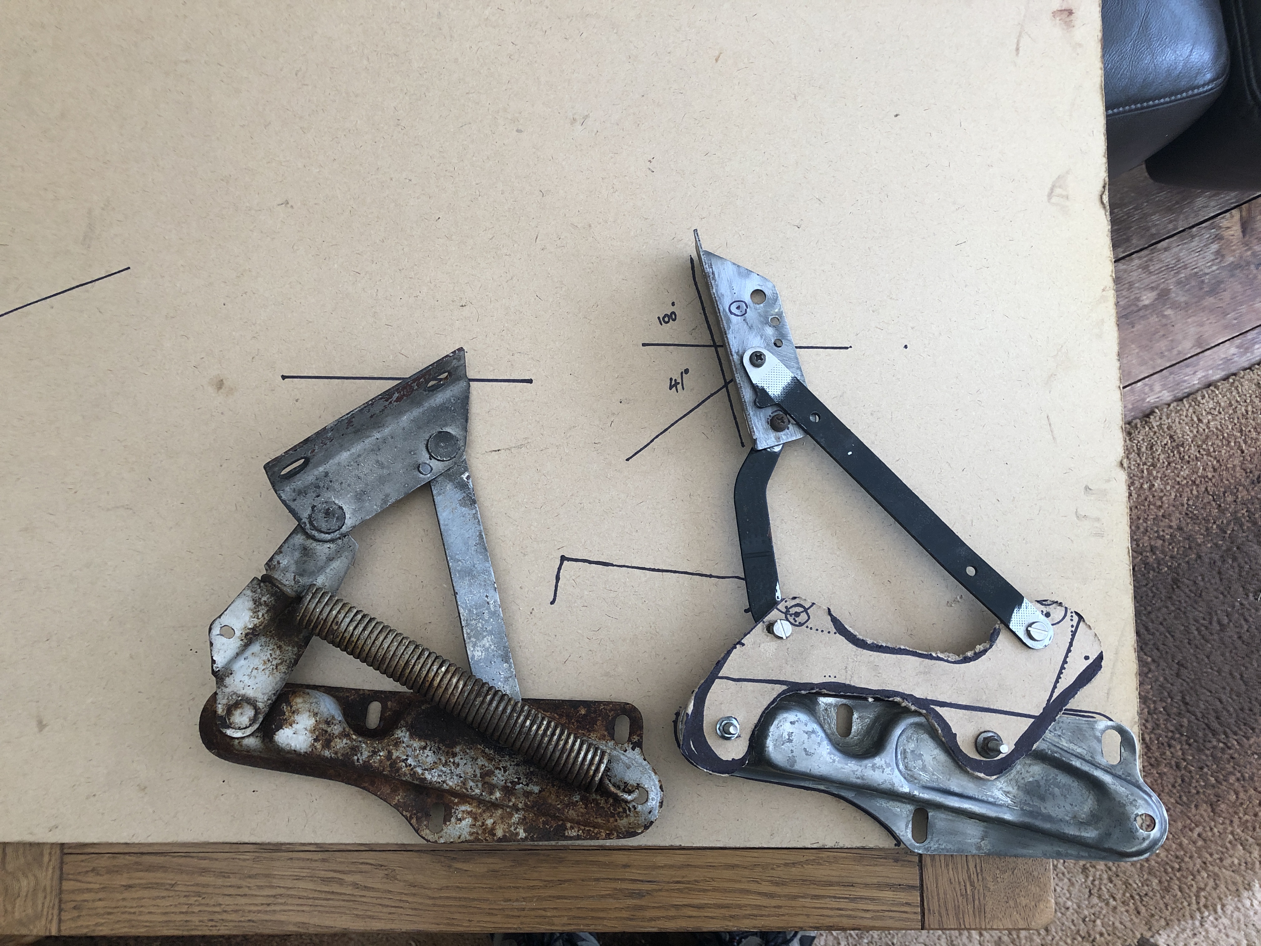

OK this is way more complicated than I thought.
My intention was just to get the bonnet/hood to rise above 45 degrees so if I was working on anything at the back of the engine bay I would not have to remove the bonnet/hood.
Trial one was to remove the stopper rivet leaving everything else as stock. This in theory allowed the bonnet/hood to rise to 90 degrees. Problem was the back of the bonnet/hood drops as the hinge rotates and the back of the bonnet/hood fouled against the heater box stopping it from rising.
I sat and studied the original hinge and drew some diagrams as to how it worked. When the front of the bonnet/hood is lifted the back of the bonnet/hood also lifts to clear the weather strip on the scuttle. Next the rear of the bonnet/hood rotates forward as it lifts increasing the gap between the weather strip and the back edge. Lastly the hinge rotates the bonnet/hood up pushing the rear edge down into the engine compartment. As it rises to 45 degrees there is a rivet that stops the bonnet/hood rising any further at the front but also stops the rear edge dropping further into the engine bay and hitting the heater box. What is required are longer arms to lift the bonnet/hood but are still able to fold in to the gap when closed
There was no way you could use the original hinge to get the result required because of the rotational angles it creates and the length of the arms.
I had a set of BMW hinges which worked in a similar fashion but allowed the hinge to lift the bonnet/hood up to 90 degrees so I studied they way they worked. They work with a ram rather than a spring and were almost flush fit so getting them to fit the Jaguar inner wing was a problem. I really wanted to keep the look of the Jaguar hinge if possible and use the spring which I will come to later rather than a modern hydraulic ram. I removed all the rivets holding the Jaguar hinge together and repeated this with the BWM hinge and to cut a long story short I used the mechanical arms of the BMW with the top plate and inner wing plate of the Jaguar to try and get a rotational hinge that worked.
I used a cardboard sheet to map the rotation of the hinges using different reference holes when the hinge plate was in place to get the right lift and rotation. You can see the difference between the original hing on the bottom and how I was able to lift the hing in the top diagram. I made an extra plate that bolted to the inner wing plate of the Jaguar out of ply board which allowed me to play around with different hole positions for the arms. A couple of days later and after lots of adjustment I thought I had the perfect set up and offered it up to the car. I made a template of the back edge of the bonnet/hood out of plastic which allowed me to use the hinge and see if I had all the correct heights and rotation then I fitted both hinges and the bonnet/hood. All seemed to work so I made the plate out of some 3mm steel I had lying around and then considered how I was going to fit the spring.
The thing with the spring on the original set up is that it allows the bonnet/hood to be lifted with assistance. The spring is stretched as the bonnet/hood is closed and contracts as it lifts but it also cleverly holds enough tension in the closed position to hold the back of the hinge down against the weather strip. I tried to fit the spring in the same orientation as the original but found two things. If it was not set correctly it would not hold the back edge of the bonnet down on the weather strip and if you got it slightly wrong the other way the back of the bonnet/hood would not lift when you opened the front edge up. I looked at using the hydraulic ram but with this in the correct position to push the bonnet/hood open it also tried to push the back edge up when the front was closed down. The ram was not going to work.
I am now working on a way of getting the spring to do as it should using levers attached to the levers. All very fiddly and possibly a lot easier to do these days on a 3D CAD program which I do not have rather than trial and error which is what I am using.
I am of the opinion at the moment that it would have been easier to have redesigned the heater box so the back could drop into the engine bay without fouling it than redesign the hinge.
Still working on it along with other things but the way it looks at the moment I would defy anyone to try and copy what I have done so far.
