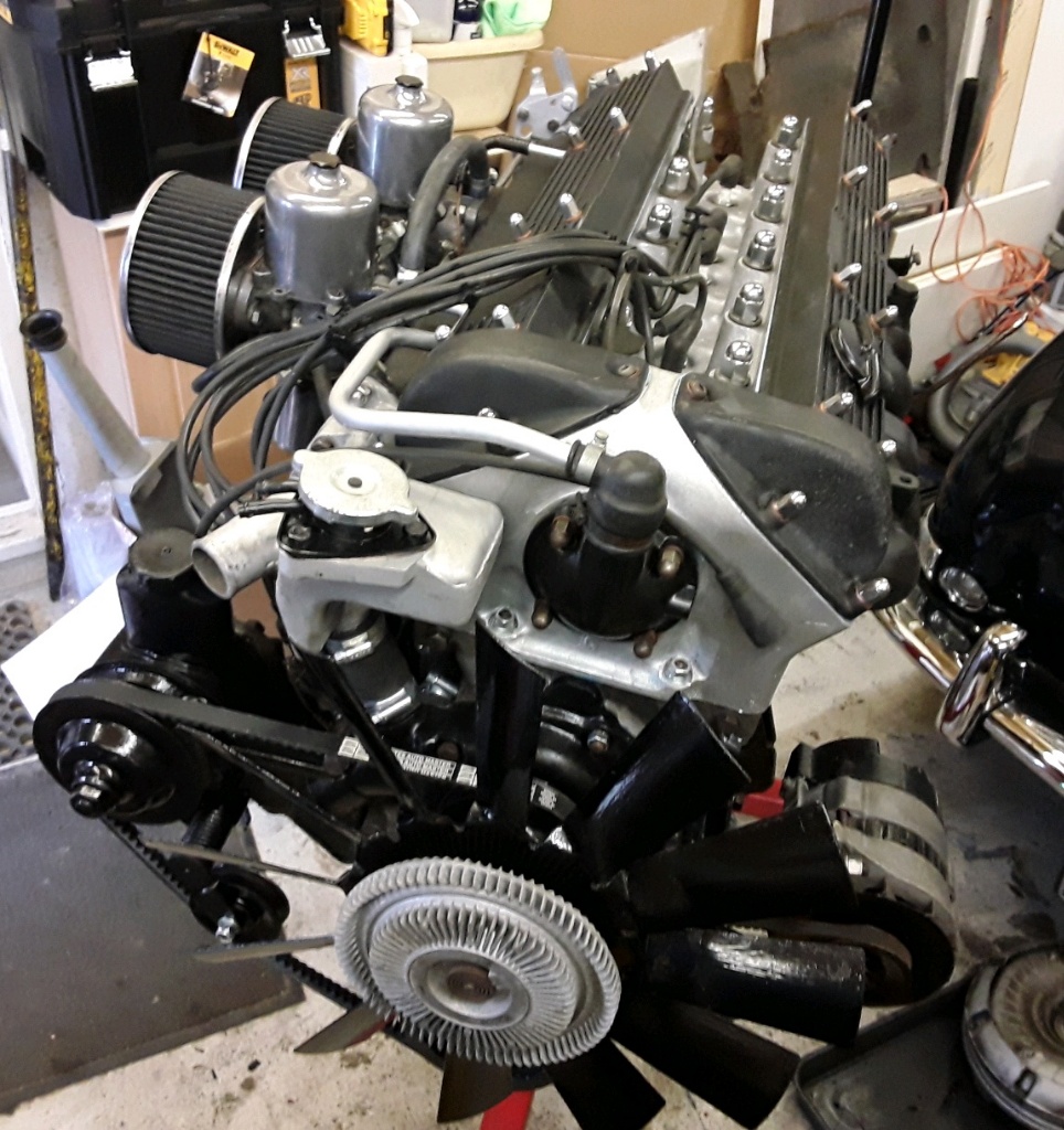

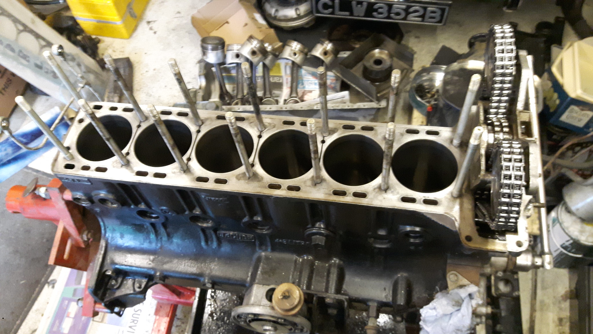

Update on the engine. All back together now, I found a sticking inlet valve when doing the tappets so was replaced, nothing else caused concern.

Re: XJ6 Engine Problem
It's good to see it back together. Looks really tidy, too. Nice job. :)
Very nice Nigel! I like the way to make it even more S Type related you have the S Type in the background with the bonnet up.lol.

Thanks chaps, lots of hours work on it! Still got to look at the auto box yet and the engine bay.
