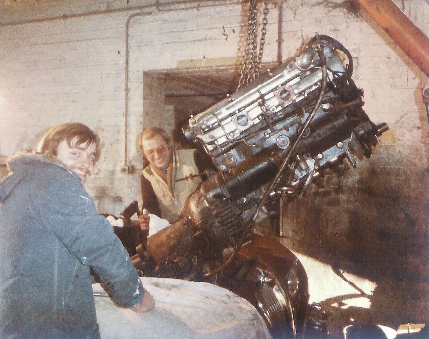

Well you can see the Lucas starter fitted to my car from new on the RH side photograph of the engine out of the car. It does not resemble the ones on your Lucas parts sheets. It is the inertia engaged type but does not have part number 271919.

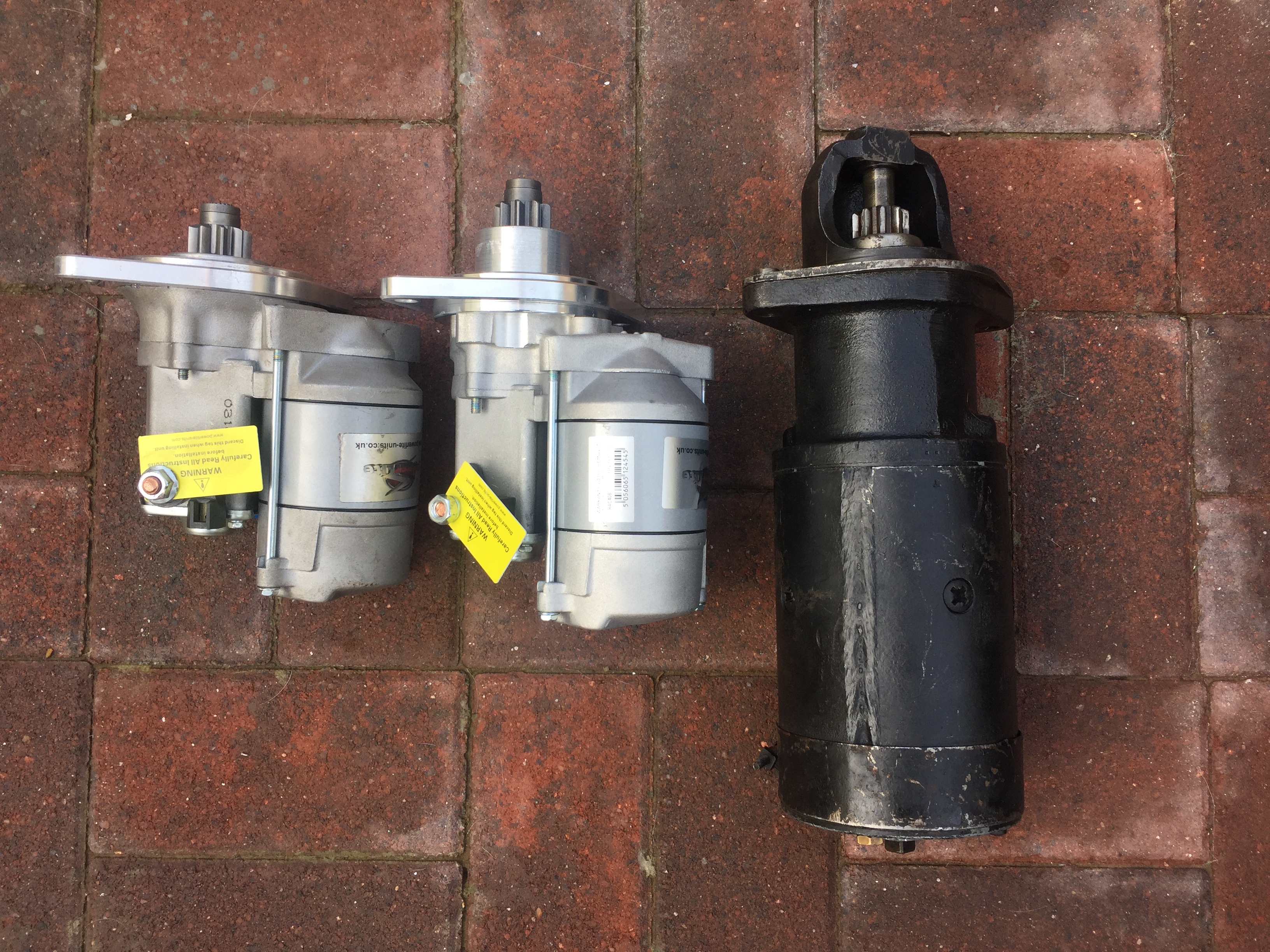

John there is definitely a difference between the MOD and Auto starters but the difference as far as I am aware is with the depth the starter goes in to the side of the bell housing. The MOD is shorter as the flywheel is closer to the engine block than the gear ring on the Auto. You can see here with these comparison photos. The first shows my old Auto starter next to a new MOD starter and the difference in length of the spindles and cog.
The second photo shows the old Auto starter then a new auto starter and at the bottom the new MOD starter. I have these photos because the company sent me the wrong MOD starter to begin with and although it bolted on to the side of the engine the teeth on the cog were no where near engaging with the gear ring.
The last photo is of a MOD Jaguar Mk2 starter motor and I assume this is the one you have. I can imagine this would be a lot easier to remove as it appears to be smaller and does not have the hood over the cog so it is more maneuverable to get in and out.

Rob. Is the Flexplate carrying the ring gear the same spacing between a DG250 & a Model 35 vs the starter motor?cass3958 wrote: ↑Tue May 04, 2021 10:32 am John there is definitely a difference between the MOD and Auto starters but the difference as far as I am aware is with the depth the starter goes in to the side of the bell housing. The MOD is shorter as the flywheel is closer to the engine block than the gear ring on the Auto. You can see here with these comparison photos. The first shows my old Auto starter next to a new MOD starter and the difference in length of the spindles and cog.
You might well be correct that John's car has ended up with an earlier than 1962 Mk2 starter motor fitted.
