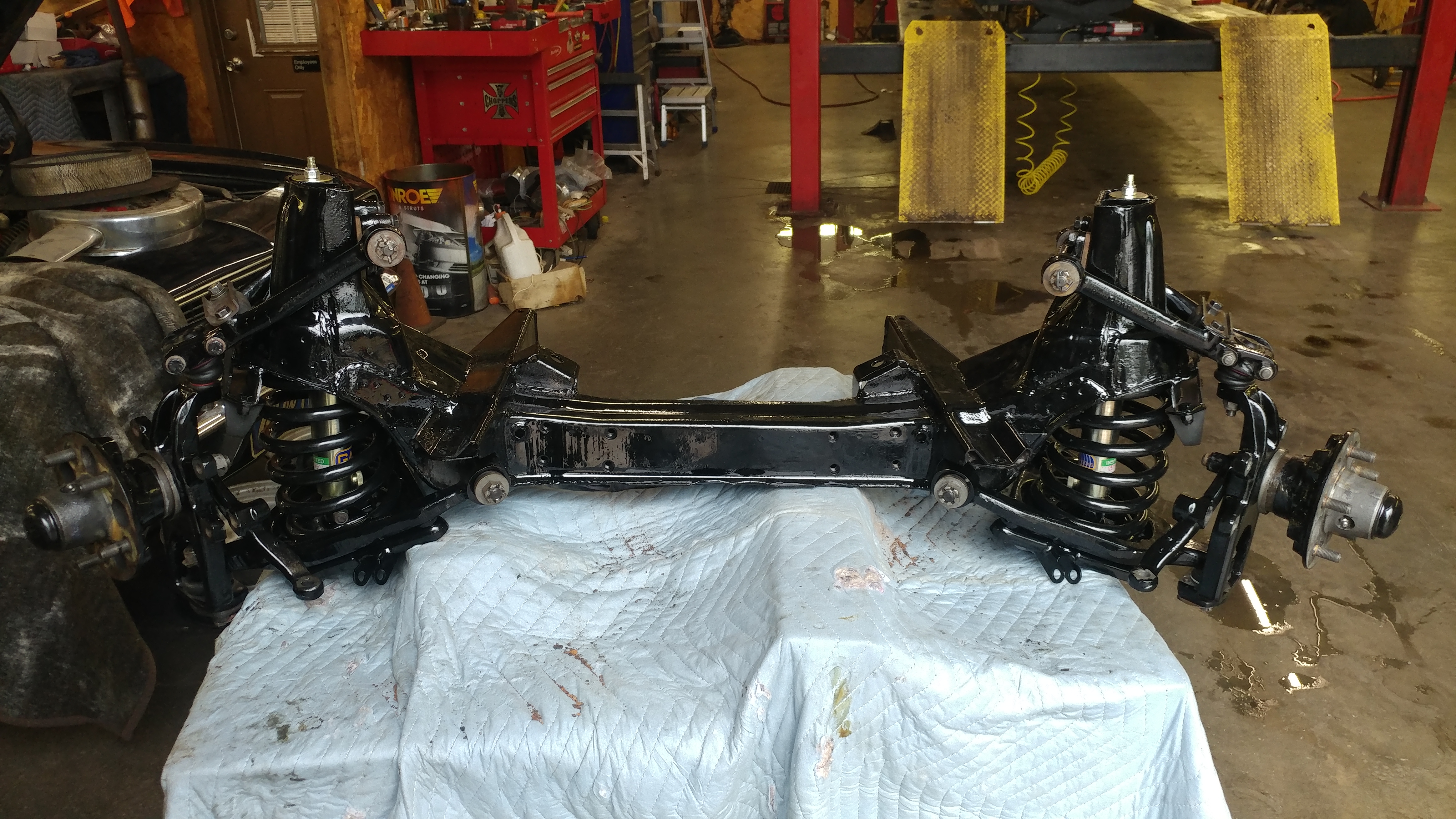

You can do it.....here is mine (not all parts in photo).

I don't know why but we all seem to have a photo of the front subframe broken down and laid out for reassembly.
How sad are we?
How sad are we?

Pretty sad.....I like it better this way.....
Re: Front Suspension Rebuild
I have one of those as well Joe.
