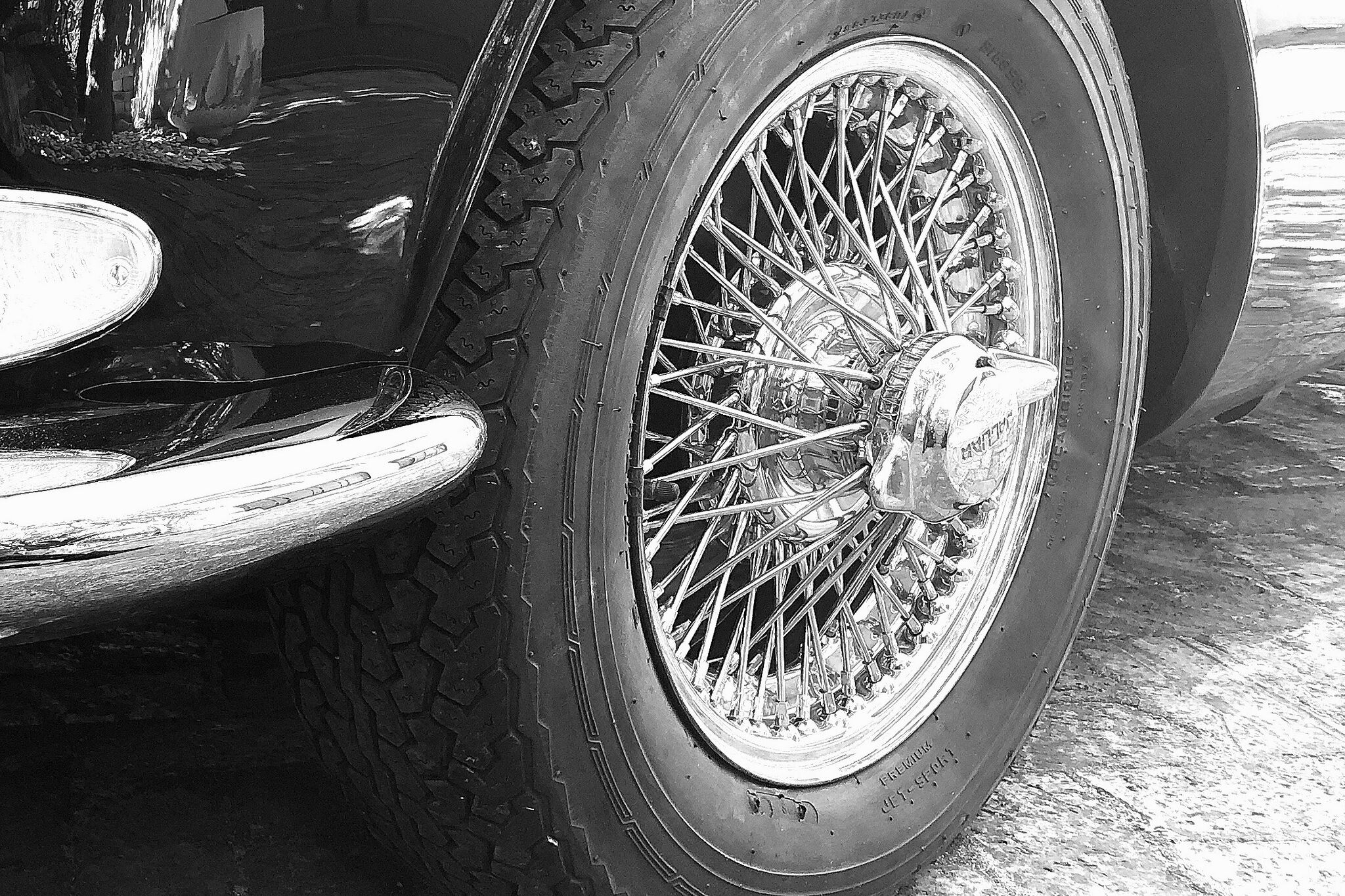

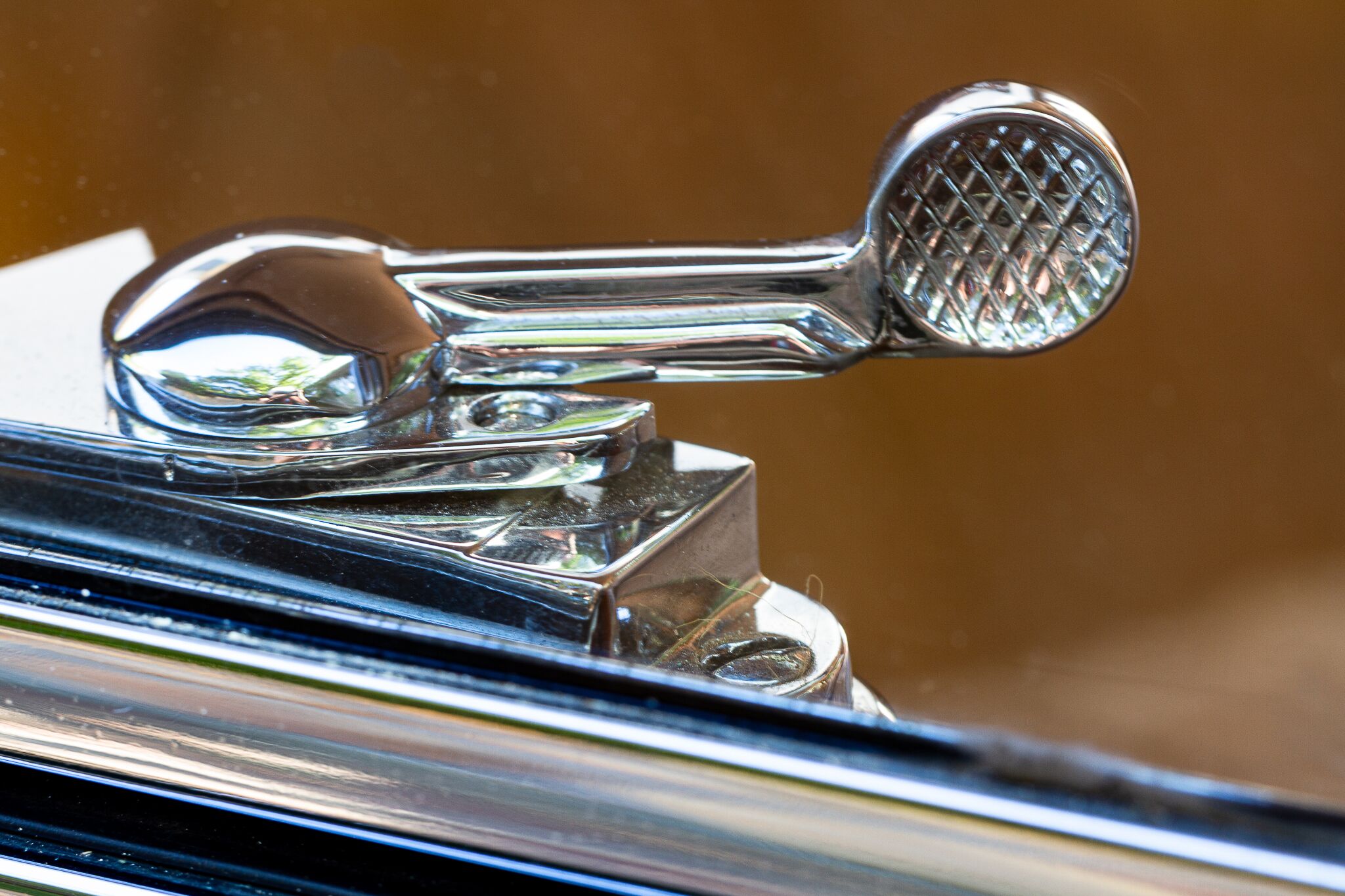

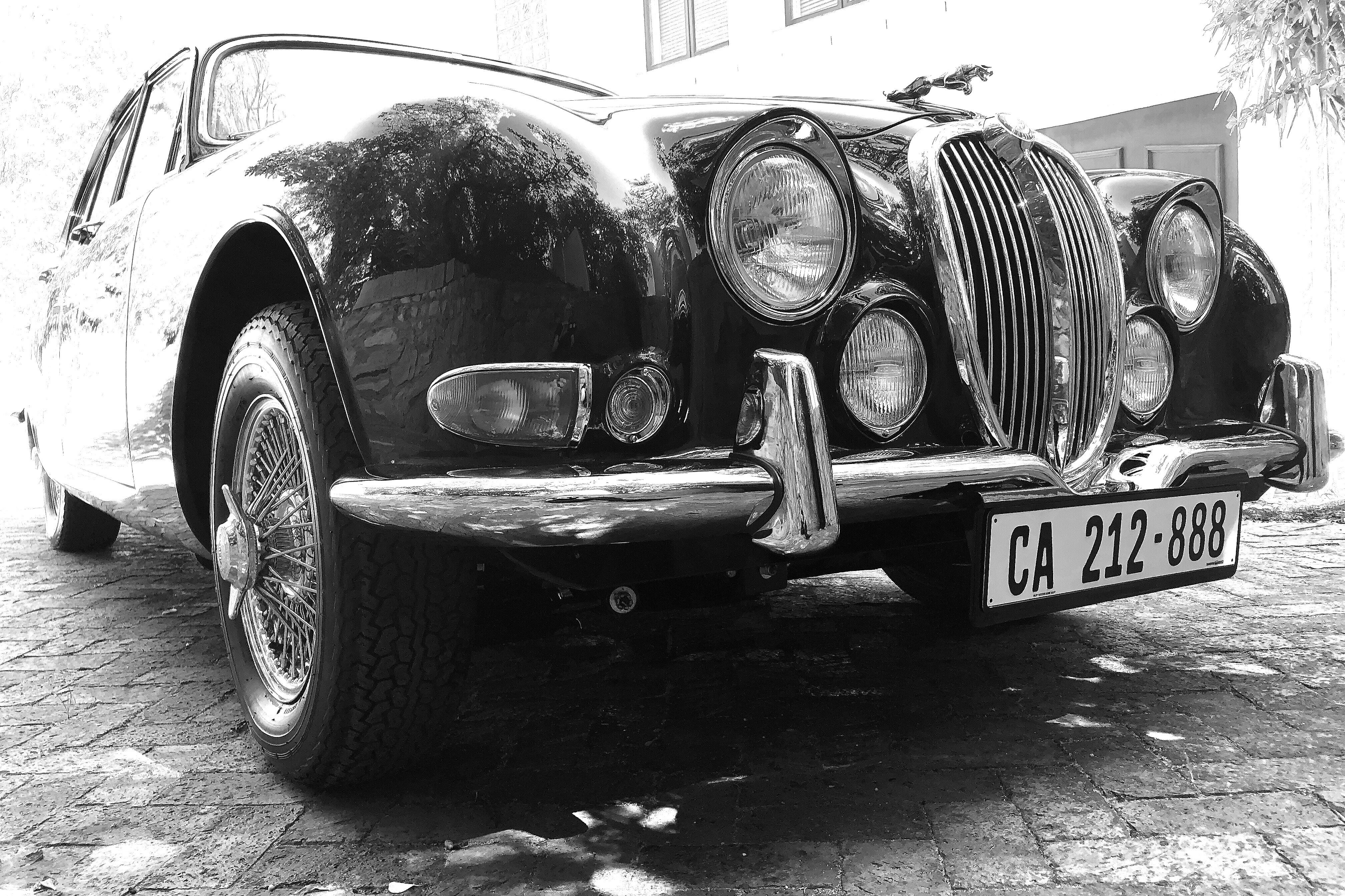

Some arty shots by neighbour.
I thought South Africa banned black and white photos in 1991 when the apartheid act was repealed?
You have some nice photos there Glyn. Very arty and really show off what a good job you did with the car.
LOL! Thanks. Yes it takes close up scrutiny rather well other than the darn African dust!.
Nice pics....thanks for sharing.
Thanks Joe.
