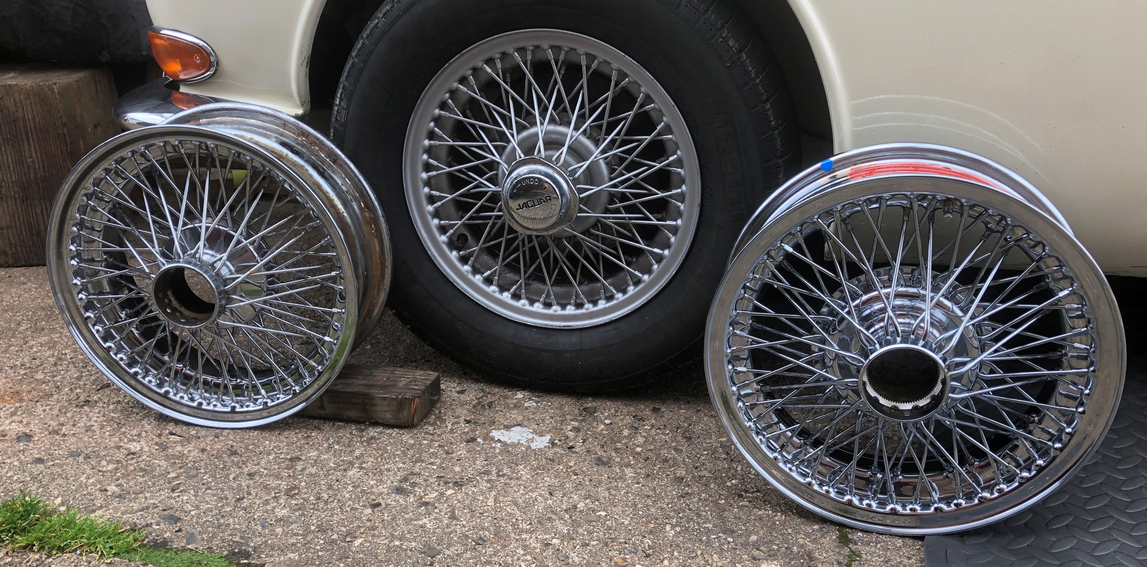

I have finally got the wire wheels for the car and had them fitted.

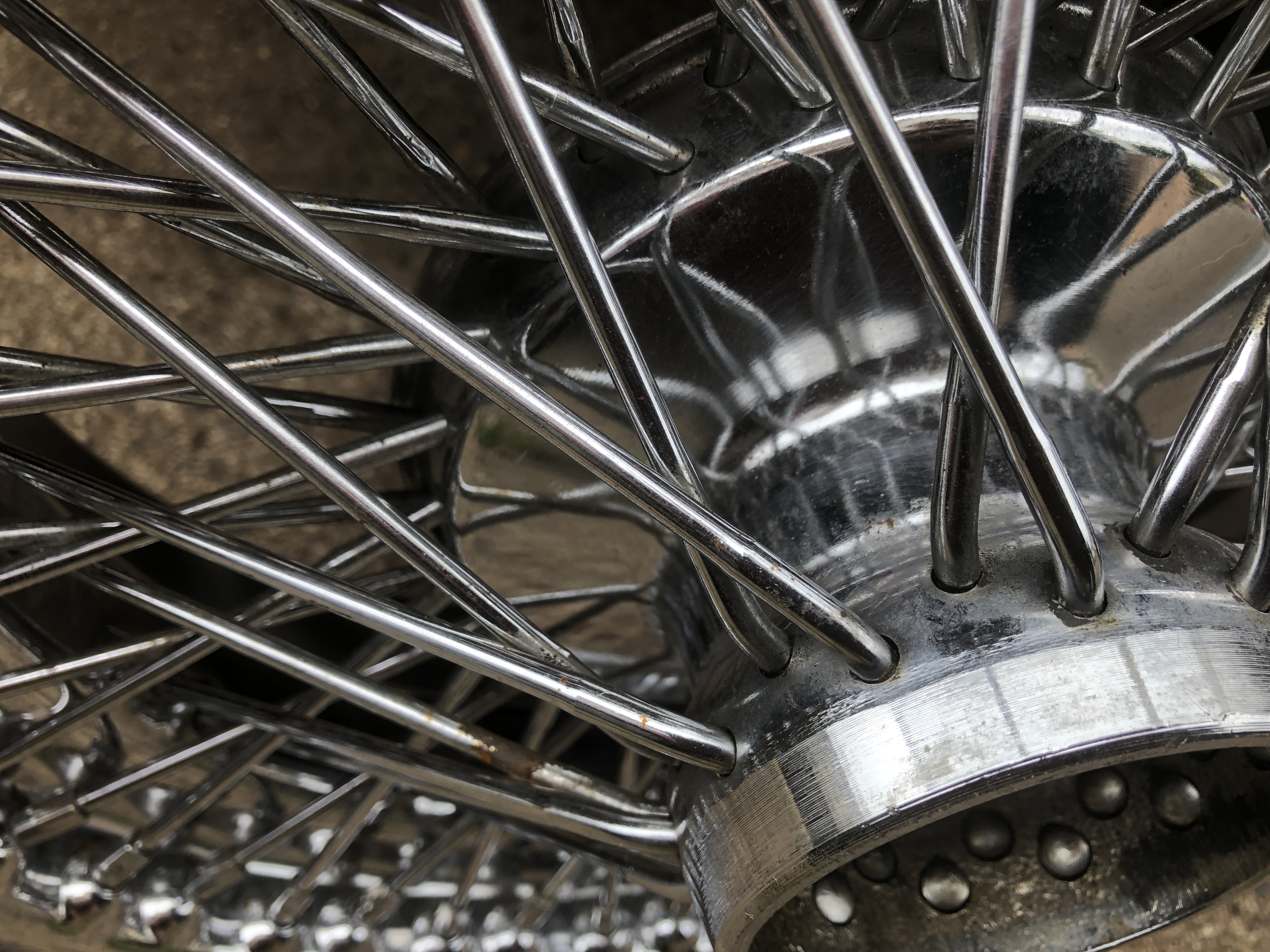

Below are the before and after photos but also a couple of photos showing the difference between an original curley hub, the new shallow curley hub which I have bought and the flat or easy clean hub that was fitted to the later S types from 1967 and the one that should perhaps have been on my car due to its age but I prefer the curly hub.
The three types of wire wheel available. On the left the flat hub. Middle is the original but painted deep curley hub and on the right the new shallow curley hub.

Close up of flat/easy clean hub for later S Types.
Close up of the original Dunlop deep curley hub.
Close up of the new Dunlop shallow curley hub.
The old painted wheel on the car.
The new chromed wheel on the car.

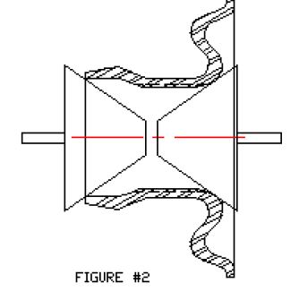

MWS (Motor Wheel Service) UK can supply all you need & I suggest you read their site.
Dayton wheels US can equally supply all.
The biggest difficulty in the change over is setting/shimming the rear wheel hubs. You will have to get shims from SNG Barratts or similar.
Front wheels are dead easy.
Especially read the MWS section on balancing centre lock wheels. Ignore Dayton ~ they are wrong and you will use more weight to balance & have trouble.
Balancing wire wheels 1.JPG (81.68 KiB) Viewed 2748 times
Balancing wire wheels 2.JPG (65.87 KiB) Viewed 2748 times
balancing wire wheels 3.png (255.73 KiB) Viewed 2748 times
Dayton ~ Wrong!!!
Dayton wrong balancing..JPG (21.27 KiB) Viewed 2748 times
Smoothride provides an affordable kit that gets the job done correctly.
http://smoothridecones.co.uk/
The beautiful kit that MWS provides is really for a tyre change shop & endless use where you would ultimately wear out a set of Smoothride cones.
