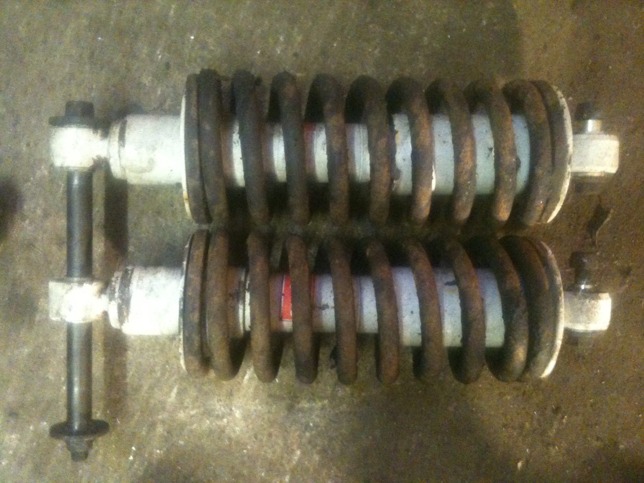

John I am back with my car. Measuring from the centre of the wheel arch to the ground in a direct vertical line through the centre of the wheel from the lowest part of the wheel arch I have 21 inches or 53cm to the ground. This means the top edge of the wire wheel is inline with the lowest point of the wheel arch and all the tyre rubber is hidden. 17 inches if measured at the same point as mine is quite a difference and no wonder they had problems getting the back tyres off.
You mentioned packing spacers on the back shockers but I do not have these as you can see from the photo of two of my rear shockers with springs. You might just have very worn springs on the back causing the back to sink lower. New springs from SNG Barratt part number C23167 are £25.32 and rear shocks part number C22847 are £46.36. Problem is you will need a set of four which will cost £286.72 including VAT. These old cars can become a bit of a Money pit which is why I make mine work for a living.
