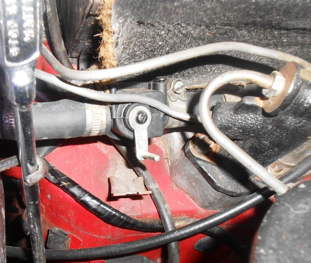

- C19704-Heater Valve components
- 3 C19704-Heater Valve opened.JPG (433.25 KiB) Viewed 4674 times
- 74614 Ford Heater Valve
- 2 74614 Heater Valave.JPG (214.25 KiB) Viewed 4674 times
- On/Off Manual Heater Valve
- 1 OnOff Manual Heater Valve.JPG (274.46 KiB) Viewed 4674 times
