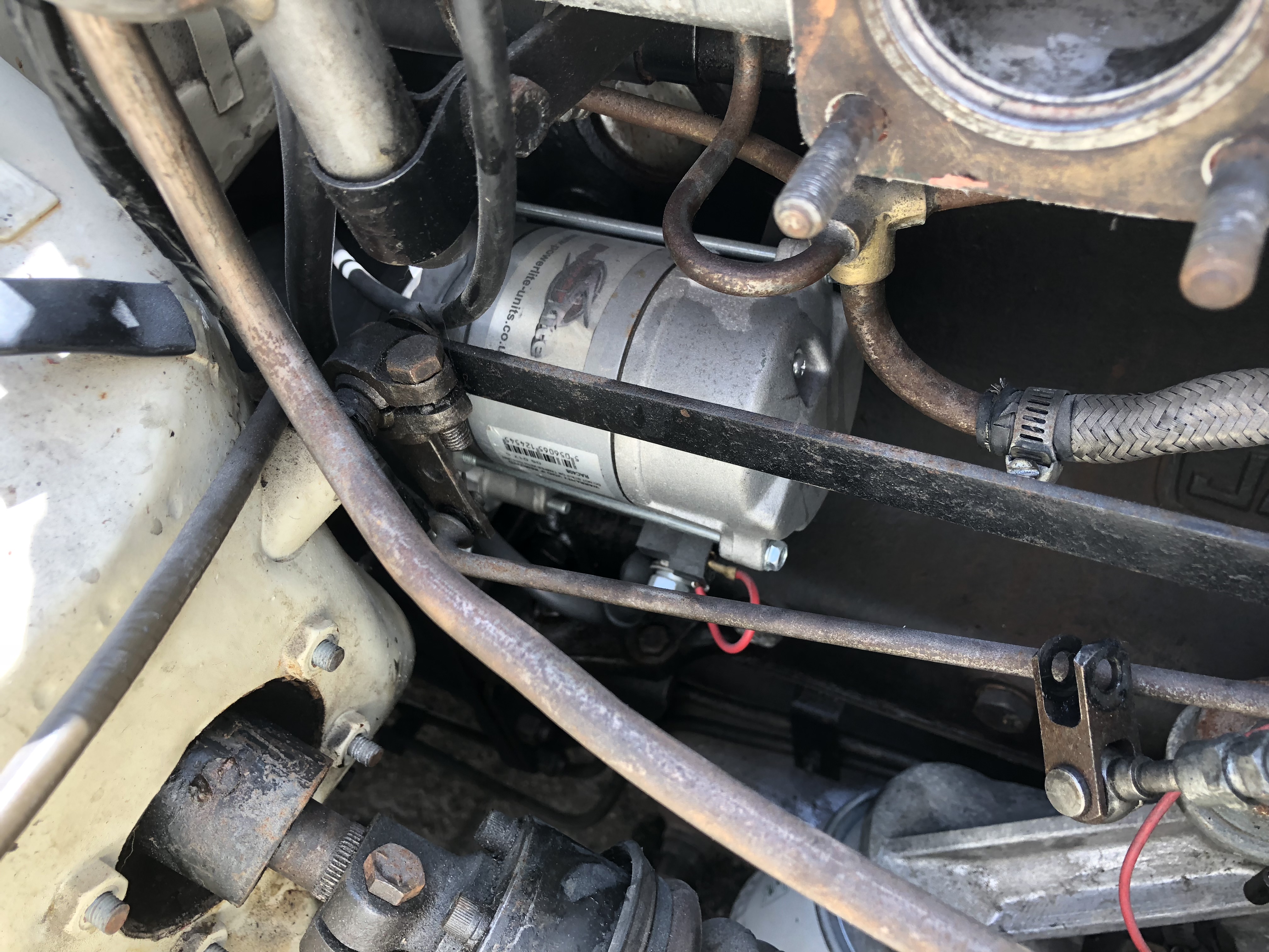

See the photo above. The nut in the photo is facing away from the block and this is where the cable attaches, but it also has the motor on the top and solenoid bit on the bottom.

Below is a photo of my HP starter in position which I took last year when I had the carbs off.

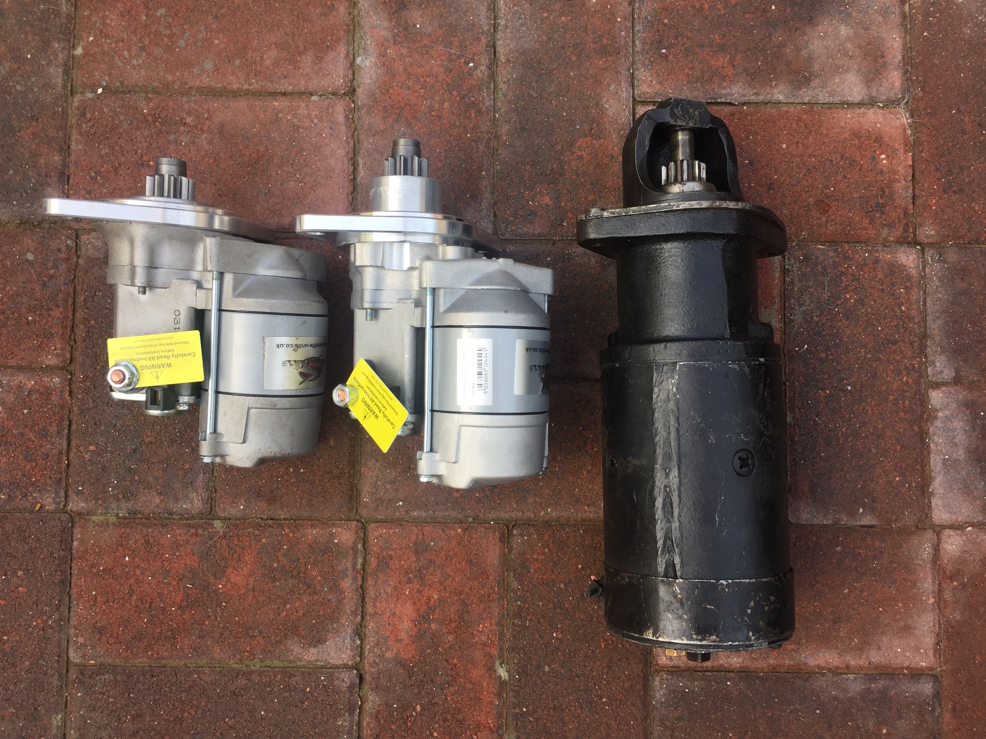

There is also a photo of the old and the new. There is the old original stater then two modern starters one for the Auto and one for the manual. The old starter should be turned with the open side of the hood to the flywheel but the two modern starters are as they sit on the side of the engine with the solenoid sat on the top.

My original starter was an intertia type but same general shape.
On the new one I'd assumed the 'motor' was the drum-shaped bit and the solenoid was in line with the starter cog, so it can pull it in and out. Either way, the way you have yours is what I'd assumed, so it's simply a case of finding out how to get it secured to the car. As you say, a nut and bolt would work as long as I can hold the bolt head in the same way I undid the nut.

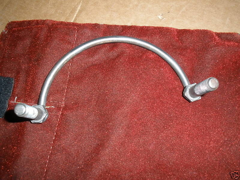

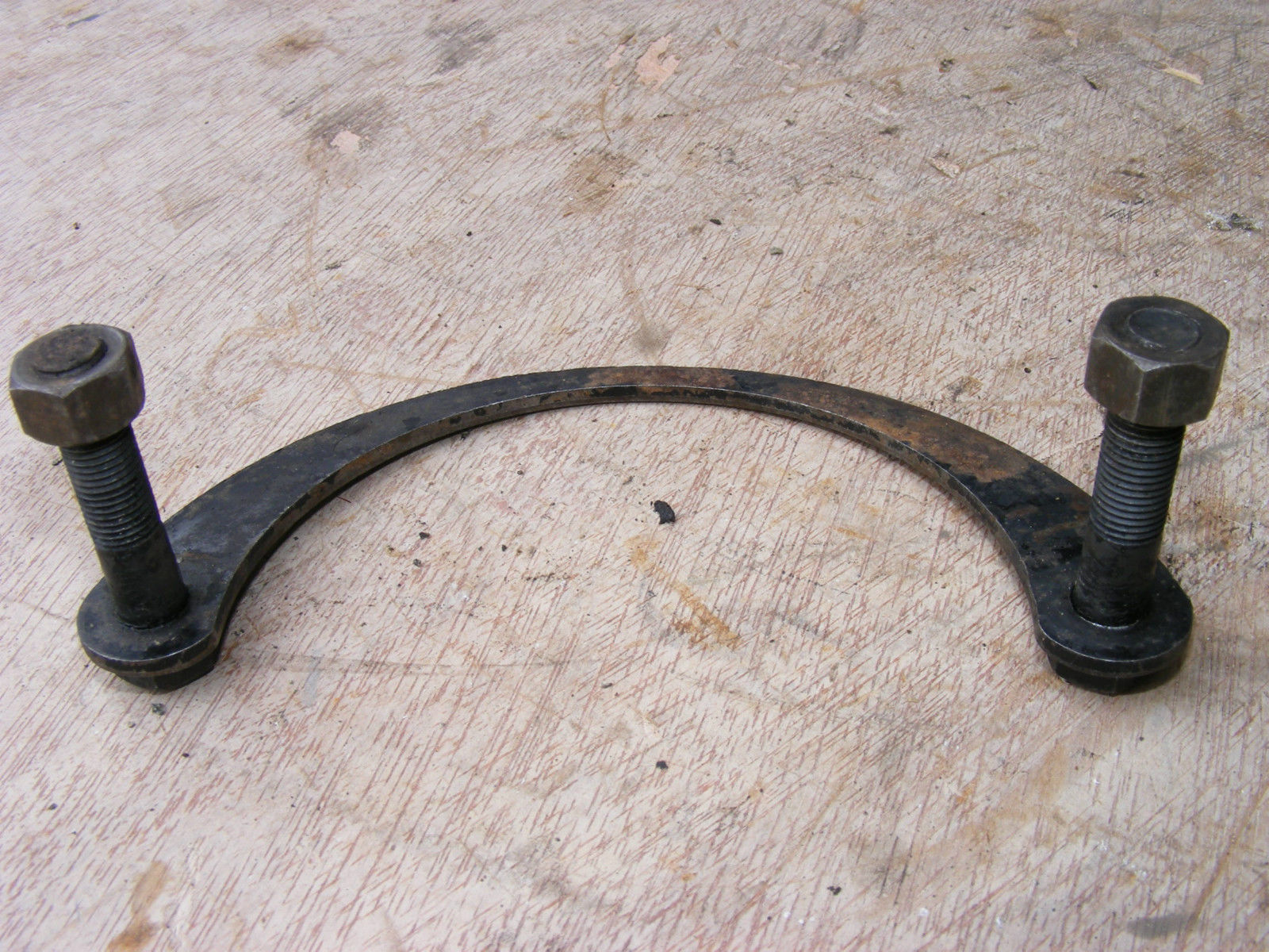

Jaguar did this to get around the turning bolts issue. All later cars. Does this not work Rob? (re your previous post)
Re: 3.4S (manual) Starter Motor
No unfortunately the welded ring does not fit with the new HP starter motor as the ring, no matter which way you try it interferes with the body of the new motor.

Yes ~ I can see that the gear drive to multiply torque takes up space. I wonder if the later slim variety would fit?
I've got the thin band like the newer one in the pic. I will see if I can get it to fit.

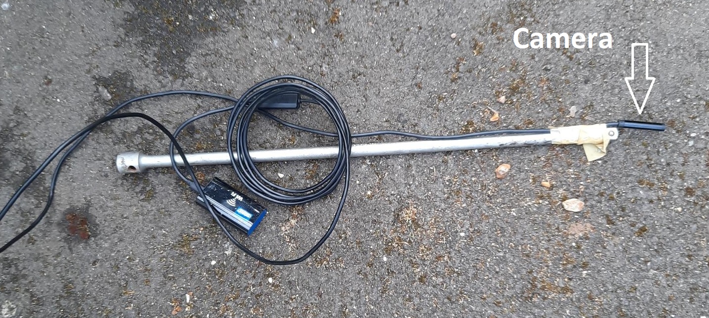

2) Use the band and buy a £20 Draper endoscope. The software that you need to get it working is truly dire and it wouldn't work with my Samsung phone. However, I got it to work with an old(er) Sony phone (after watching a video review on YT) and it was brilliant. You need to hold the camera end in place with something rigid - the flexible cable it comes with is not stiff enough. I used a long (18") extension bar and rested this along the edge of the block and the back of the starter motor. That holds the camera steady. Then, with the nut held in a socket on the end of a couple of long 3/8 extension bars (about 12-14" is enough) you can mate the nut to the bolt end and tighten it up with ease.

I had the thicker welded nut band which is possibly why mine would not fit and I had to resort to nuts and bolts. I said previously it is possibly one of the hardest jobs to do on the S Type solely because of the lack of access to the nuts and the limited space you have to maneuver the old heavy starter motor around. Taking the oil filter off I found was a lot easier than trying to guide it out of the top of the engine and the new light weight motor was a breeze to get into position after I had removed the oil pressure sender off the top of the oil filter housing.

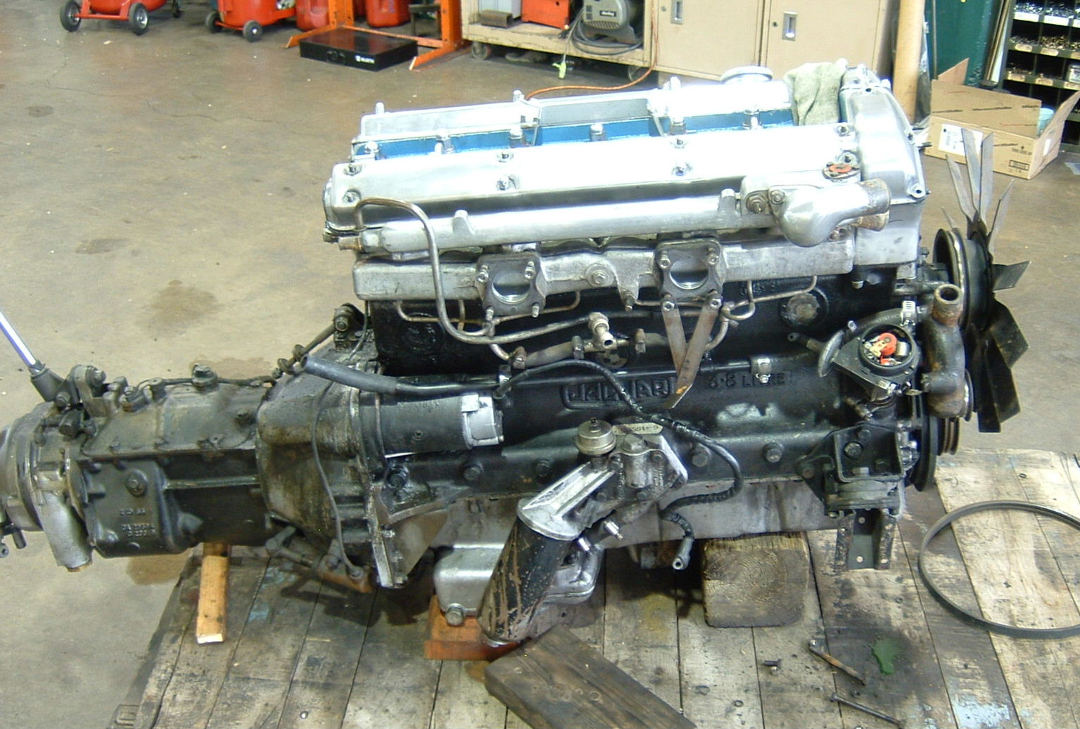

There must be two different types of Lucas starters used on S Types. Looking at the image above it shows one with a narrowed neck next to the mounting flange. Mine, on a MOD car is shorter in overall length and dies not have the narrow neck. Are they different for automatics and manuals?. Maybe the shorted one would be easier to extract and replace?
