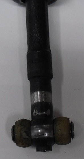

Are you sure that the play is in the steering box and not the steering column. There is a simple plunging CV joint in the column with 2 nylon rollers that wear (5 in diagram). New nylon rollers can make a huge difference. Just held on with a circlip. The UJ also needs to be good.

Thanks for your advice, gentlemen. Play is definitely in the box itself, joints in the steering column seem tight. I'm not sure if they shimmed the box properly when putting it back together. Anyway, I've been driving classic cars all my life, having a little play in the steering isn't an issue. I'm happy to have a leak free steering. Let's hope it stays that way.
