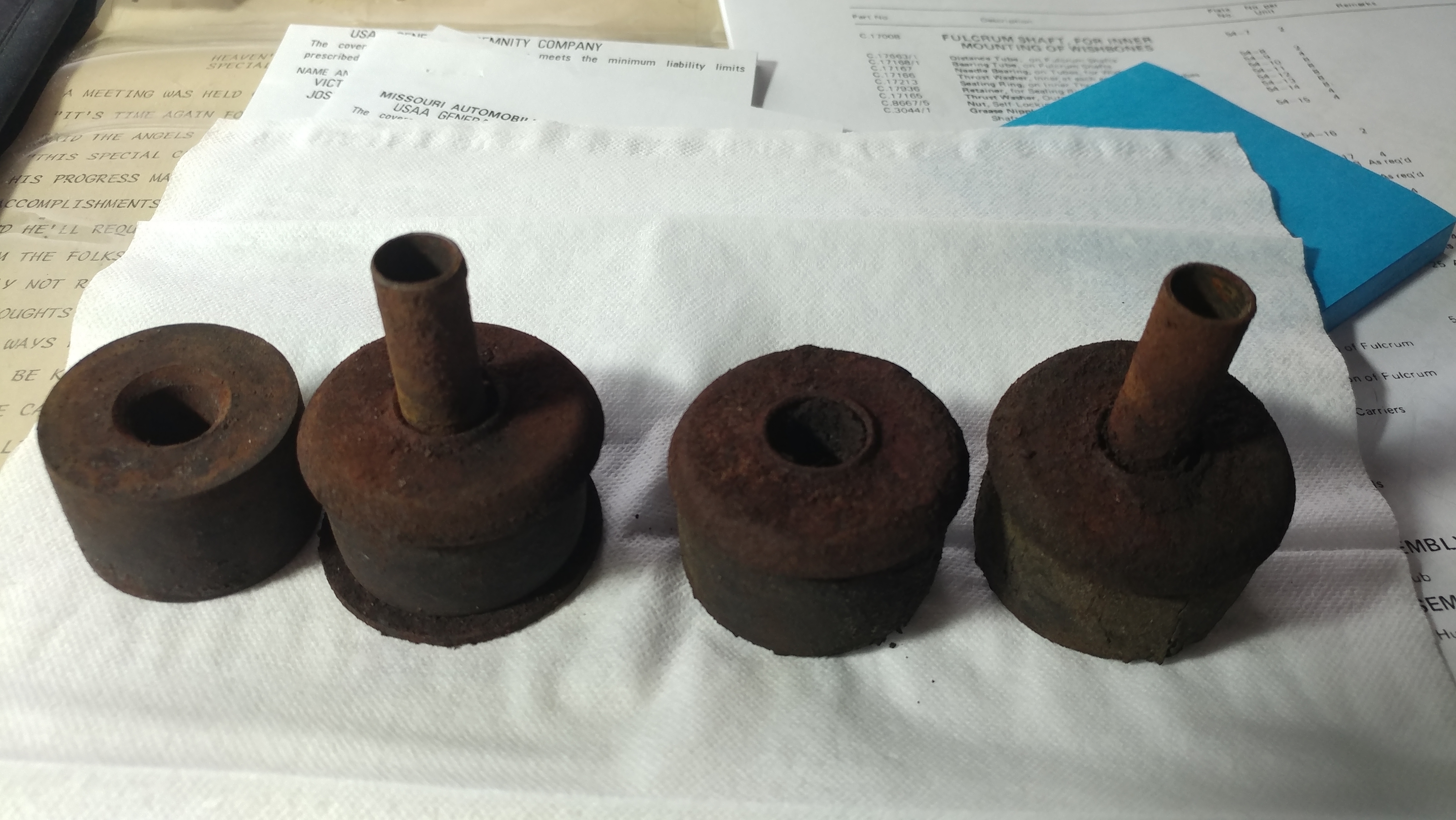

Showing my true inexperience. What are these????? In a bag labeled lower motor mount and cannot find out any info. Part number would be great. I think they are C23559, but where do they get installed. Have no idea where they go.
Help and thanks,

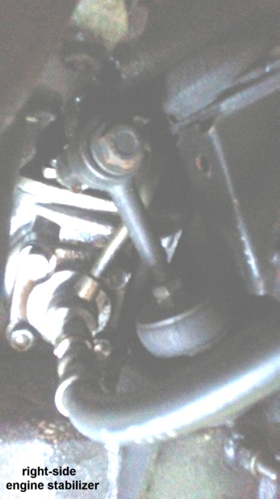

those look like the bottom rubber bushes and washers of the front Engine Stabilizers. You are missing the steel "Banjo" fittings shown in the illustration I posted below.
they mount to the lower front of the engine and to the front of the front suspension crossmember at an angle dictated by the top and bottom brackets.
they are somewhat similar to a Sway Bar LINK. If they are Not part of the engine stabilizers, then they are the Sway Bar Links.
so you should see a bracket welded to the front suspension member on each corner, and another bracket above it bolted to the engine.
here's a picture of the right side engine stabilizer
in my car:
in my car:

C23559 are the rubber bushings or "buffers" for the engine stabilizers.

my car has PAS and the stabilizers. There are no conflicts other than the power steering hose you can see in the picture smack in front of the lower nut of the stabilizer. When I replaced the rubber buffers I had to use three hands. I can't remember if the buffer's part number was superceeded.
