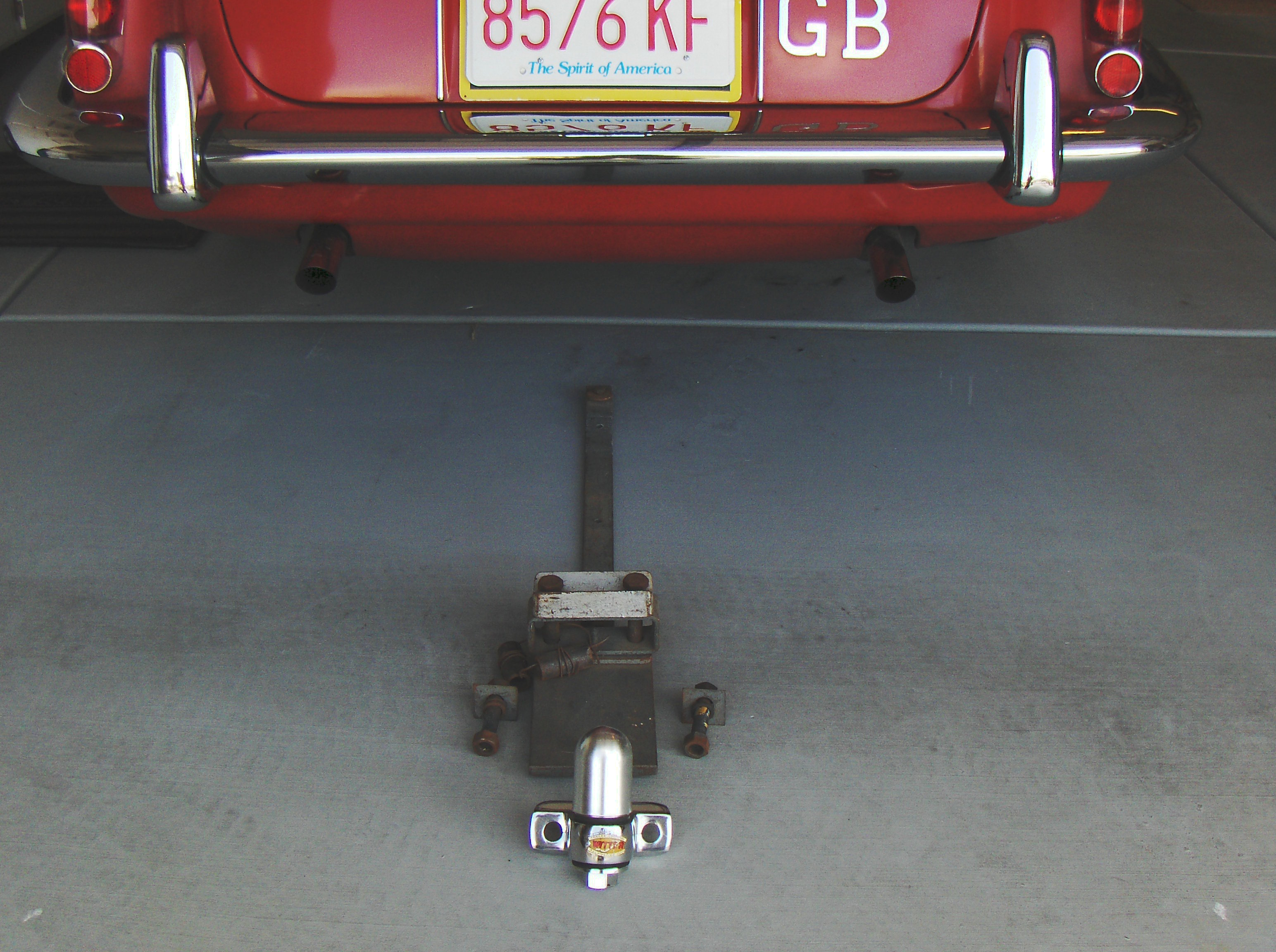

Tow bars were made specifically for the 'S'-type. Attached is a photo of the components. We wrote a about it in Newsletter Vol. 5, No. 3. which you can find is the archives.

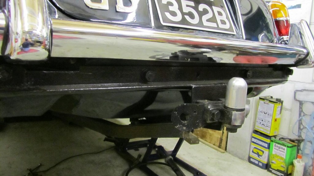

The article on towbars in Newsletter Vol. 5, No. 3 gives most all the information available on the Witter towbar that was made specifically for the ‘S’-type

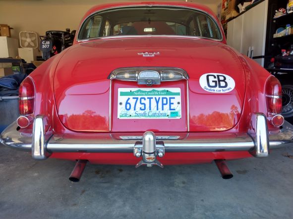

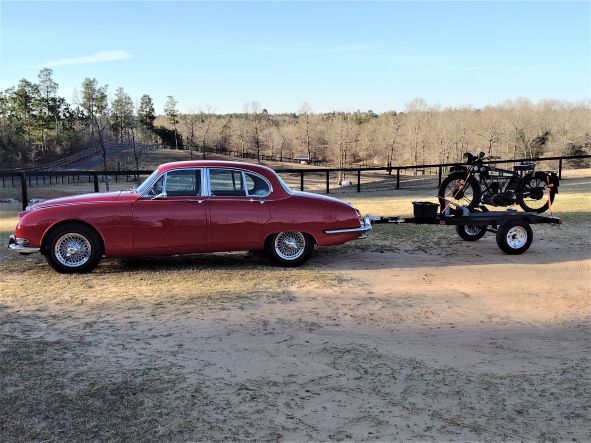

An update: I finally (after having it for 50+ years) installed a Witter towbar on P1B79909DN. I built a trailer for our 1928 BSA (which was a 40-year restoration!) to take it to British car and bike shows. The photos show the hitch on the car, with and without the spun aluminium ball cover. I installed it with just the two ⅝ in. bolts, pads and spacers though the bumper and rear body structure as the bike and trailer weigh only about 400 lbs and the tongue weight is 30 lbs.
For heavy loads, with high tongue weights, the vertical plate and centre bracing bar would be required to keep the bumper from twisting and distribute the load into body.

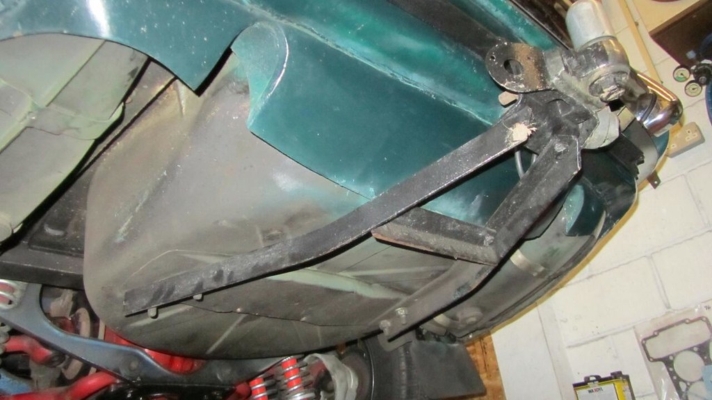

I have a tow bar I fitted to my car many years ago to pull a small caravan. Not sure what make it is as I found it at spares day for a tenner, I think it's part XJ6 and part S Type, I had the fittings that go through the bumper but didn't fancy drilling holes in it so it has an angled cross bar bolted to the rear valance. This was reinforced with thick wall steel tubes welded between the outer valance and the boot rear side. The under frame is bolted to the boot floor.

Modern tow bars are generally attached securely to the chassis legs but yours Nigel is basically bolted to the relatively thin metal of the floor. Probably good for towing small light weight trailers but I would not want to tow another car on a trailer or a large caravan with this attachment. It would put a lot of stress on the boot floor even with mounting plates.
Re: Tow bar
It would be better to secure to the chassis rails but this was all you could get back in the seventies when I fitted it. I had to make a new rear valance the cross bar is fitted to as the panel was unobtainable so took the opportunity to reinforce the whole of the rear of the boot area with 3/8" steel bars welded in place behind the valance as well as the tubes for the fixing bolt's. The base of the wheel well inside is further reinforced with extra steel to spread the load. I used to tow the caravan fully loaded with all the stock and trappings of a trade stand to car shows all over the country and towed a few cars with no problems. I've never tried a car trailer on the back as unfortunately I've never had access to one but I don't think it would be a problem, I'd be more concerned for the clutch.
