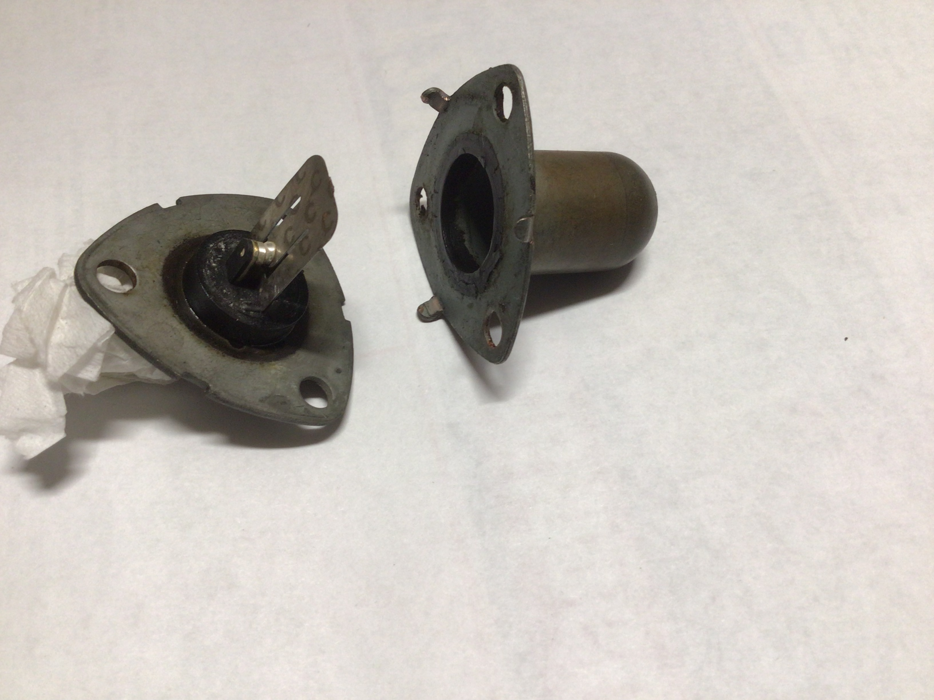

Hi. I have finally replaced otter switch and connected it correctly to aed. And have kept the on / off switch under the dash. My switch controls power to the aed and is actually redundant as long as otter switch work. Aed goes off after a short warmup time. ( As Jaguar designers intended ).
But if otter switch fails closed I can turn aed off. If it fails open I can’t turn it on. To have that option will require more switches. Or a 3 position switch on the otter side of the circuit.
Have also wired in a 3A fuse on feed to this switch. There is a warning light next to the switch, this is illuminated whenever switch is on, whether aed is powered or not. Thinking of rewiring this light so it illuminates only when aed actually is powered.
Afterwards I opened the old otter switch, and found out by bending the bimetal spring a little bit it can be adjusted to open at higher temperatur. But have not tested it in hot water yet, just by heating it with hot air. Needs more hot air to operate after my «adjustment».

My Otter switch closes off the AED too quickly in my opinion so I might have to do as you are doing and manually adjust the Otter switch so it closes at higher temp or buy a new Otter switch and see if that stays on longer.
Re: 1964 S type
The Otter switch is calibrated to cut out the AED at approx 35 deg C. They are fairly easily adjusted to a higher temp.
Re: 1964 S type
How is it adjusted Glyn the way Harald suggests by stripping it out and bending the bi metal tabs?
Re: 1964 S type
Yes. By opening it up & carefully bending the Invar spring/tab. Container, kettle & thermometer in container nearby. You need to measure it put back in its housing for accuracy. Obviously leave tabs open. You are not going to get it right first time. Get hot water to desired temperature in container. Hold together with needle nose pliers & dip 90%> of housing in hot water.
Don't use big fat pliers or grips or they conduct heat away from the housing & mess with your precision. Hold it in hot water for long enough for housing cover & it's ears to temperature normalise. I reckon you will get it adequately accurate & you always have a cut out switch for mild weather with your fancy set up.
