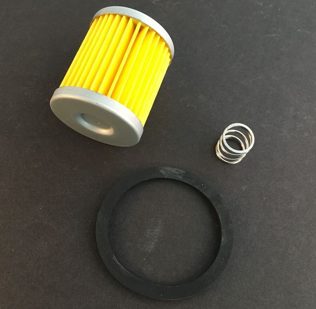

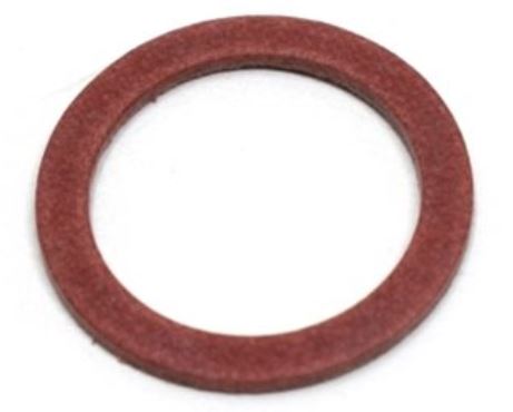

Looking for an engine compartment fire. Keep an extinguisher close by. I have actually seen those AC fuel filter housings both crack & corrode through. Remove the entire filter assembly & remove the top screen above the glass bowl, clean & examine carefully. If no fault is found replace fibre washers at the banjo joint & seals on the glass housing. The way you have that filter configured with a folded element in it dirt will collect on the inside of the element. New units are available if necessary.

New gaskets are cheap so change them all as old gaskets can become brittle or hard. Old gaskets can hold a good seal until you undo the joint and then try and seal it again with the old gasket so change them.
Make sure when you fit the gaskets that they are centred up correctly. If not you can pinch them and the will leak.
Don't over tighten any of the threads as most of them are in aluminum housings.

Glyn's second photo shows a paper filter element. From 1966 when I acquired my 3.8S there has never been a filter in this glass bowl. Never had any fuel system issues without one in all these years although once in a great while a small bit of sediment collects in the bottom of the bowl. Did all these AC fuel bowls always have a filter?
Re: Petrol leak
And just now checking the factory parts manual, it shows no filter. Must have been something added in later production?
Re: Petrol leak
You are correct: Brass screen was all that was fitted to cars up to 1968. Then followed the moulded resin insert known by Jag aficionados as the "burnt cake" filter in the glass bowl. The folded paper element was a newer introduction. Burnt cakes are hell to find these days. Most of us just use the paper filter. Helps with Viton tipped float bowl needle & seat contamination & float bowl overflow.

The original image in this thread appears to show a good example of the failure of the black seal between the glass bowl and the filter body. It looks like that seal has been seeping for some time.
I once renewed one of these in France on an XK140 /150 and I know from that experience that there are similar filters on various cars of very slightly different diameters.
In addition the actual filter body sealing area was very fine. Just be aware of having the correct seal on hand, the outer diameter of which must be a firm fit in the filter top. If that filter ring tends to drop down and out of the filter head the ring is too small.

Yes ~ that top seal looks shot & really gooey unless someone has put some sealant on it.
