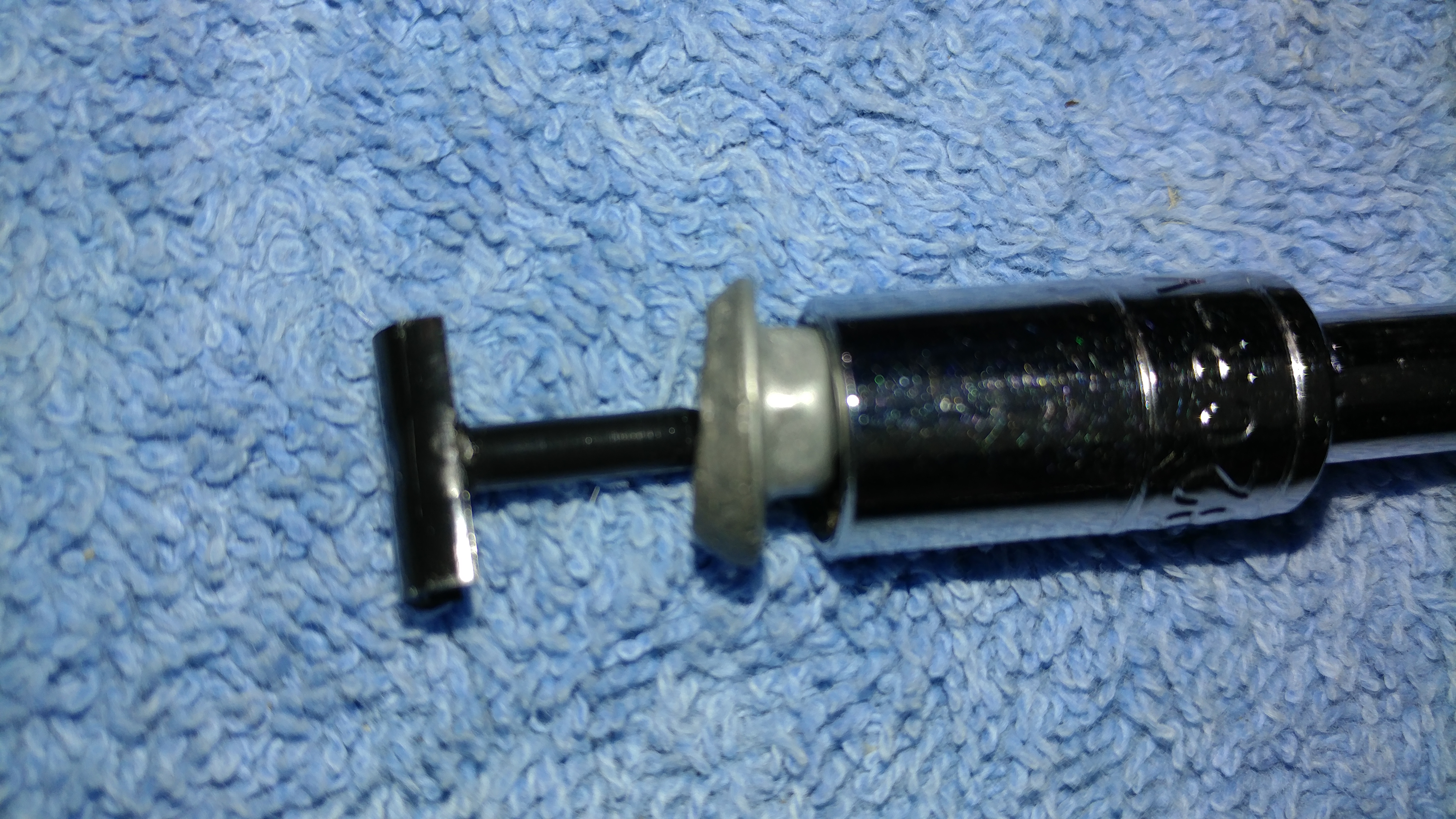

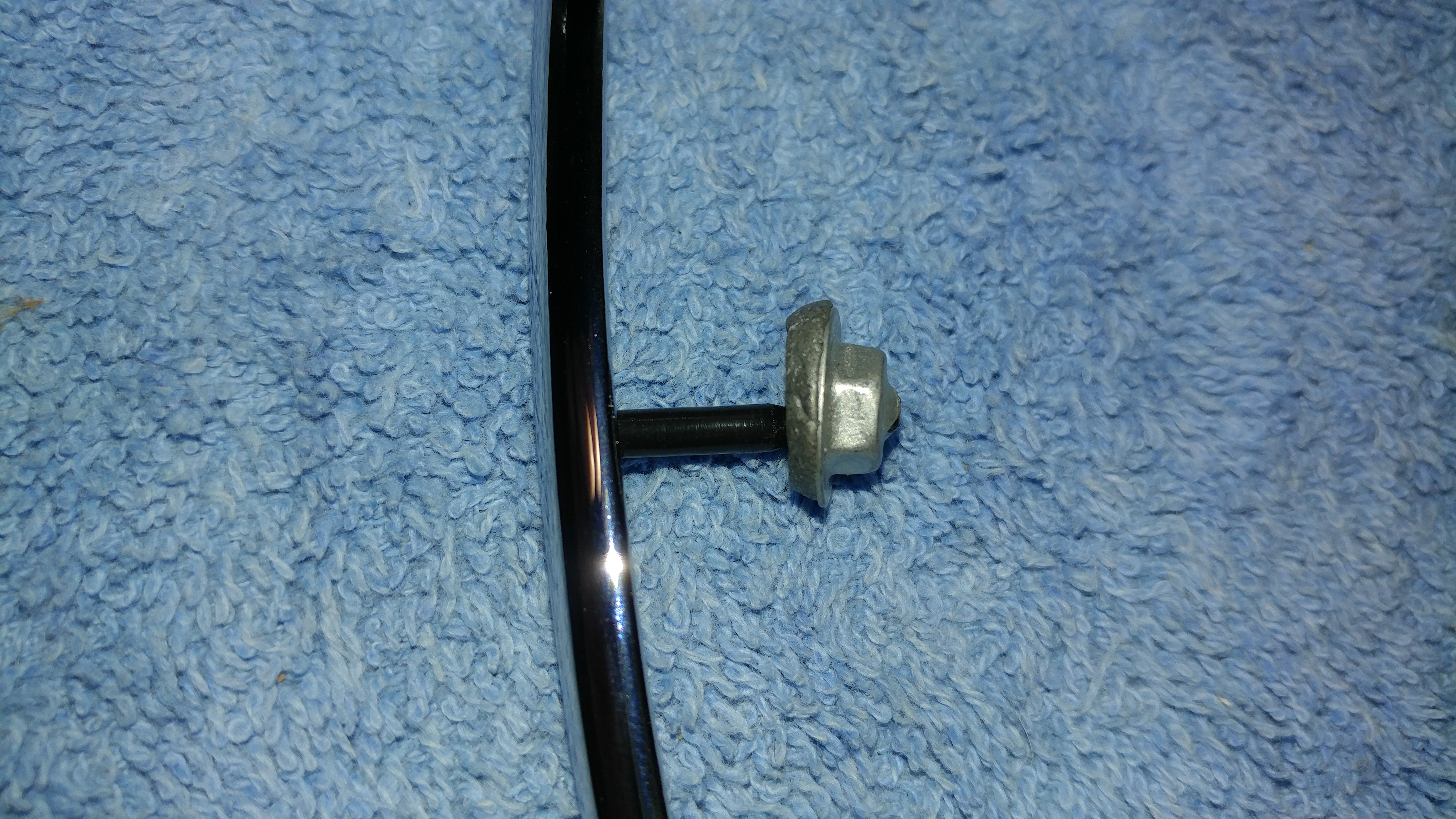

On either side of the license plate is a chrome strip. Attached is a photo of one of the strips with the fasteners in place. Is this how it is installed on my Jag? In this position, the plastic post will not go through the fastener. Did you make a small hole so the post will go into the fastener? I was planning to use a nut driver to hold the fastener in place while I push the post through the fastener. ???? Looking for help.

I think mine are held in place with a star washer which is pushed on to the rod from the inside of the trunk/boot. Similar to what you are trying to use but instead of a nut it is just a metal washer with a star shaped hole of the right size to push over the plastic peg/post. the points of the star lock onto the post and hold it in place.
Re: Refitting the chrome
Those type fasteners were used on my hub cap Jaguar badges. Thanks for the info.
Joe ~ the black plastic T piece & fastener you show is correct.
